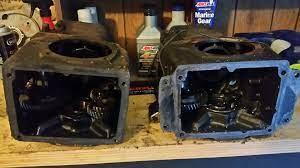

On 12/22/2021 at 3:47 PM, Jeff-C175 said:
I need to double check myself before I order an oil pan gasket.  I think I need the first one.  Can someone please confirm?  Thanks!
Depends on if you have a wide or narrow base block:
Don
Edited by Snoopy11
Jeff-C175
Important Information About the IH Cub Cadet Garden Tractor Oil Pan
Don
Oh, dats EZ to check!  Thank you sir!  may I have another?
Definitely NARROW BASE.
