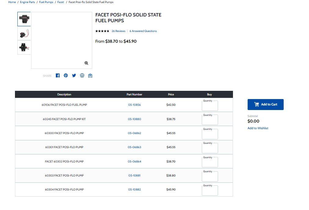

The Facet pump is like $75.  Then I have to engineer where I want to mount it, probably use some more fuel line, wire it up, etc, etc,
The diaphragm replacement takes like 20 minutes... done.  And the diaphragm costs like ten bucks.  If I don't smoke for a day, it's paid for!  I'd have to not smoke for ten days to pay for the Facet.
I've got nothing against using an electric pump, but rebuilding this one is the easier, faster, cheaper method.  Just sayin'

pfrederi
42 minutes ago, Jeff-C175 said:
I've got nothing BUT time Paul!  :ychain:
and if it fails it won't push gas into your crankcase....
