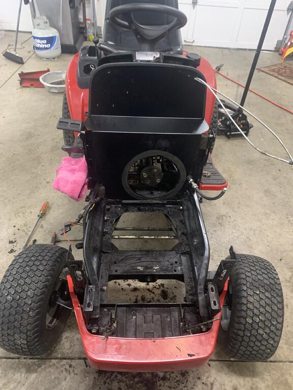

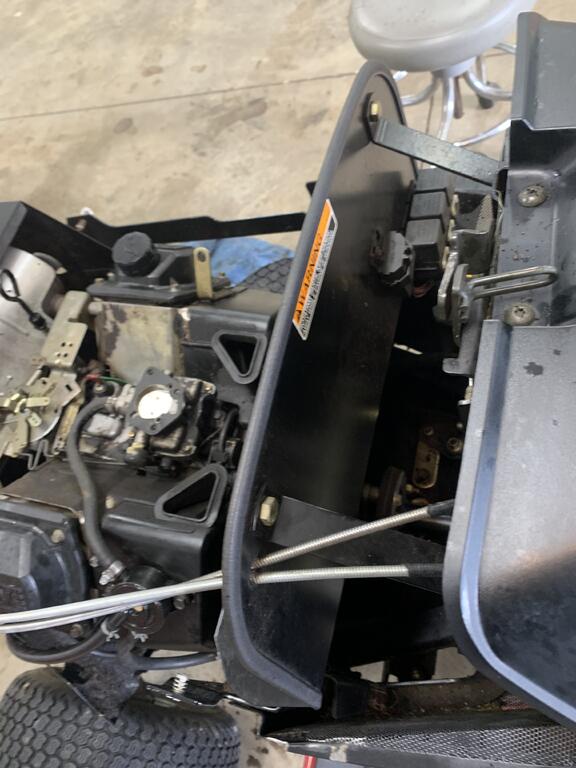

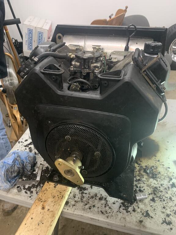

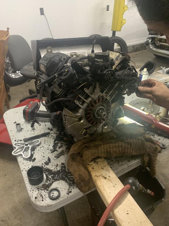

Tooomuch7 52 #14 Posted November 27, 2021 Got the engine out today. Thanks for all the great advice. 1 1 Share this post Link to post Share on other sites
Snoopy11 5,718 #15 Posted November 28, 2021 On 11/27/2021 at 3:47 PM, Tooomuch7 said: Got the engine out today. Thanks for all the great advice. Great job! Looks like you should be home-free! Don Share this post Link to post Share on other sites
