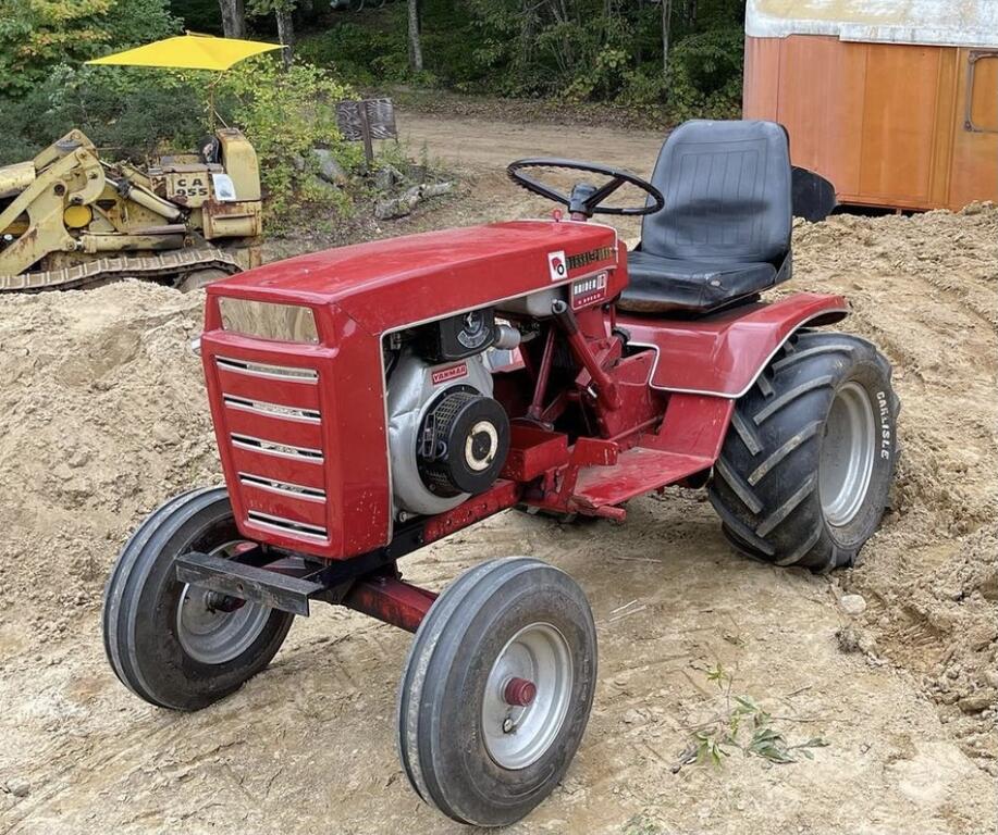

Brockport Bill 2,478 #1 Posted November 22, 2021 anyone have any thoughts or ideas about the potential of swapping a Diesel engine into a 1989, 520 HC to replace an Onan? If yes, what engine? New or used? Costs? obstacles? Fit? etc My grandson has an idea to do this but has not explored it yet? thanks 3 Share this post Link to post Share on other sites

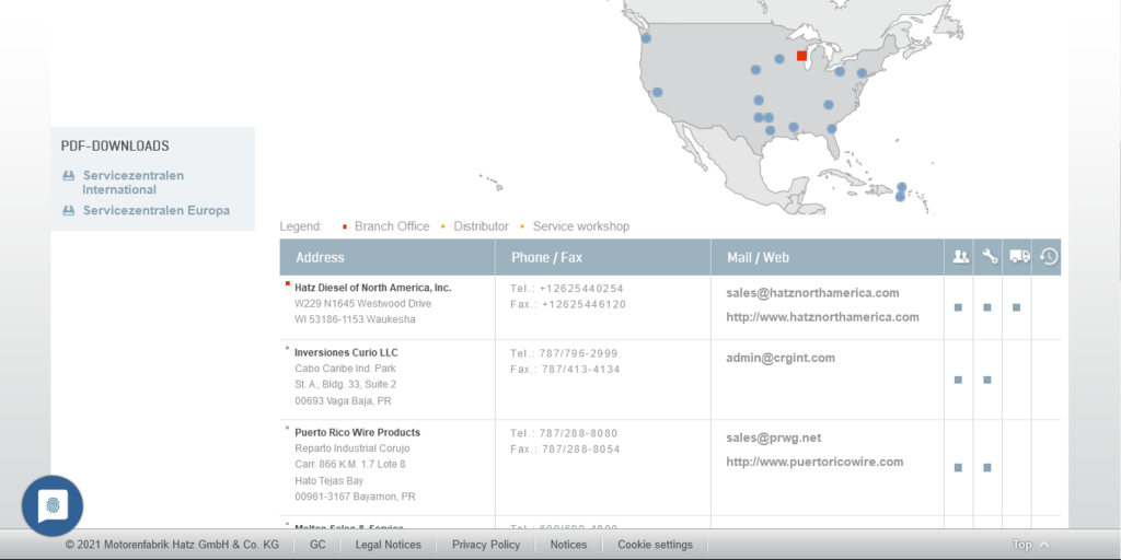

Brockport Bill 2,478 #5 Posted November 23, 2021 ive spent a half hour tring on Google whe 3 hours ago, Achto said: I shoe horned a 10hp 1B40 Hatz diesel into a short frame square hood. New price on the Hatz is ridiculous, I got mine at a work auction for a song. Had to raise the hood to fit it with out cutting a hole. No regrets though, more power than I can use and it takes about 10hrs to burn through 1.5gal of fuel. If you do some looking on line you can find some China built air cooled 10 to 12hp diesels for $400 to $1000. You might think that 10 to 12hp is not enough for a 20hp tractor but trust me when I say that I have yet to get my 10hp Hatz to pull on the governor. It just purrs along barely working no matter what I throw at it. Spent 30 minutes navigating google - sooo frustrating -- Where the heck to find the 1B 40 diesel to buy - the company makes it impossible - do they really want to sell these engines? how do you find a dealer? What is approx retail price? thanks 1 Share this post Link to post Share on other sites
Achto 32,794 #6 Posted November 23, 2021 34 minutes ago, Brockport Bill said: Where the heck to find the 1B 40 diesel to buy - the company makes it impossible - do they really want to sell these engines? how do you find a dealer? What is approx retail price? Just did some looking also with little luck. Northern Tool did carry Hatz engines but I do not see them on their site any more. Hatz are made in Germany, I'm wondering if they are being held back from the US because of the covid thing? Price range on Hatz engines was around $3000. 1 1 Share this post Link to post Share on other sites
Brockport Bill 2,478 #7 Posted November 23, 2021 1 hour ago, Achto said: Just did some looking also with little luck. Northern Tool did carry Hatz engines but I do not see them on their site any more. Hatz are made in Germany, I'm wondering if they are being held back from the US because of the covid thing? Price range on Hatz engines was around $3000. thanks - i was on northern tool site and not successful -- i have sent HATZ customer service an email request -- Bill 2 Share this post Link to post Share on other sites
1995 520H+96+97 939 #8 Posted November 23, 2021 https://www.hatz-diesel.com/en/services/salesservice-network/salesservice-network/?no_cache=1 3 Share this post Link to post Share on other sites

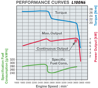

JoeM 10,307 #19 Posted November 23, 2021 (edited) The one thing, putting the smaller diesel on the hydro, will it be taking full advantage of the low end torque? The chinese one I used made max torque at 1500 RPM. The hydros I have like being spun up. Edited November 23, 2021 by JoeM 3 Share this post Link to post Share on other sites
JoeM 10,307 #20 Posted November 23, 2021 4 hours ago, Maxwell-8 said: But the hood will have to be lifted quite a bit. May channel the frame a bit too? 1 1 Share this post Link to post Share on other sites
Maxwell-8 4,371 #21 Posted November 23, 2021 36 minutes ago, Pullstart said: Found it! @John Voss did a terrific job! https://www.wheelhorseforum.com/topic/86623-520-8-3-cylinder-diesel-conversion-finished/?tab=comments#comment-868979 Thanks! those are 13hp watercooled 3cyl engines! run good and are very reliable 1 Share this post Link to post Share on other sites
Maxwell-8 4,371 #22 Posted November 23, 2021 30 minutes ago, JoeM said: The one thing, putting the smaller diesel on the hydro, will it be taking full advantage of the low end torque? The chinese one I used made max torque at 1500 RPM. The hydros I have like being spun up. Very good point, seems it has mainly been done on manuals, were you experience a great difference. This is the power curve for a real yanmar L100. Max torque @2400rpm 3 Share this post Link to post Share on other sites
