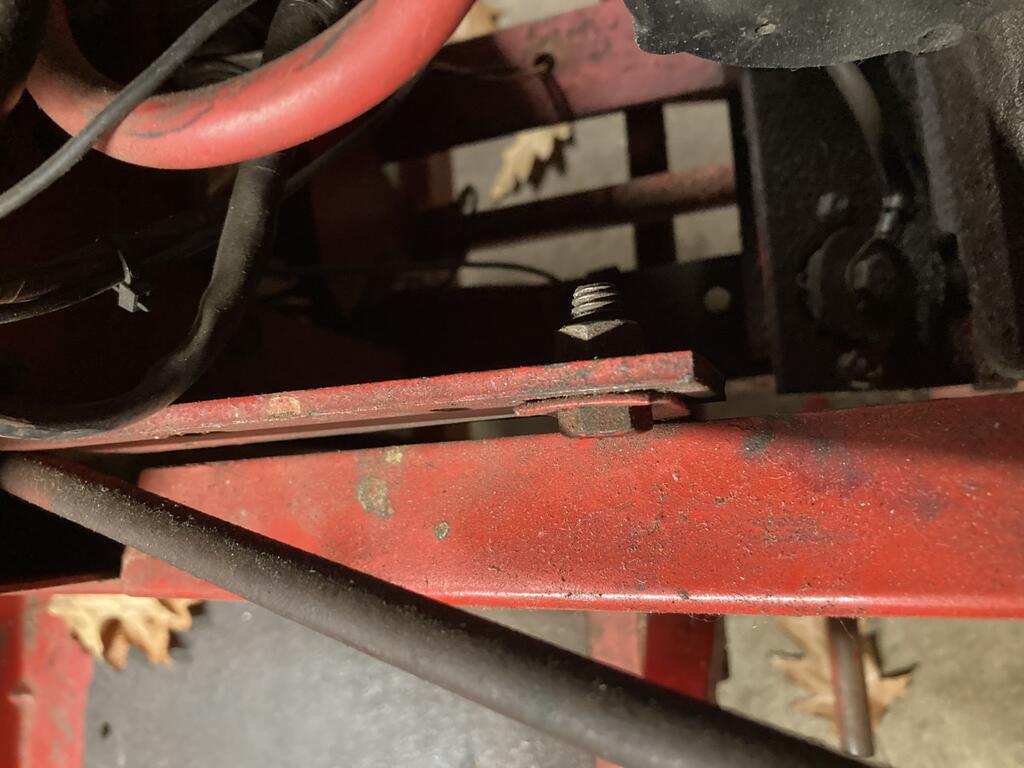

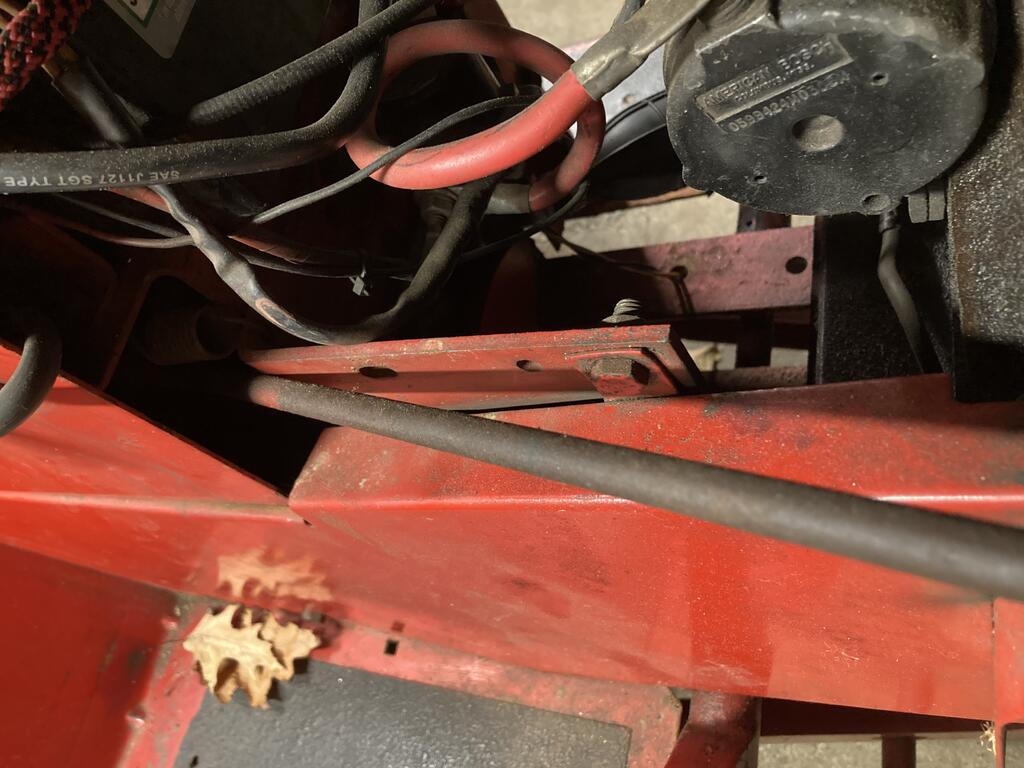

SylvanLakeWH 31,483 #2 Posted November 22, 2021 Here’s my C 105 if it helps… 1 Share this post Link to post Share on other sites

Jeff-C175 7,209 #4 Posted November 23, 2021 2 hours ago, SylvanLakeWH said: … I blew up the pics much as possible and it looks like a simple "L" bracket, is that correct? Share this post Link to post Share on other sites

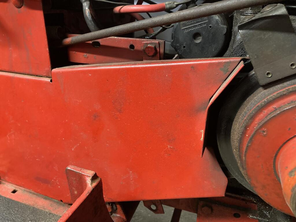

SylvanLakeWH 31,483 #5 Posted November 23, 2021 14 minutes ago, Jeff-C175 said: I blew up the pics much as possible and it looks like a simple "L" bracket, is that correct? Yes.mine is tack welded to the guard and bolts to a larger L bracket with several holes that bolts to frame below and behind the battery… took a couple closer pics… Share this post Link to post Share on other sites
Jeff-C175 7,209 #6 Posted November 23, 2021 3 hours ago, SylvanLakeWH said: took a couple closer pics Thank you very much! Exactly what I needed to see! I started restoring the guard to original. Got that pointy piece at the end pieced back in and started on the missing wedge. I would have just cut one piece but I didn't have any stock big enough. When I'm done it will look like one piece from the outside. I'll weld the L bracket in just as you've shown on yours. 3 Share this post Link to post Share on other sites
Jeff-C175 7,209 #7 Posted November 24, 2021 (edited) All done... this pic doesn't have the mounting tab on it yet, but that's done too. Got a coat of primer drying now. It's by no means perfect, but welding 0.060 sheet metal is not my forte! ( actually, welding ANYthing is not my forte, but I'm improving each time...) @Tach-a-matic Edited November 24, 2021 by Jeff-C175 2 Share this post Link to post Share on other sites
