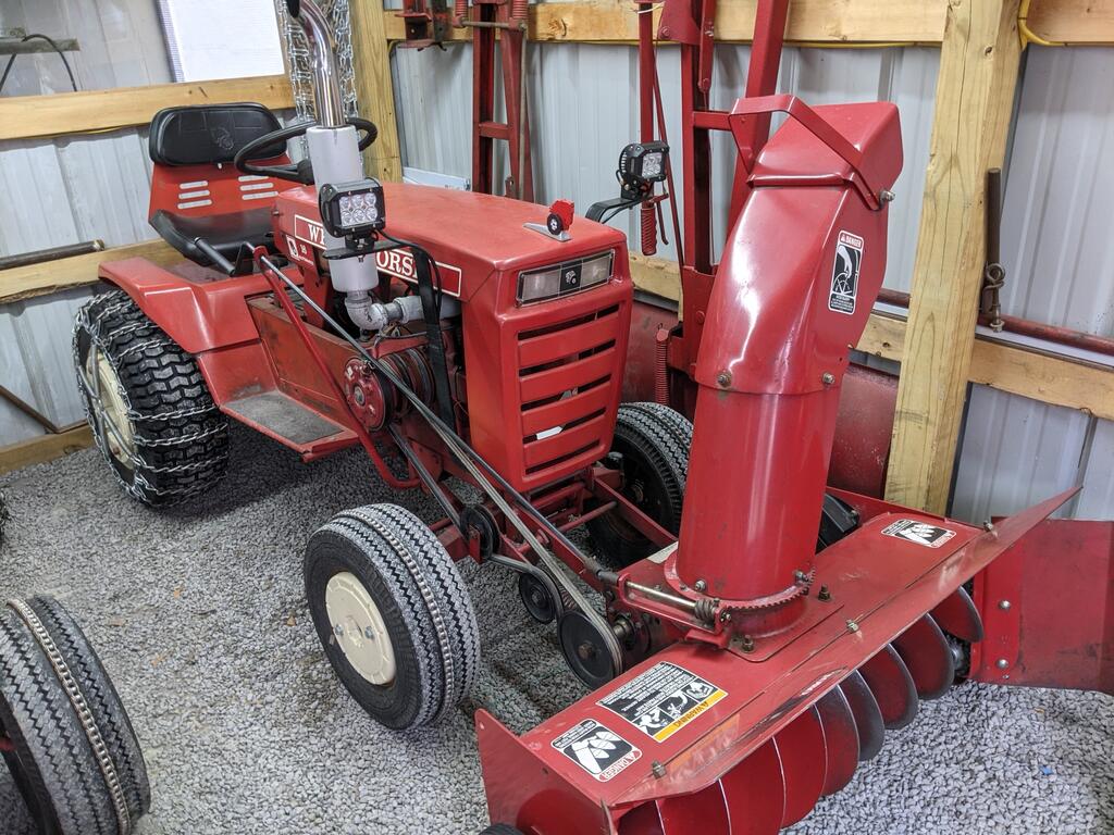

rjg854 13,378 #2 Posted November 21, 2021 These lights are similar to the ones you posted. I made a frame so I didn't have to drill holes in the hood. And they're spread out enough so that no matter which way the chute is, it doesn't block the light. And the lights are quite bright. 8 3 Share this post Link to post Share on other sites

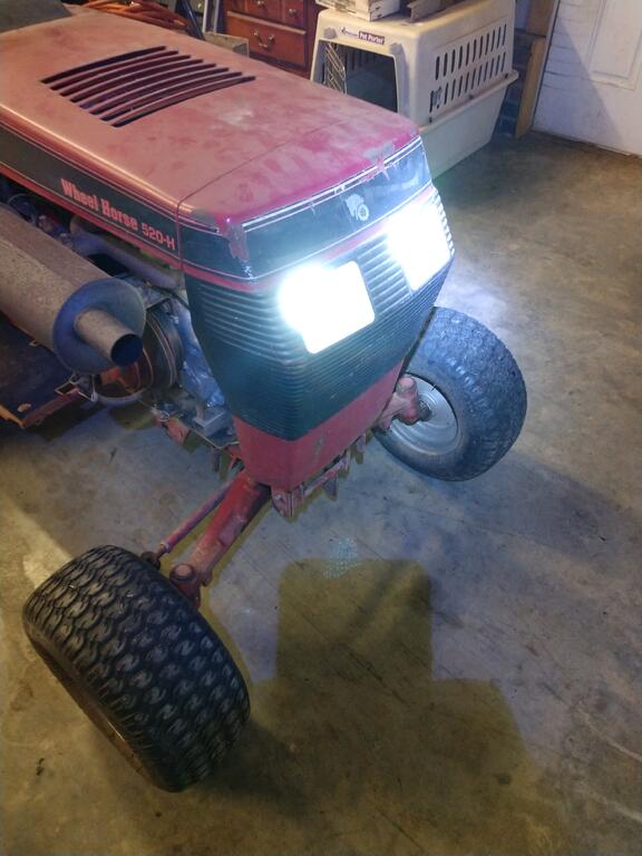

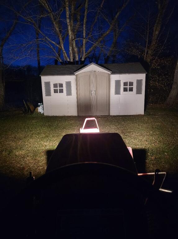

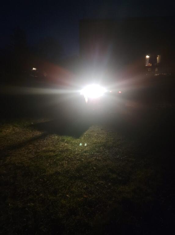

jonw440 226 #20 Posted November 29, 2021 (edited) The lights fit perfectly. The same size as OEM lights. These are the Vstar LED PAR36 9W,Replacement to 50W Halogen,850 Lumens,LED Light Bulbs,12V AC/DC Lamp Landscape Waterproof (Warm White) Edited November 29, 2021 by jonw440 Share this post Link to post Share on other sites
ebinmaine 80,765 #21 Posted November 29, 2021 35 minutes ago, jonw440 said: These are the Vstar LED PAR36 Niiiiice Share this post Link to post Share on other sites
Handy Don 17,489 #22 Posted November 29, 2021 Very. happy with those myself. The warm color temperature of the light works well for seeing vegetation as well as things like walls and pavement and isn't so glaring when used in snow. Share this post Link to post Share on other sites
