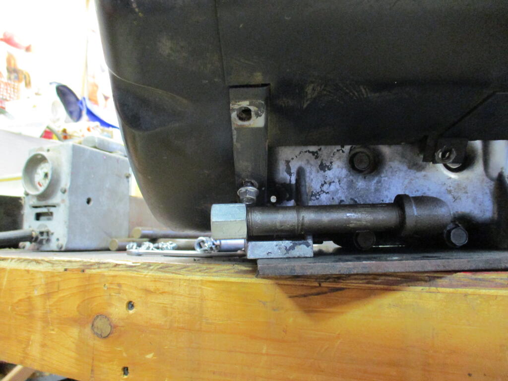

pfrederi 21,301 #1 Posted November 21, 2021 (edited) After rebuild you have to run the engine for awhile then re-torque the head bolts. OK not much issue with the singles.... but the K and Magnum twins. You have to take the engine off the tractor and remove 11 bolts to remove the rear tin so you can get to the head bolts. Except one of the bolts will not clear the oil drain cap.. so you have to drain the oil. All this to check the torque on head bolts... Then do it over again (but only 8 bolts) for the front cylinder... Design guys should have to work on stuff.... Edited November 21, 2021 by pfrederi 3 Share this post Link to post Share on other sites

pfrederi 21,301 #12 Posted November 21, 2021 I changed the nipple so that is no longer a problem...still blame Kohler for having to play with so many tin bolts many of which do not want to line up without a struggle... Share this post Link to post Share on other sites
