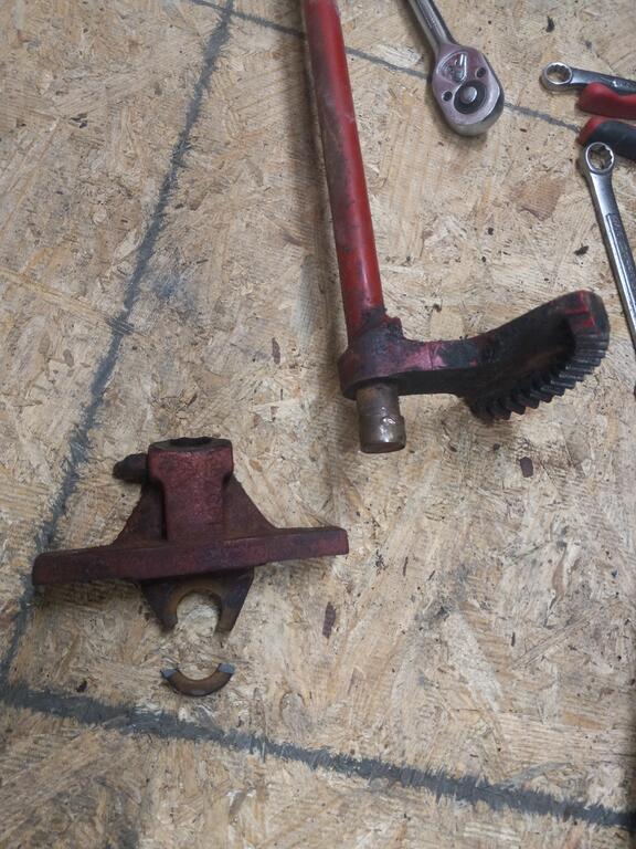

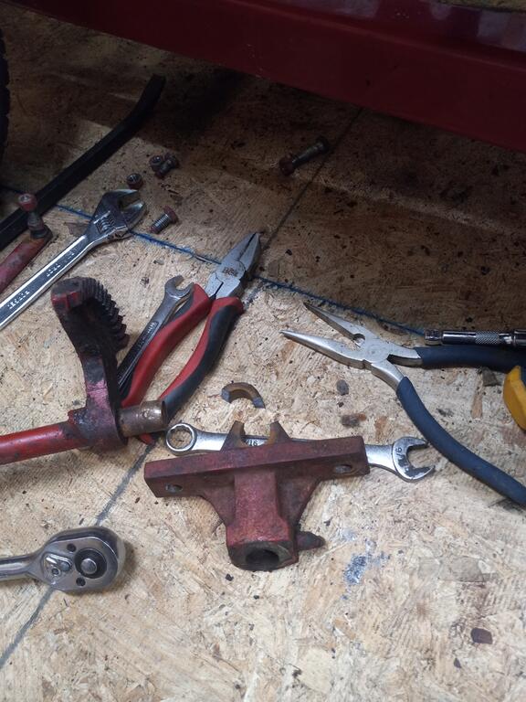

Cee245 861 #1 Posted November 20, 2021 (edited) Just replacing tie rods on my 417A and took apart steering to see about taking ALL play out of it. And then I broke it. It's my fault for not taking my time. Sad part is, I gave away a spare block (that I just broke) and the rod with the gear teeth on it. In the plus side, I have a new neighbor that has 2 wheelhorses! 310-8 and 314h. He's going to borrow my 2 stage this winter while I use my 416 single tall chute and this 417 with 48" plow. Maybe someone has a gear reduction set up I could install while I'm at it?! Can that be done? How hard? Edited November 20, 2021 by Cee245 2 Share this post Link to post Share on other sites
Maxwell-8 4,371 #2 Posted November 20, 2021 welding with cast iron welding rods? Share this post Link to post Share on other sites
Cee245 861 #3 Posted November 20, 2021 @Maxwell-8, no. I took it apart and had to pry it off while on tractor and it broke. it was a big pry bar.. I was looking at tightening the steering Share this post Link to post Share on other sites
Maxwell-8 4,371 #4 Posted November 20, 2021 2 minutes ago, Cee245 said: @Maxwell-8, no. I took it apart and had to pry it off while on tractor and it broke. it was a big pry bar.. I was looking at tightening the steering But welding could be a fix 1 Share this post Link to post Share on other sites
Handy Don 17,489 #5 Posted November 20, 2021 Reduction is new steering shaft, midd-gear, and block for sure. I think a different length front shaft with fan gear, too. I might have the regular block on a parts tractor. I'll look tomorrow. 1 1 Share this post Link to post Share on other sites
Cee245 861 #6 Posted November 20, 2021 Regular block would be easiest. Thanks! Share this post Link to post Share on other sites

Cee245 861 #8 Posted November 20, 2021 I see there is a little bushing on the end of the shaft. Wonder if those are available... Share this post Link to post Share on other sites
peter lena 10,076 #9 Posted November 20, 2021 @Cee245 if you have to weld that cast iron its most important to preheat it , that will make for a good weld , but think you should be able to find that block on this site or on line , good chassis grease in that , pete 2 Share this post Link to post Share on other sites
