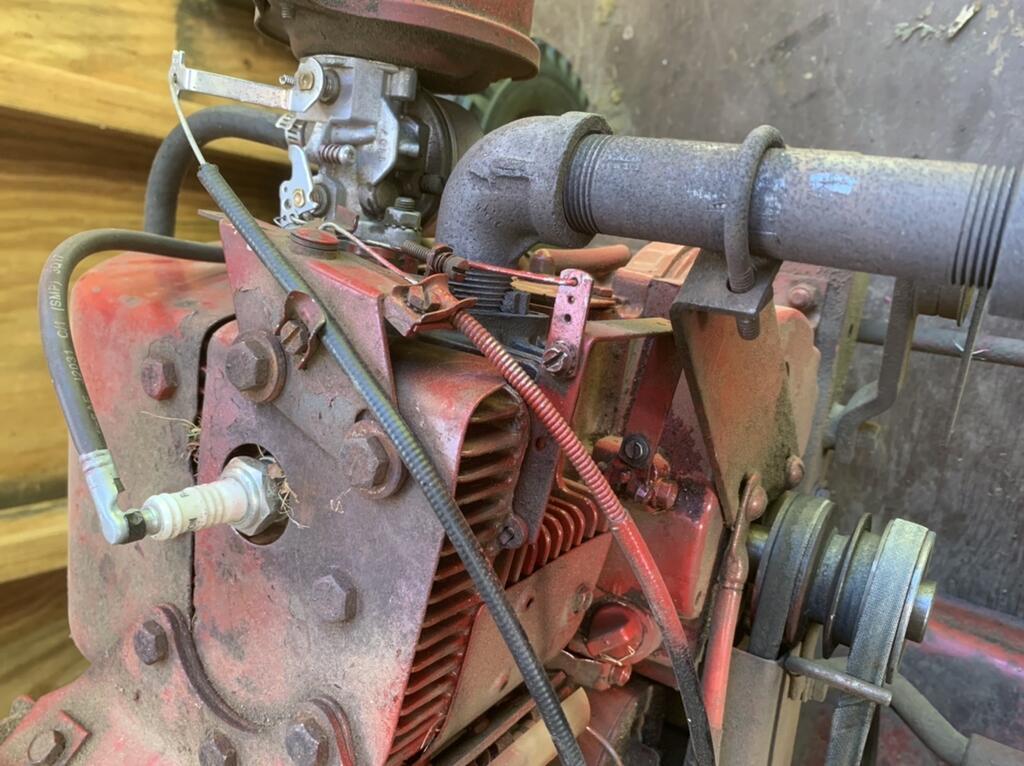

tspot100 2 #1 Posted November 18, 2021 my 66 REO SNO THRO tecumseh h60 governor is driving me nuts. the motor idles great but as soon as any amount of throttle is applied and the governor moves at all, the motor sputters and dies. compared it externally to my 72 wheel horse trailblazer 7 and it is identical. carb has been overhauled last year and ran well. put another known good carb on and same symptoms occur as soon as governor linkage moves at all. any other places to look before splitting the case and looking at the internals? exactly like this gov pic i found in the gallery.. not my motor. thanks in advance. Share this post Link to post Share on other sites

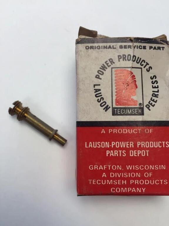

gwest_ca-(File Mod) 12,489 #6 Posted November 18, 2021 Is this a carb with a jet up from the bottom. If it is removed for cleaning it needs to be replaced because the jet holes will not line up. A replacement jet has a groove machined around the jet in the orfice location so the fuel can get through. Have never seen one but will guess a file could add a groove in the original jet. Why this happens is when made the hole in the jet is drilled after the jet is installed. Now you have no way of lining up the holes. 1 Share this post Link to post Share on other sites
tspot100 2 #7 Posted November 18, 2021 yes..jet up from the bottom. wasnt aware of this...hmmm. may have to get a jet and another rebuild kit. its a lmb labeled carb. questioning now if this is the original carb... good thing i enjoy working on these small engines.. thank you Share this post Link to post Share on other sites
Handy Don 17,490 #8 Posted November 18, 2021 3 minutes ago, gwest_ca said: Is this a carb with a jet up from the bottom. If it is removed for cleaning it needs to be replaced because the jet holes will not line up. A replacement jet has a groove machined around the jet in the orfice location so the fuel can get through. Have never seen one but will guess a file could add a groove in the original jet. Why this happens is when made the hole in the jet is drilled after the jet is installed. Now you have no way of lining up the holes. You may be onto something here, @gwest_ca. @tspot100 Does the "known good" carb run correctly on a different engine (which to me is the only way to confirm "known good")? Did you try turning the throttle plate by hand to see if it'll go to higher revs? If it simply won't run at full speed, then it sure does, to me, sound like it is not getting fuel/air when it wants it. So it's either the carb or the intake valve. I use this for trouble shooting my Tecumseh carbs: Tecumseh Carburetor Identification & Troubleshooting SM.pdf And this one for everything else: Techumseh Technician's Handbook.pdf Share this post Link to post Share on other sites
gwest_ca-(File Mod) 12,489 #9 Posted November 18, 2021 Looked for a picture of one and found this. I am just going by what I have read. 1 Share this post Link to post Share on other sites

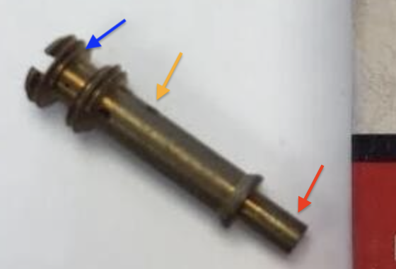

Handy Don 17,490 #10 Posted November 18, 2021 (edited) This is only relevant for a carb with a replaceable jet. Not all Tech carbs had replaceable jets. The blue arrow is the end toward the bowl. The hole at the orange arrow is where fuel enters the jet after coming in through the hole in the side of the carb main jet barrel (see below). The red arrow is the nozzle sticking up into the venturi that disperses the fuel into the airstream. The green arrow points to the main jet "barrel". The fuel inlet is a tiny hole drilled into the side of the barrel high enough from the bottom that is above both sets of theads on the main jet. (A non-removable jet has the same construct but there is no "slot" for a screwdriver at the blue-arrow end to remove it.) Edited November 18, 2021 by Handy Don Share this post Link to post Share on other sites
