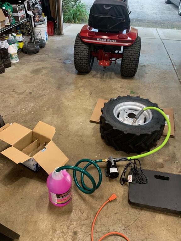

squonk 44,859 #6 Posted November 16, 2021 (edited) Better find a teen ager to hold that drill for a few hours! This pump, 12 volt or 120 volt model, 2 washing machine hoses and a tire fill adapter. Edited November 16, 2021 by squonk 1 1 Share this post Link to post Share on other sites

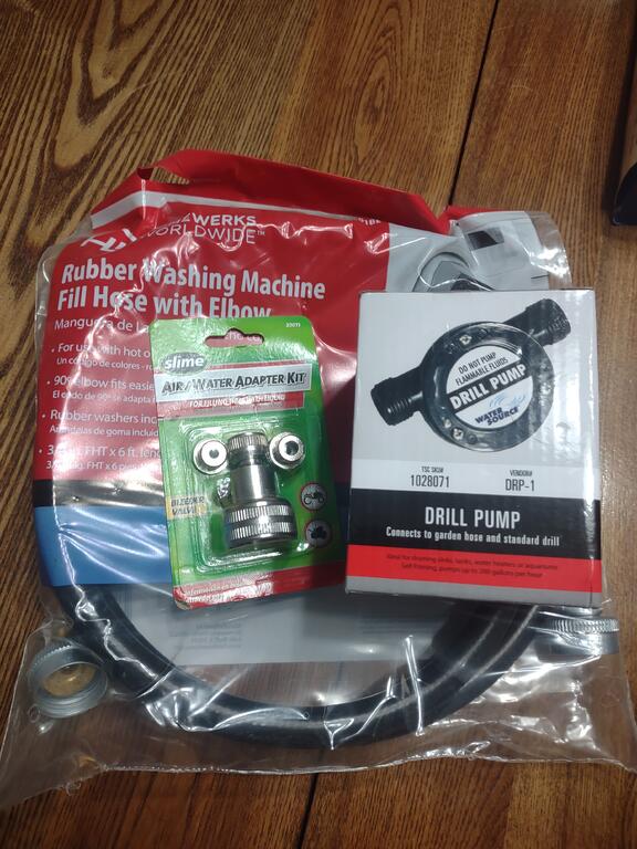

Andy N. 2,600 #22 Posted November 20, 2021 Here's my setup for fluid filling. https://www.amazon.com/dp/B06XC615GC?psc=1&ref=ppx_pop_dt_b_product_details https://www.amazon.com/gp/product/B003V9T6YI/ref=ppx_yo_dt_b_asin_title_o08_s00?ie=UTF8&psc=1 4 Share this post Link to post Share on other sites
squonk 44,859 #24 Posted November 21, 2021 Yup looks familiar! 1 hour ago, ebinmaine said: BBT is gonna hold the drill! Eric is gonna film it! 1 2 Share this post Link to post Share on other sites
ebinmaine 75,705 #25 Posted November 21, 2021 15 minutes ago, squonk said: BBT is gonna hold the drill! Eric is gonna film it! That's what I'm hoping for 😜 Share this post Link to post Share on other sites
