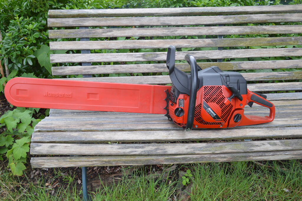

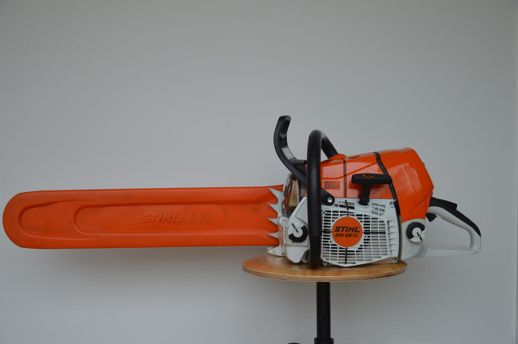

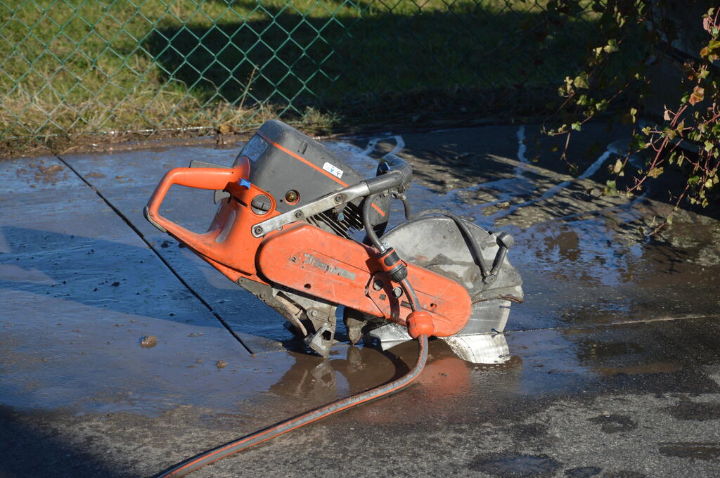

Maxwell-8 4,371 #9 Posted November 15, 2021 I have a ton of chainsaws, new and old I use 40:1 on all. It is very important you use a high quality oil! If you use a cheaper oil, you need to use more of it. running a bit more oil won't harm it, to little sure will. My ms880, I sold to buy my first horse. So I did with my Jonsered 2188 (Husqvarna 390) My current MS661 Also in my concretesaw which has to be floored for sometimes a full tank of gass, while under high load 4 1 Share this post Link to post Share on other sites

Maxwell-8 4,371 #12 Posted November 15, 2021 1 hour ago, Snoopy11 said: So... backpack blowers don't run 10,000 rpm... whereas, chainsaws hit 10 grand and more. This is where it needs more oil. If you run under 10 grand, you could use less oil. However, where more oil is necessary is when those rpms go over 10,000. Don't now which Jonsered, but one is the highest revving chainsaw ever produced, close to 16.000rpm !!!! 2 Share this post Link to post Share on other sites
Snoopy11 5,731 #13 Posted November 15, 2021 8 minutes ago, Maxwell-8 said: Don't now which Jonsered, but one is the highest revving chainsaw ever produced, close to 16.000rpm !!!! Probably runs 25:1 oil ratio... I've got one that is 60cc... BRUTICUS!!! Don Share this post Link to post Share on other sites

Maxwell-8 4,371 #21 Posted November 15, 2021 40 minutes ago, Snoopy11 said: Probably runs 25:1 oil ratio... no, I believe 50:1 but states to use 25:1 if you don't use their oil. So they mean the cheap oil. 1 Share this post Link to post Share on other sites
