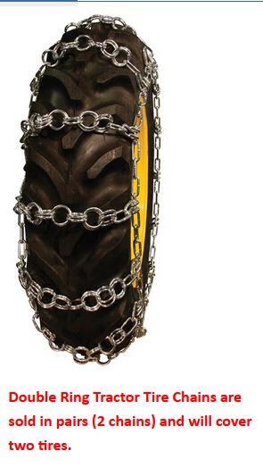

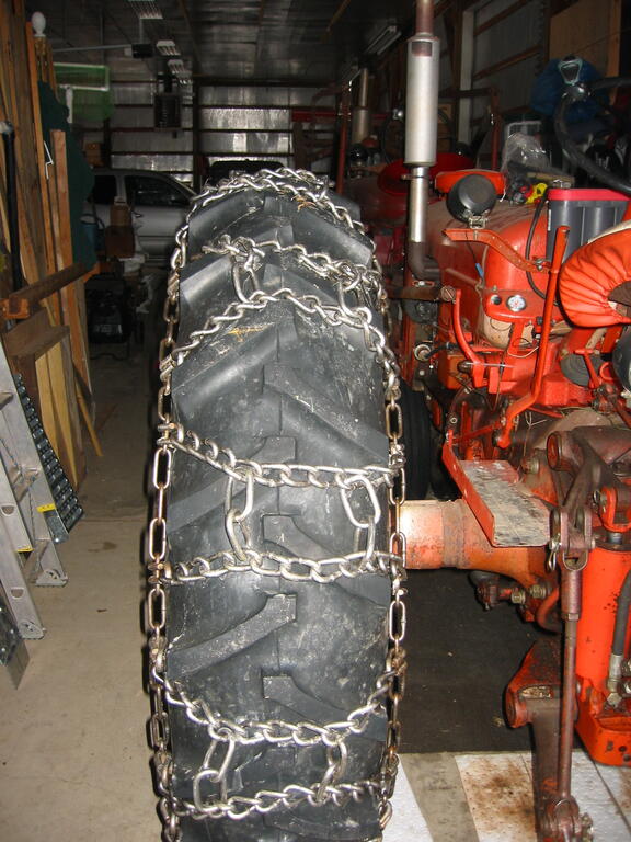

pfrederi 21,145 #15 Posted November 12, 2021 If you go with chains regular chains will fall into the tread between the bars and not do you much good. You will need Double ring Chains (Pic 1 ) or duo link pic 2 Share this post Link to post Share on other sites
ebinmaine 80,642 #16 Posted November 12, 2021 37 minutes ago, pfrederi said: regular chains will fall into the tread between the bars I'd agree with that. I have 2 link heavy duty ice chains on my V bar tires. They do have some effect but obviously not as much because some of the links are in between the bars. Also, they can be quite challenging to install for the first time every year because they just do not want to line up. Share this post Link to post Share on other sites
