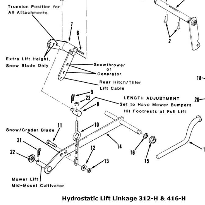

gwest_ca-(File Mod) 12,489 #3 Posted November 11, 2021 Share this post Link to post Share on other sites

953 nut 69,555 #11 Posted November 13, 2021 9 hours ago, Rucan said: I have electric lift. Take a look at the wiring drawing Garry @gwest_ca provided. Check all of those electrical connections to be sure they are tight and free of corrosion. Is your hour meter working? the relay for the lift uses the same power source as the hour meter. With the ignition off can you hear the relay close when the key is moved to the run position? Hope this helps. Share this post Link to post Share on other sites
