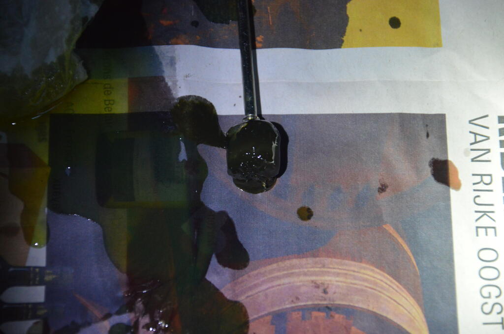

Maxwell-8 4,371 #55 Posted November 13, 2021 Good to see you also added the magnetic drain plug. I tend to always have tranny problems and so I have to open them. But the metal flakes I always find... People don't know how to shift strait cut gears. Worked on this Bolens today, metal flakes everywere. eventhough the oil was just replaced! This was just from sticking this magnet deep in the tranny when their was still oil in it. 1 Share this post Link to post Share on other sites

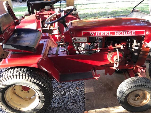

Sailman 1,306 #57 Posted November 20, 2021 (edited) Suggestions for the cosmetics...Just got an original paint, stored inside, C-160. Lots of elbow grease and 3M rubbing compound followed by Flynns Cherry Wet wax. Amazed at how well the paint still looks! Not perfect but darn nice for an almost 50 year old tractor. Will be posting pictures tomorrow. Edited November 20, 2021 by Sailman add pictures 7 Share this post Link to post Share on other sites
