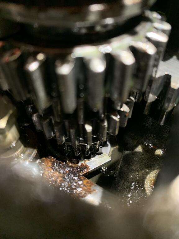

BBrad57 4 #1 Posted November 8, 2021 My hi low shifter fork has came off the hi low gear in my transaxle has this happend before to anyone else? It’s happened to me a few times and any idea how I get it back in thanks! Share this post Link to post Share on other sites
WHX?? 57,804 #2 Posted November 8, 2021 (edited) Is the shifter fork damaged? You'll have to remove the other gears to get it back in. @stevasaurus Edited November 8, 2021 by WHX?? 1 Share this post Link to post Share on other sites
stevasaurus 23,802 #3 Posted November 8, 2021 Welcome to Red Square. The first thing I want to ask...how did you fix it before?? What trans do you have or what horse?? Basically, you have to open it up and fix it...pictures and some back ground will help. Share this post Link to post Share on other sites
BBrad57 4 #4 Posted November 8, 2021 The shift fork is fine it just popped out of the seat on the gear Share this post Link to post Share on other sites
Achto 32,347 #5 Posted November 8, 2021 I would disassemble the tranny and closely inspect the gears and the fork. I believe that some thing has to be worn or maybe bent. I once installed a 3rd gear that I thought was fine but... the tranny would constantly pop out of 3rd as soon as you put load on it. It was worn just enough to cause an issue. 1 Share this post Link to post Share on other sites
AMC RULES 37,259 #6 Posted November 8, 2021 Can we see a pict of the tractor you're working on here Bill? Share this post Link to post Share on other sites
squonk 47,887 #7 Posted November 8, 2021 Wondering if the fork is twisted on the pin so it isn't in the year groove square. Share this post Link to post Share on other sites
Bens vintage tractors 1,556 #9 Posted November 9, 2021 33 minutes ago, AMC RULES said: Can we see a pict of the tractor you're working on here Bill? It’s not the one with 30s lol Share this post Link to post Share on other sites
WHX?? 57,804 #10 Posted November 9, 2021 2 hours ago, stevasaurus said: Welcome to Red Square. The first thing I want to ask...how did you fix it before?? Was wondering the same thing Dino. I just don't see how it can come out unless that detent bolt is broken or a fork broke off and even then??? It's been awhile since I been in one so might be a little rusty. 1 Share this post Link to post Share on other sites
