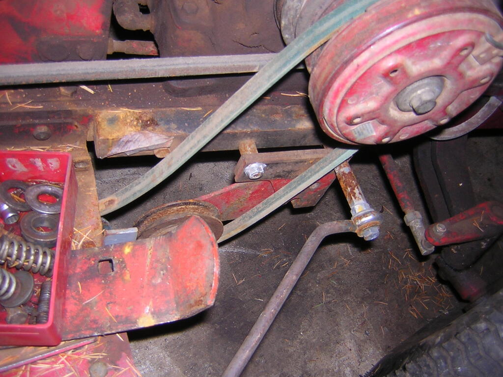

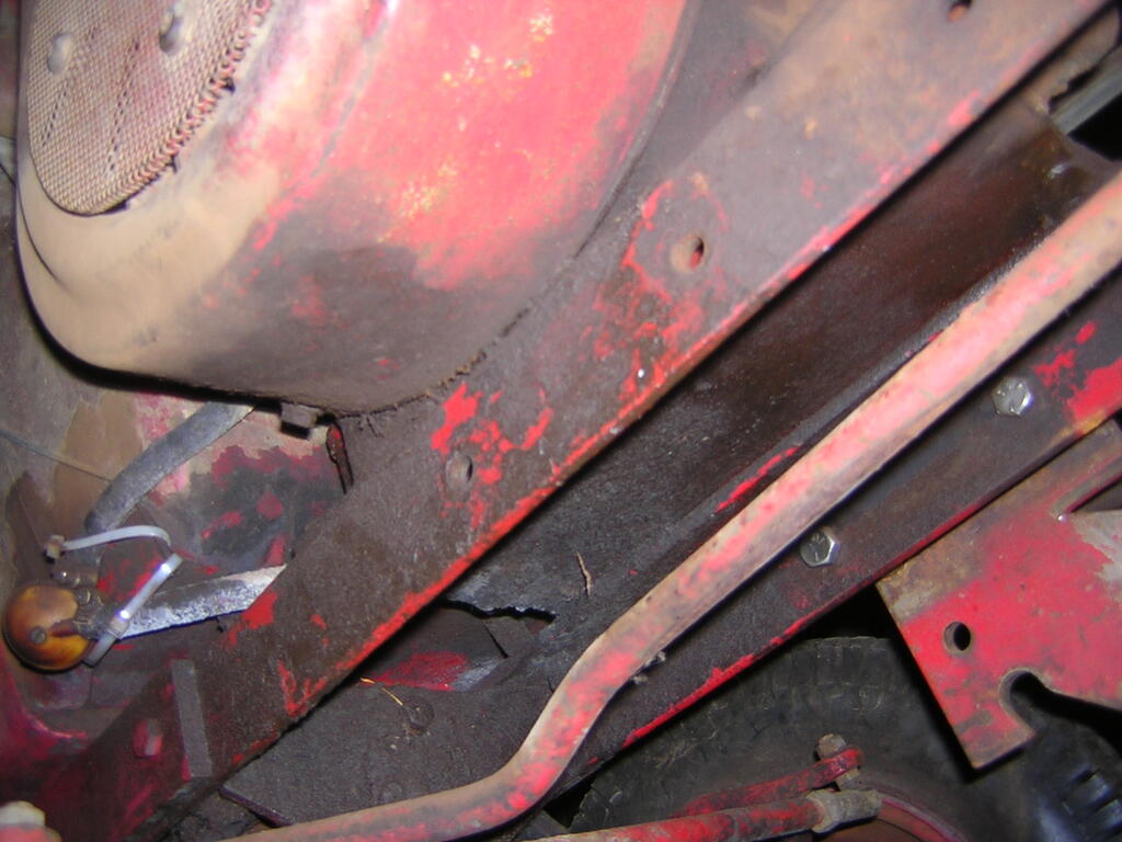

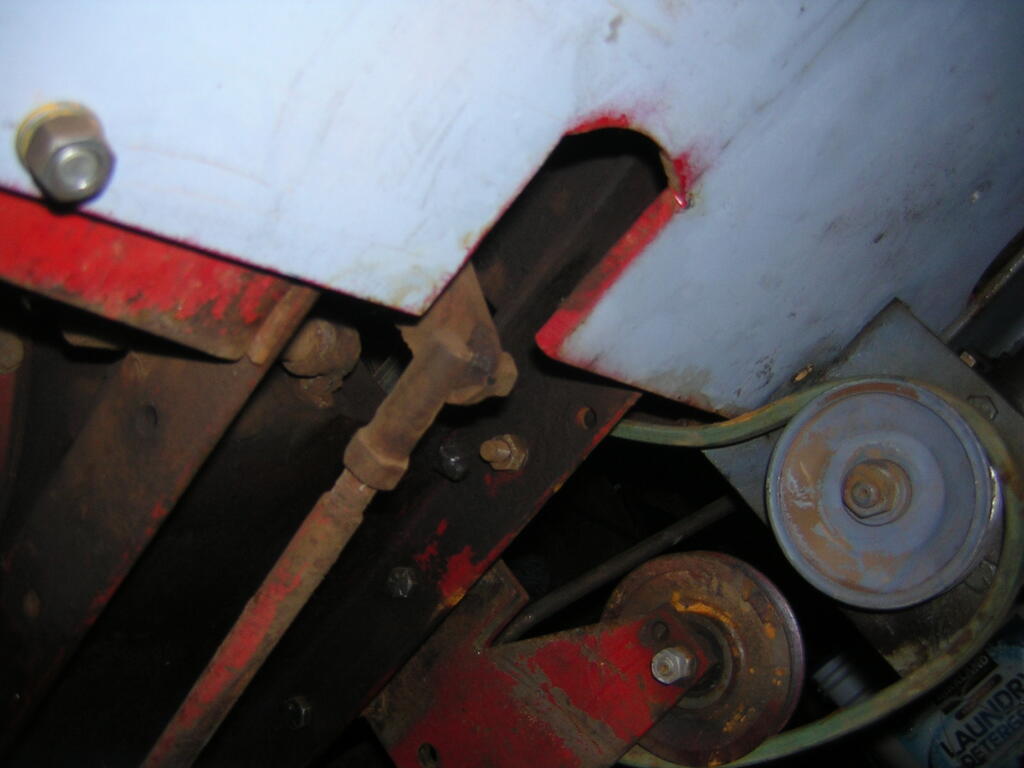

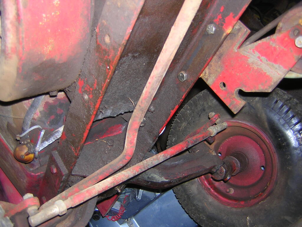

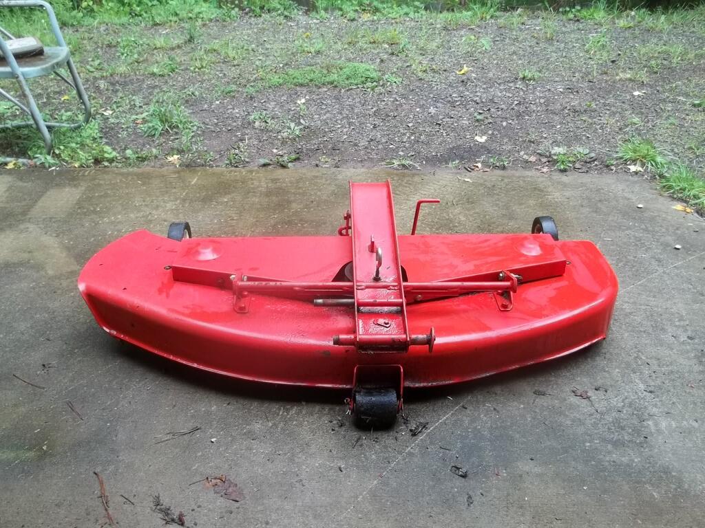

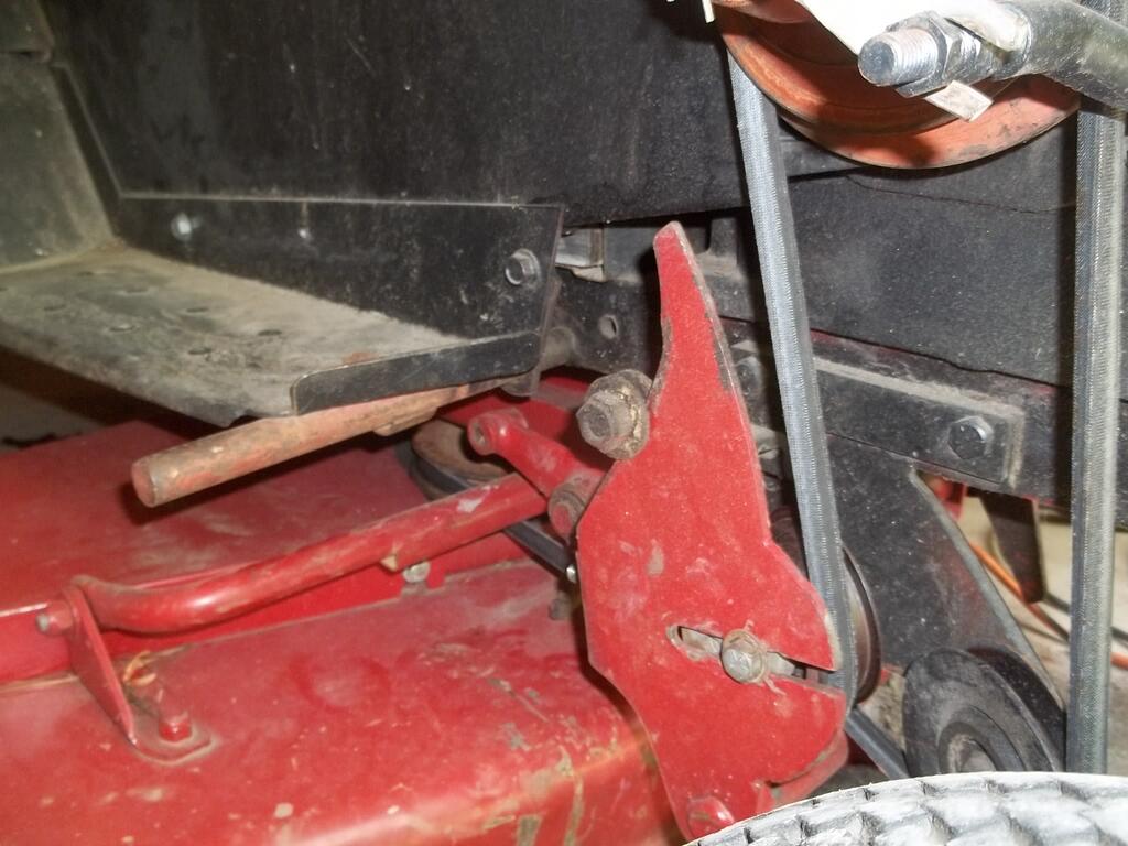

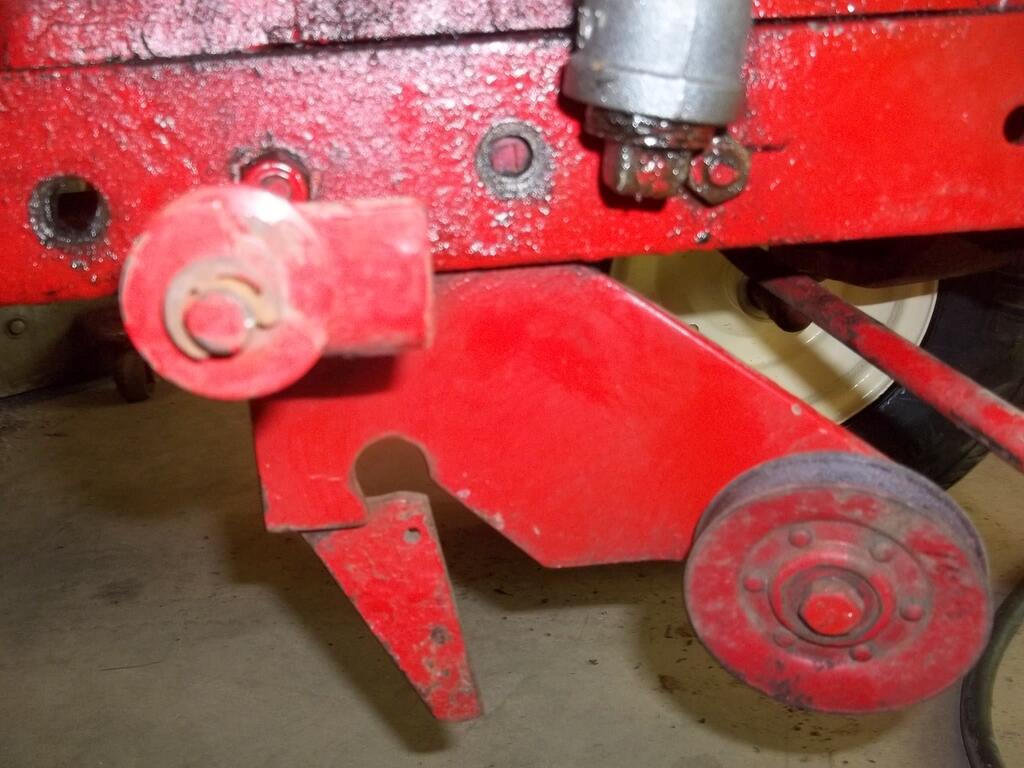

953 nut 69,148 #32 Posted November 12, 2021 20 hours ago, fullchoke said: I'm going to try to figure out what the mower deck should look look like, and how it is attached. Your mower deck should have this type of attachment on top. An attachment like this on your frame. And it will look like this when mounted 1 Share this post Link to post Share on other sites

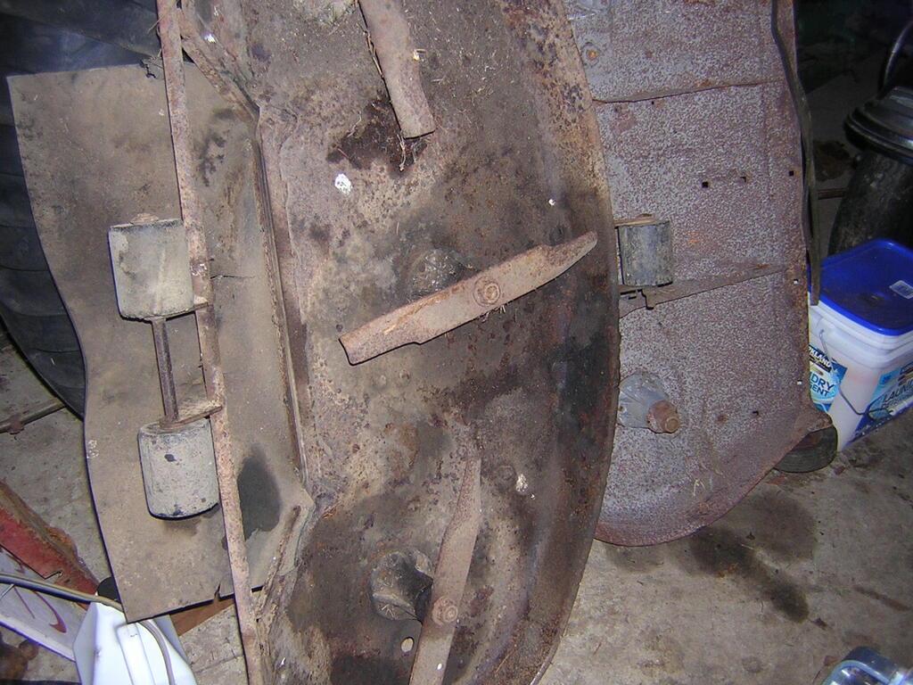

fullchoke 22 #34 Posted November 13, 2021 Thanks 953. I see many pieces missing for the mower deck too. Basically the parts that mount the mower deck that are on the tractor, and the bracket with the pulleys that send the power to the mower deck. It looks like he removed the mower deck, belt and attaching parts and put that with the decks. Then moved the tractor to where he was doing the sickle bar mod, and removed everything that was bolted to the tractor for the mower deck, and that went somewhere else. I'm sure it was all there, but the scrapper came through before the sale, so it's all gone now. I have determined about when it was last used because the Napa filter for the hydraulics has 2018, and 822 hours written on it. The hour meter now has 826 hours. 2 Share this post Link to post Share on other sites
953 nut 69,148 #35 Posted November 13, 2021 (edited) 12 hours ago, fullchoke said: I see many pieces missing for the mower deck too. Basically the parts that mount the mower deck that are on the tractor, and the bracket with the pulleys that send the power to the mower deck. It looks like he removed the mower deck, belt and attaching parts The parts you need are not just for the GT-14, they were used from '67 to 1972 on all long frame @Ed Kennell has probably got he parts you need, he saves all these parts to help get other's back on the turf. If he can't help then an ad in our classified section should do the trick. https://www.wheelhorseforum.com/classifieds/wanted/ Edited November 13, 2021 by 953 nut Share this post Link to post Share on other sites
Ed Kennell 47,266 #36 Posted November 13, 2021 to the Full choke. Like Richard mentioned above, I probably have the deck drive parts you need. If you are interested, please send me a PM. 1 Share this post Link to post Share on other sites

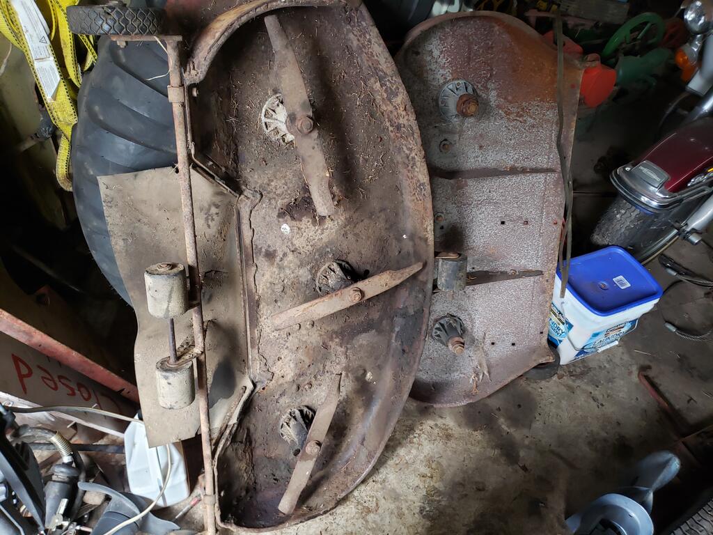

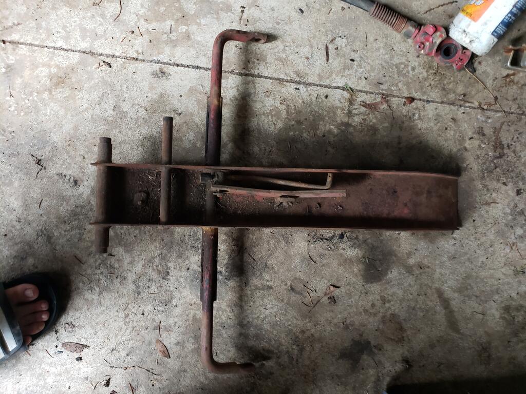

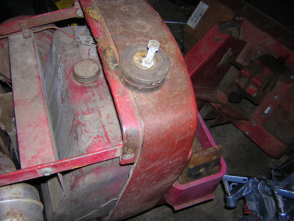

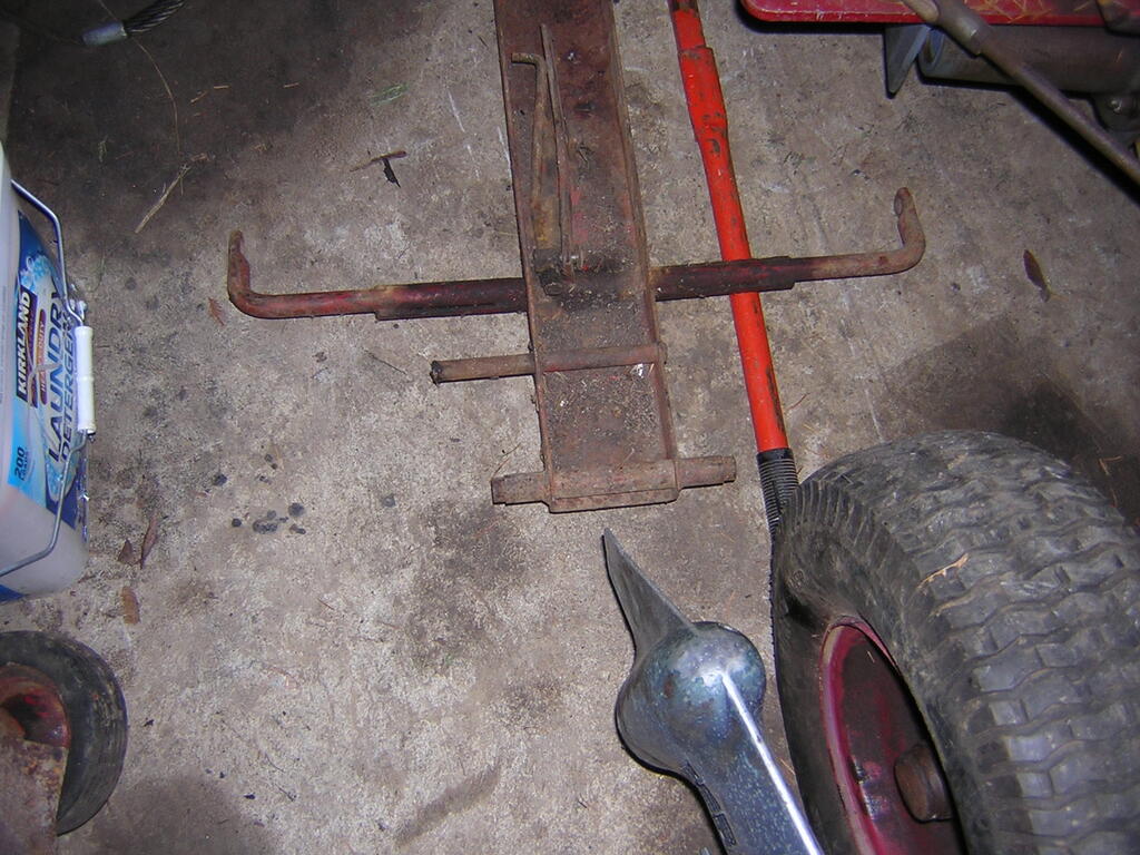

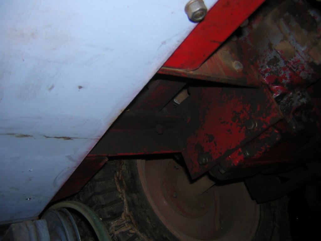

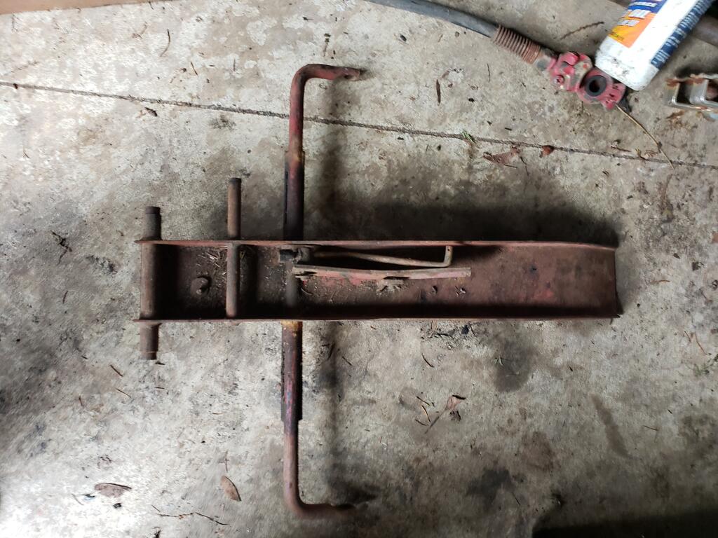

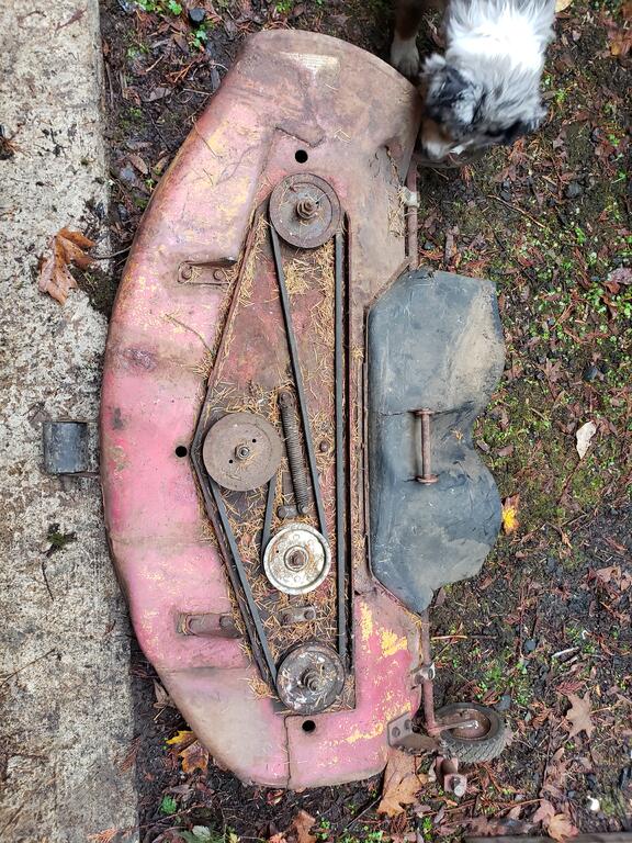

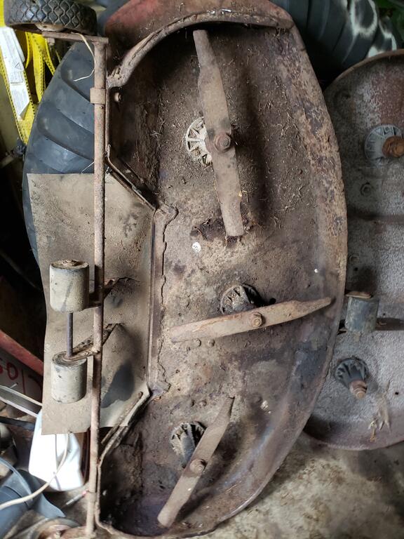

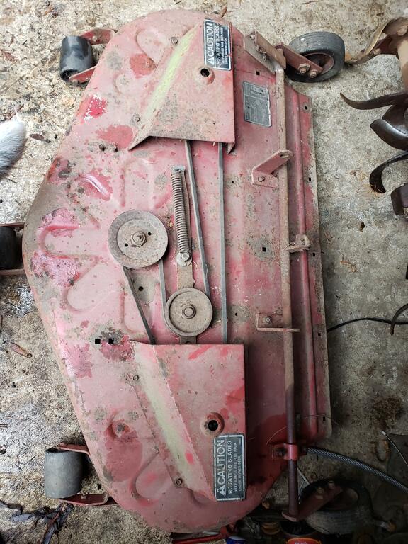

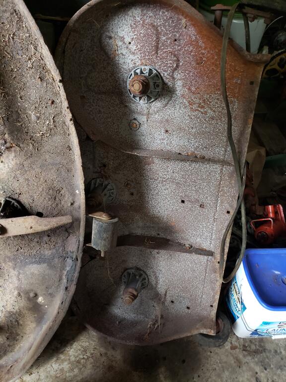

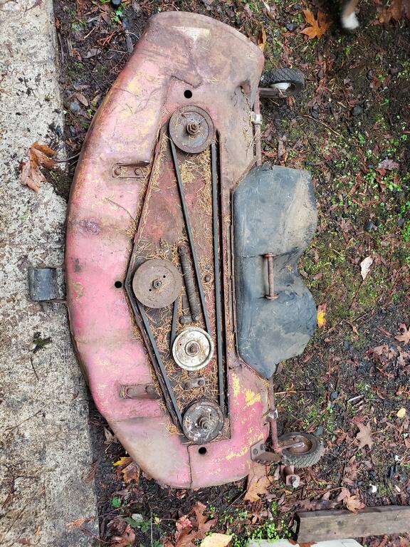

fullchoke 22 #40 Posted November 14, 2021 More pictures of the mower decks etc. That one picture is just one of a loose tensioner pulley that I didn't know where it goes. I have some more on my sons phone. I'll get those up to. 1 Share this post Link to post Share on other sites

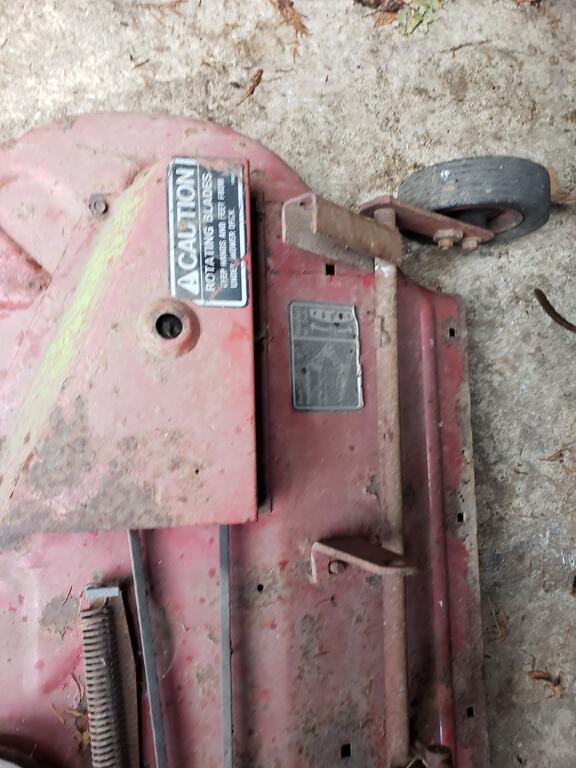

fullchoke 22 #46 Posted November 14, 2021 Sorry some of the pictures are duplicates. The mower deck with the rubber on it is the one with the blades in it. It is highly modified, and has been repaired. The other one, has no blades, but could be the nicest one to use if the mounting parts and blades can be found. Thanks Share this post Link to post Share on other sites
Ed Kennell 47,266 #47 Posted November 14, 2021 A couple comments after studying the pictures. I would check the electric PTO cluch early in the redo. If it is not working, they are expensive to replace if you can even find one. Many owners replace them with a manual system. I am not familiar with the GT series to know if these changes are possible, but since you do not have a PTO/ deck drive system, you may also want to consider adding a front attach-a-matic and a front mule drive instead of the older swing arm side drive system. I do have the front mule drives and attach-a-matics and the older side drive parts and a support carriage for the deck that you want to use. 2 Share this post Link to post Share on other sites
peter lena 10,047 #48 Posted November 14, 2021 @fullchoke just my opinion , but take advantage of @Ed Kennell offer on those attach -a- matic and pto drive parts and convert it . much more up to date for parts and running , parts and pieces are much easier with the new type deck set up . worth a contact , pete Share this post Link to post Share on other sites
