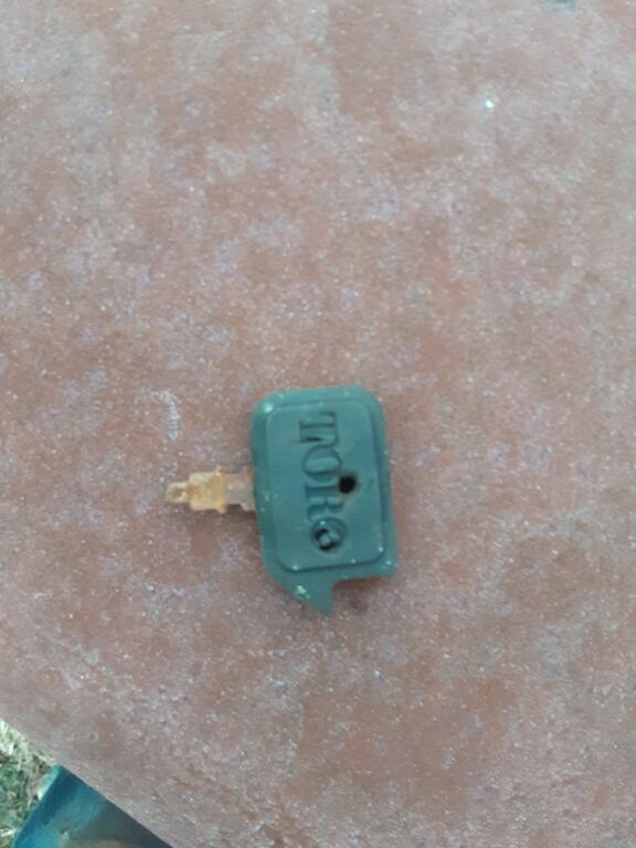

Oldskool 6,678 #3 Posted November 7, 2021 Welcome to the group. Alot of useful info here.. Some great people as well.. That's going to be a great tractor. The sickle bar is going to be a cool factor.. I have one on mine.. Here is my key. Share this post Link to post Share on other sites

8ntruck 9,293 #6 Posted November 7, 2021 (edited) to the forum. Keep asking questions. Somebody here has probably seen and solved whatever problem you are working on. I'vs only got two Wheel Horses. They both use the same key that @Oldskool pictured. In fact, the primary key I use is stamped 'John Deere' Edited November 10, 2021 by 8ntruck Share this post Link to post Share on other sites
WheelHorse520H 710 #7 Posted November 7, 2021 The key that goes to my 520 is the same as a go kart that I had and they both look exactly like the one @Oldskool posted. Welcome to RedSquare. You’ll probably have more knowledge here than you’ll ever need…but if you do it’s here. If it were me, I would just buy a new key switch, because they come with keys and it won’t be corroded. Share this post Link to post Share on other sites
Oldskool 6,678 #8 Posted November 7, 2021 1 hour ago, fullchoke said: Mine is a 1-0500 GT-14 serial #755823. Can I buy just the key? If so, is a new key available? I bought a used 1971 John deere tractor last summer and I went to the dealer for a new key. I just picked this little tractor yesterday, and know next to nothing. Glad I found this forum! Thanks for the welcome, appreciate the help! It looks like most of the interest on these tractors is in the eastern half if the US. I'm out in Oregon. I never saw one before, I ran across this one. Thanks again I get my keys at the local Napa. They have them in stock. 1 Share this post Link to post Share on other sites
gwest_ca-(File Mod) 12,484 #9 Posted November 7, 2021 Original key was part number 7262 replaced by 62-7770 and still available from Toro. https://www.partstree.com/parts/toro-62-7770/ Share this post Link to post Share on other sites
Oldskool 6,678 #10 Posted November 7, 2021 Also try a Google search. Stens #430-009. Your local TSC probably has them as well. 1 Share this post Link to post Share on other sites

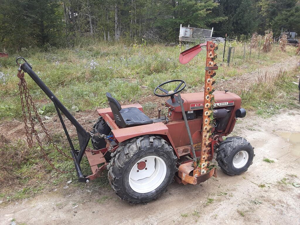

Oldskool 6,678 #16 Posted November 10, 2021 This is my link. 1 Share this post Link to post Share on other sites
fullchoke 22 #17 Posted November 10, 2021 Thanks Oldskool for the link. Your machine looks really nice! I'm trying to wrap my head around how mine is going to work. I don't think it is going to run like yours does. I think it will have to be manually raised and lowered. I have nothing toward the front of the tractor. Every time I look at mine, I think I understand how it will generally work then I get back to the house, and question myself as to what I saw. I've dismantled a bit of mine to get the sheetmetal off to be straightened. I'm going to compare what I have to yours tomorrow. The lightbulb has not come on in my head yet. Thanks again Share this post Link to post Share on other sites
Oldskool 6,678 #18 Posted November 10, 2021 You mentioned yours is a 405. Mine is also a 405. I believe they were for Bolens tractors. It's the same basic mower. I had to build my mounting brackets and find a 90 degree gear box. If you could post up pics of what you have that would be helpful. Share this post Link to post Share on other sites

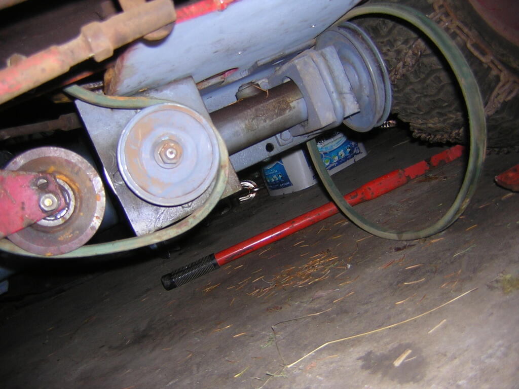

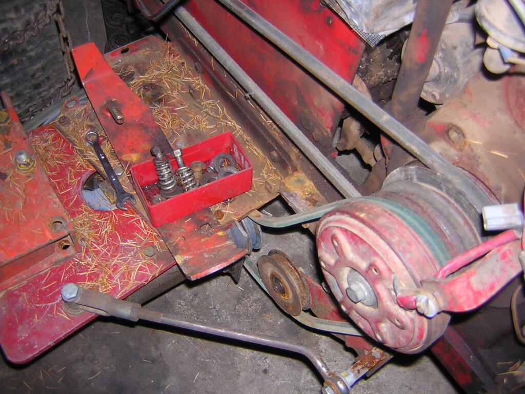

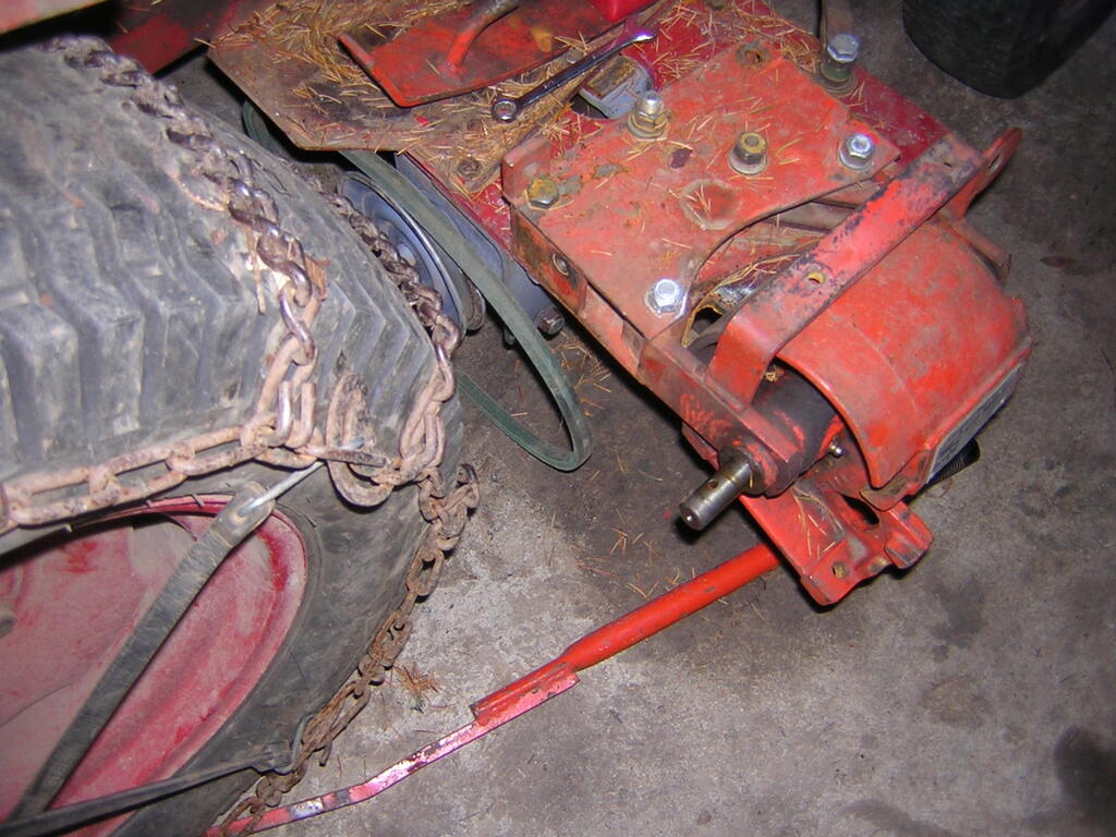

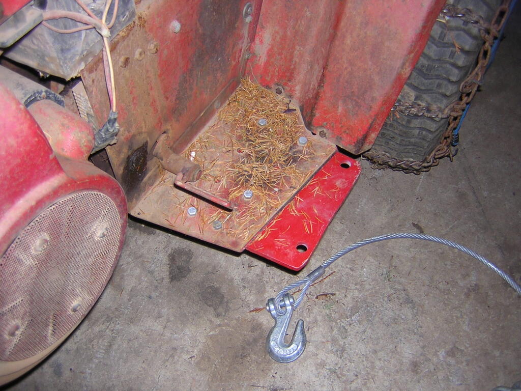

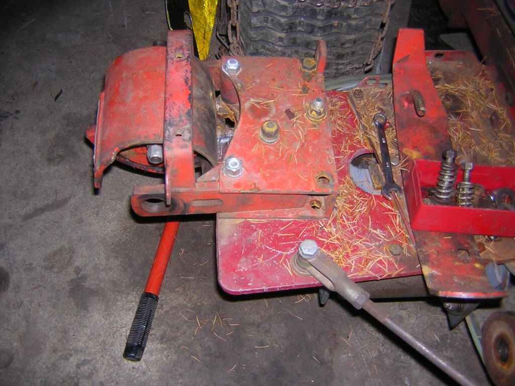

fullchoke 22 #19 Posted November 10, 2021 (edited) Mine has the 90 degree gearbox mounted. One of my concerns is that everything was mounted on 3/8 plate steel and then bolted to the bottom of the footpads. That bar way out on the end of the plate has quite a bit of leverage. That along with the vibration may put too much stress on those footpads. Especially traveling around with the blade up. That plate is bolted to both footrests. The tractor also came with 2 mower decks, one has blades, 1 none. Parts may be missing there too, but are probably much easier to find than Haban parts. I'm thinking about removing the sickle bar mounting and see what I need to put the mower deck back on. The sickle bar is really cool but a little less practical for me than the rotary mower. I have a brush hog on the back of a JD855 so I probably won't use it much for mowing other than for fun. Since I won't have the tractor running for awhile, I've moved stuff around for some pictures. I will get them up very soon. Thanks Edited November 10, 2021 by fullchoke Share this post Link to post Share on other sites
fullchoke 22 #20 Posted November 10, 2021 The 3rd and 4th picture shows most of the missing parts locations. There is only a clamp on the end of the bar. I removed the belt tensioner that would have been in photo#2, because the sheetmetal needed straightening and it was in the way of removal. Thanks Share this post Link to post Share on other sites
Oldskool 6,678 #21 Posted November 10, 2021 Ya that looks very different then mine for sure. It looks like it wouldn't be any more involved there then if you wanted to try and hook that up to the 3pt hitch. About the same amount of fab work either way. If I hadn't ended up with the help I recieved with mone I may have mounted mine on the back. Share this post Link to post Share on other sites

fullchoke 22 #23 Posted November 11, 2021 (edited) It has a tiller for the back, so the sickle mower on the rear isn't an option. I had to remove the tiller so the tractor would fit in the back of my shorty van for the trip home. It is still in there. There are no issues with the tiller. What do you think about the strain on the foot rests? Does yours shake the tractor much? Is there a sweet spot RPM wise that it will cut good and run smooth? Even tho our machines are mounted much differently, that off center rotation is where I would expect all the vibs to come from. We had a sickle bar mower on a Ford 8n when I was a kid, and I remember that thing running smooth at a high cutting speed and not cutting to well, but shaking hard if run slow, and it seemed to cut best on the slow side when shaking. Besides the vibration, and shaking, the strain on the frame carrying it around when not mowing is also a concern. I seem to be talking myself into removing the sickle bar and trying to get a mower deck on it instead. I think that is what I will do, at least until I find the needed parts to complete the sickle bar. Thanks Edited November 11, 2021 by fullchoke , Share this post Link to post Share on other sites
fullchoke 22 #24 Posted November 11, 2021 Hi 953, Mine has the points ignition. They might need some cleaning up. I will check for spark, when I get my new key. I think it was parked mostly indoors, so I'm hopeful it won't take too much to get it started. I'm too lazy to remove the tank, but I will flush it with fresh gas, remove the spark plug, give it a shot of oil and run the starter with the plug out. I also like to run a little 2 stroke mix at first to give it a little extra lube. Then I mix it 100 to one for regular use. That will keep the gas fresher between longer periods of non-use. I don't know how long it has been sitting so I will treat it like it was sitting a long time. The battery has a 2012 date on it, and it is taking a charge so I don't think it has had much use after 2012 or it wouldn't do that. 2 Share this post Link to post Share on other sites
Oldskool 6,678 #25 Posted November 11, 2021 My sickle does shake some yes. Not really a sweet spot,no.... If you have a deck for it I would think that is your best option. Having a tiller for yours is a plus. I wouldn't be concerned with the strain on the frame. @953 nut is running a loader on his. Those GTs are built tough. Share this post Link to post Share on other sites
