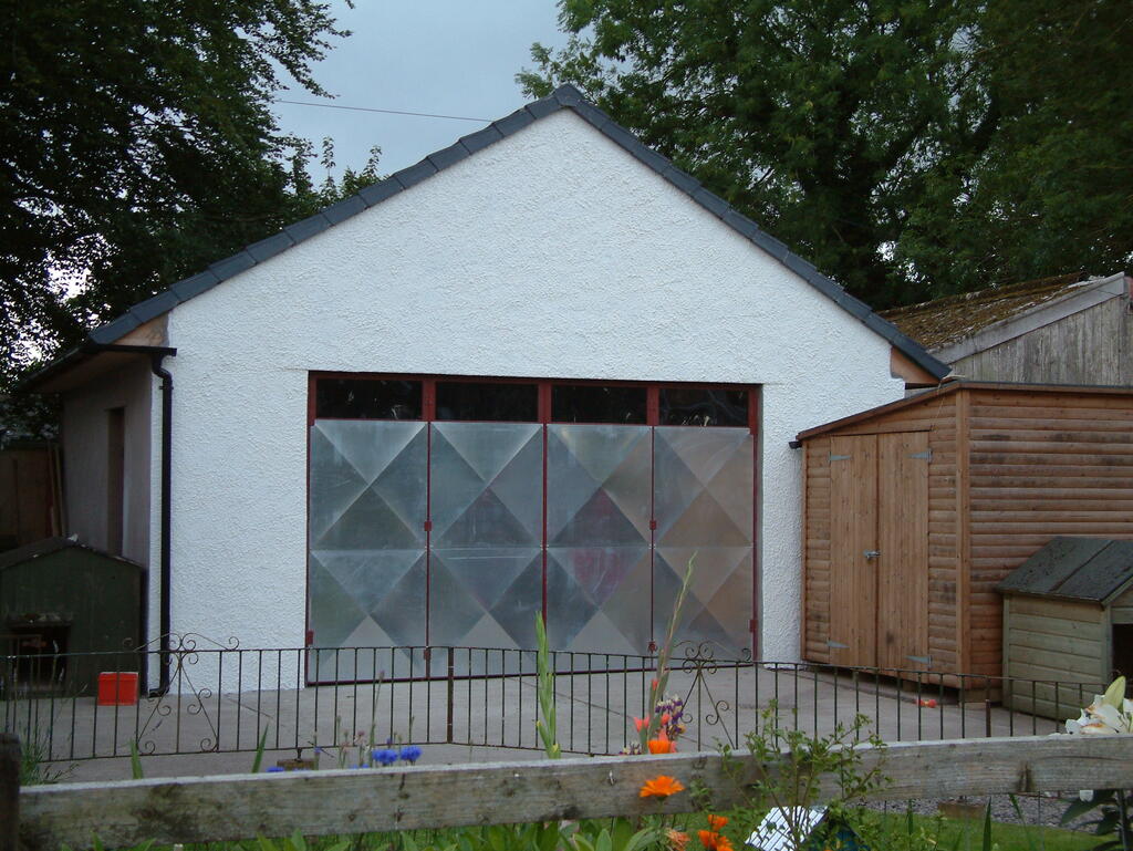

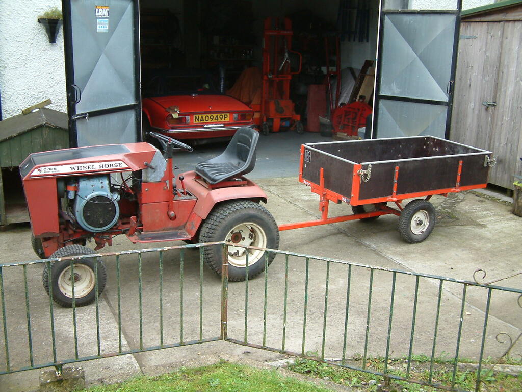

Stormin 9,988 #22 Posted November 8, 2021 Don't have any problems with springs, tracks etc with my workshop doors. Basically four doors. Box section frames and galvanized panels. You can have either of the centre ones open or both. Or two on one side or all four. 1 1 Share this post Link to post Share on other sites
Jeff-C175 7,211 #23 Posted November 8, 2021 1 hour ago, Stormin said: either Very cool that your WH gets to sleep with a late 70s Spitfire! How's she run? (The Triumph) Share this post Link to post Share on other sites
Stormin 9,988 #24 Posted November 8, 2021 Those photo's were taken about 5yrs ago. Spitfire was sold a few years back. Four WH's occupy the space now. 1 Share this post Link to post Share on other sites
Jeff-C175 7,211 #25 Posted November 8, 2021 18 minutes ago, Stormin said: Those photo's were taken about 5yrs ago. Spitfire was sold a few years back. Four WH's occupy the space now. Sad for the SF, happy for the WHs ! Share this post Link to post Share on other sites
