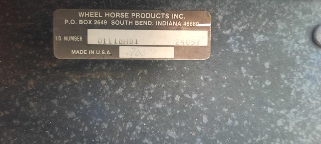

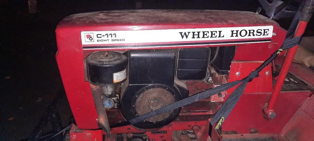

Docwheelhorse 2,992 #1 Posted November 3, 2021 Hello all, so... im working on my new C111... except the model doesn't appear in Toro MPV... its 0111BH81 the serial number on motor puts its birthday as 02/05/1982... far beyond any C111 production. So... @Sparky dug araround and thinks it's a 1982 SB421 with a different hood/ decal. He also says that the model should have a dash like 01-11BH01 What's the story with the SB421 / the GT2500 / the C111 and there production after the newer body style was introduced? Thanks Tony 3 3 Share this post Link to post Share on other sites
Docwheelhorse 2,992 #2 Posted November 3, 2021 Siggghhhh... dragged out Mike Martino's book on a whim. Its exactly what it says it is... im still happy a C111 is one of my favorites. An SB421 would've been a home run... but not this time 2 1 Share this post Link to post Share on other sites
gwest_ca-(File Mod) 12,536 #3 Posted November 3, 2021 This service bulletin has the C-111 listed as model 01-11BH81 but always considered it a typo. The 24057 serial fits in with the 1982 model SB-421 The build date looks like 2034 making it 1982 production. Adding C-111 would be a 1978 or 1979 model using the 1 as the last digit. A C-115 would have been used 1980-1984 2 Share this post Link to post Share on other sites
Docwheelhorse 2,992 #4 Posted November 3, 2021 21 minutes ago, gwest_ca said: This service bulletin has the C-111 listed as model 01-11BH81 but always considered it a typo. The 24057 serial fits in with the 1982 model SB-421 The build date looks like 2034 making it 1982 production. Adding C-111 would be a 1978 or 1979 model using the 1 as the last digit. A C-115 would have been used 1980-1984 But.... look at the pic out of the book 1 Share this post Link to post Share on other sites
Sparky-(Admin) 26,706 #5 Posted November 3, 2021 I think it’s a genuine 1982 C-111 built with leftover parts just to get em off the shelf and out of inventory. If your model # has an 01 at the end it’s an SB421 and if your model # has 81 at the end it’s a 1982 C-111 4 1 Share this post Link to post Share on other sites
