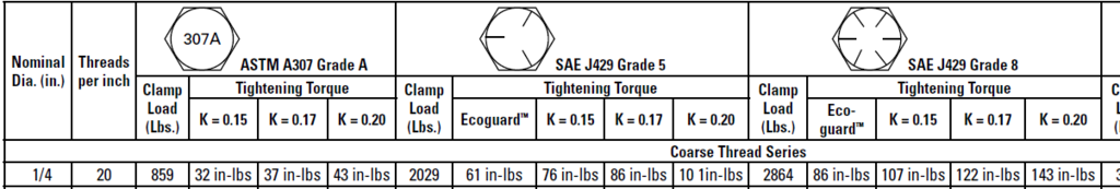

Jeff-C175 7,211 #14 Posted November 1, 2021 Anybody know the torque spec on the clutch plate bolts? They were not tight enough and I went to 15 ft lb. Being smaller bolts I didn't want to risk 20. Is 15 OK for those? Share this post Link to post Share on other sites

WHX?? 58,076 #22 Posted November 1, 2021 (edited) 2 hours ago, Jeff-C175 said: Anybody know the torque spec on the clutch plate bolt Whatever the standard is for a mild steel 1/4-20 bolt Jeff ... some where around 30 in-lbs if I remember right... yep right around there Edited November 1, 2021 by WHX?? 1 Share this post Link to post Share on other sites
Jeff-C175 7,211 #23 Posted November 2, 2021 6 hours ago, WHX?? said: some where around 30 in-lbs That's barely hand tight! Share this post Link to post Share on other sites
WHX?? 58,076 #24 Posted November 2, 2021 (edited) Charts ain't suposed to lie tho Jeff... might want to check a few others ...that one was from Fastenal but I find they vary. Tons of them out ther in googleland. In other words the engineers as in AMSE or ASHRAE have no idea! Like the Hosen says tho tighten it till it snaps off then back off a 1/4 turn! Edited November 2, 2021 by WHX?? Share this post Link to post Share on other sites
Jeff-C175 7,211 #25 Posted November 2, 2021 Just now, WHX?? said: Charts ain't suposed to lie tho... might want to check a few others ...that one was from Fastenal but I find they vary. In other words the engineers as in AMSE or ASHRAE have no idea! Like the Hosen says tho tighten it till it snaps off then back off a 1/4 turn! I didn't look at the heads to see the grade marks, but I'll do that tomorrow. I would like to think that they would have used at least grade 5. I need to research that "ecoguard" and K number too. Share this post Link to post Share on other sites
