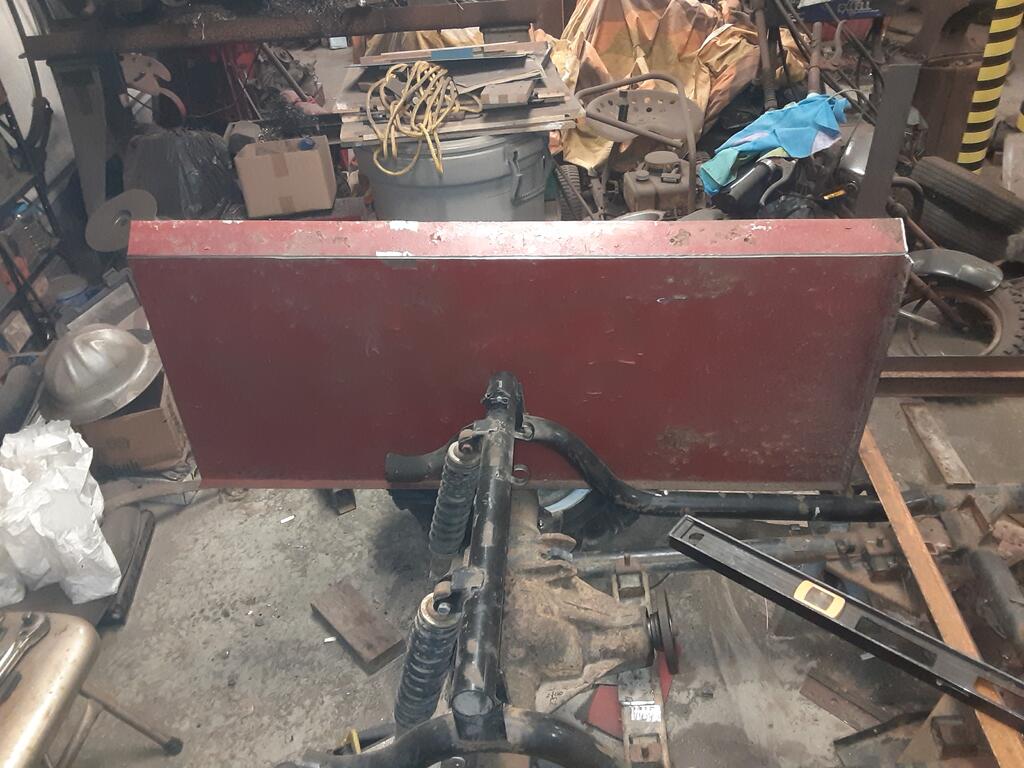

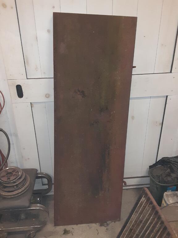

Today's little project is to use some free Bilco doors and make a truck bed out of them.

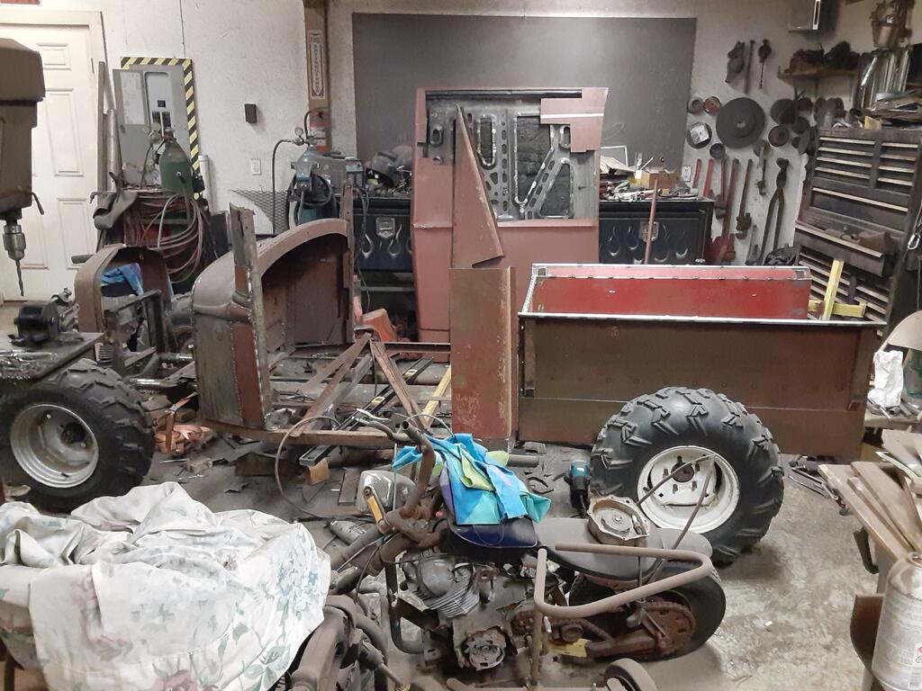

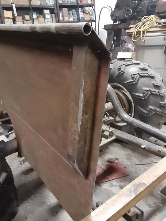

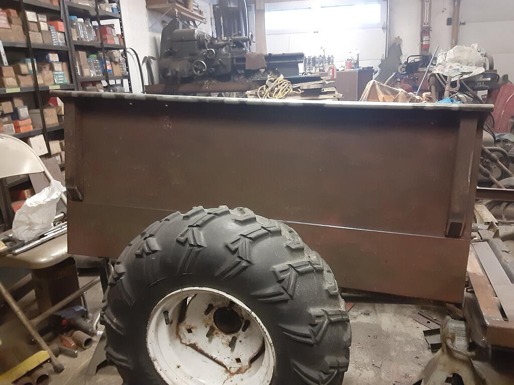

It's currently sitting on the wrong side, but it's easier for pics on this side.
The shiny horizontal line is a lite score mark from the grinder. Probably not needed but I put it there in hopes it makes the bed look smaller by making it look like it has a filler panel under it.
On to round 2........

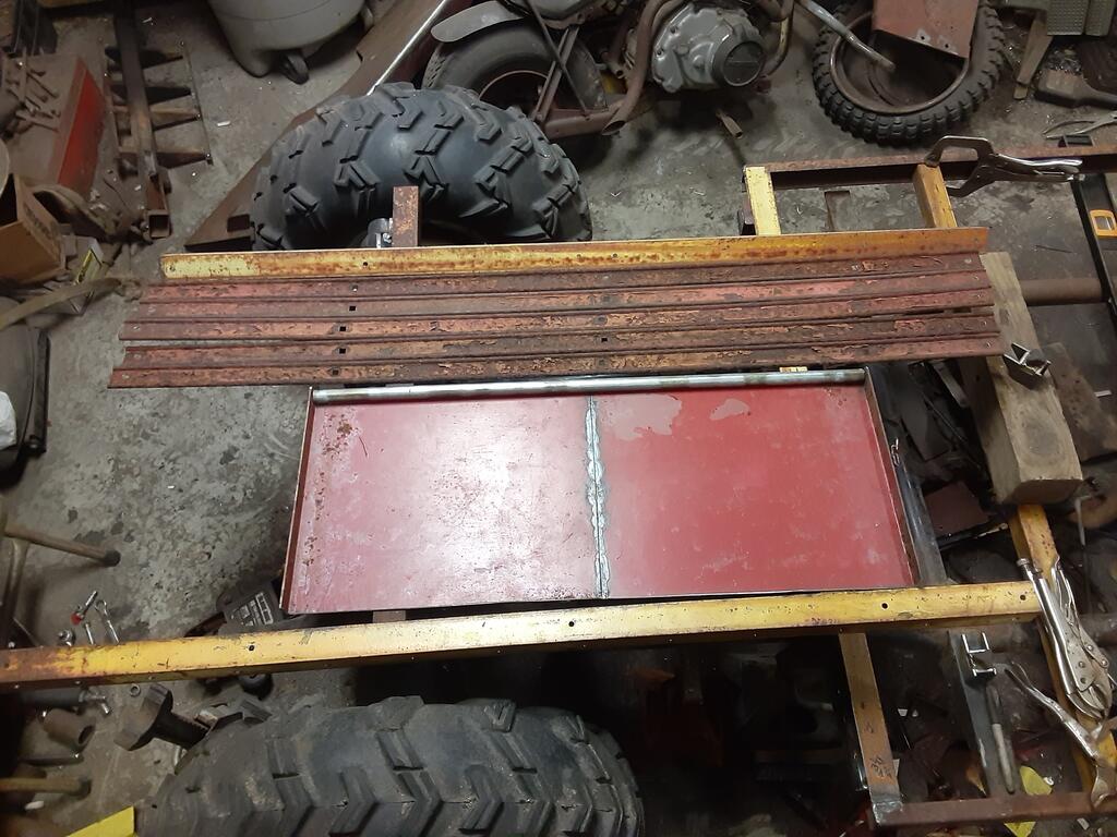

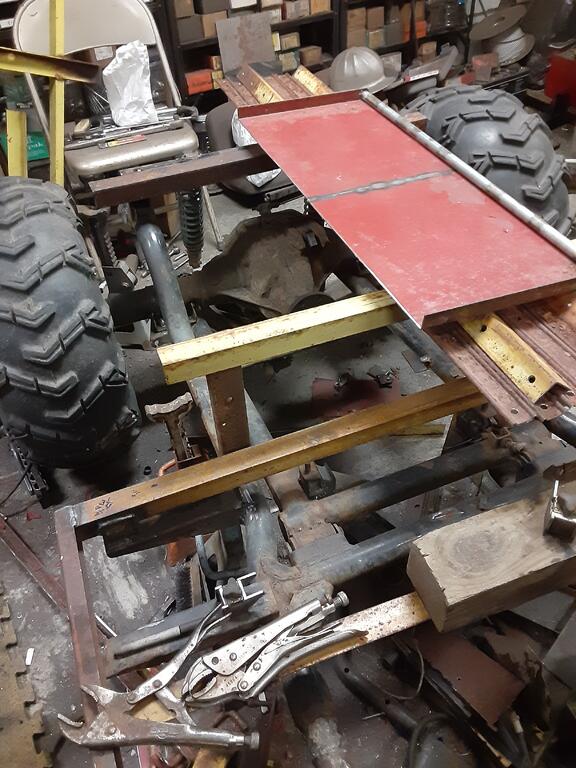

Oldskool
Slow going today,  but still moving forward.
Dug out some old truck bed strips for the wooden floor.
Made 4 of 6 frame mounts for the body.
Put together a headboard.
Maybe tomorrow the body will be assembled and temp mounted without the wood floor.

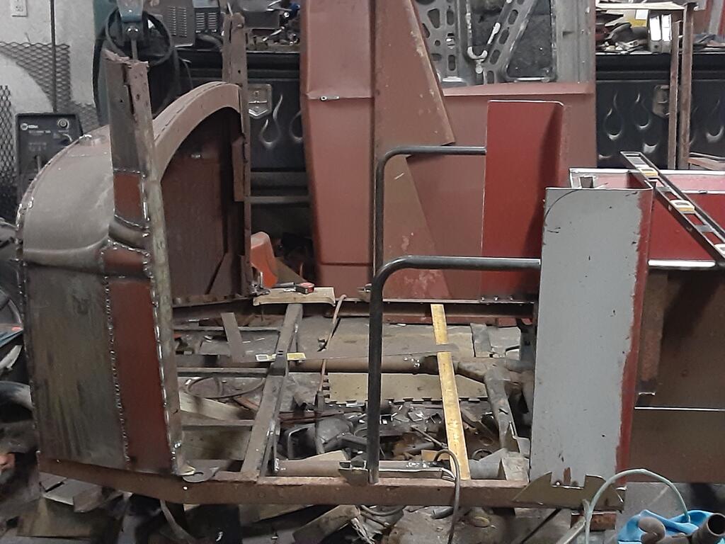

Oldskool
Played catch-up on some stuff today.
Dialed in the cab corners a bit more. I think I'm going to add the bar to the cab corner. Not only for strength but to add an armrest to.. It's where the "old truck look" meets the side by side UTV look.

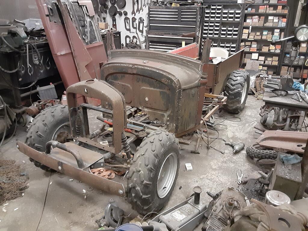

      Can anyone ID this?
    • Oldskool
      By Oldskool
    • Oldskool
      By Oldskool
      I've wanted to do this type of project for a while now. So here we go. The name was given by @wallfish. It will be called "The Yeti".  It will be painted and badged in a military theme. The front axle is in progress now.
