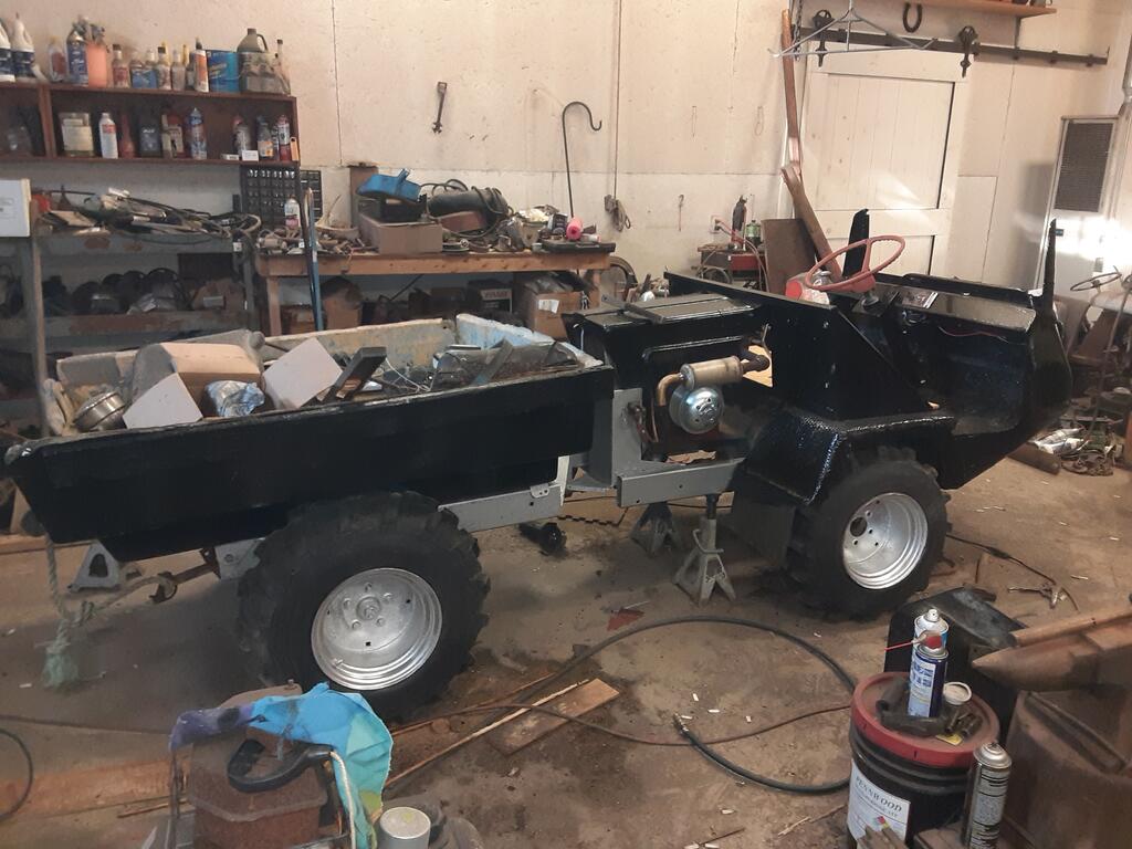

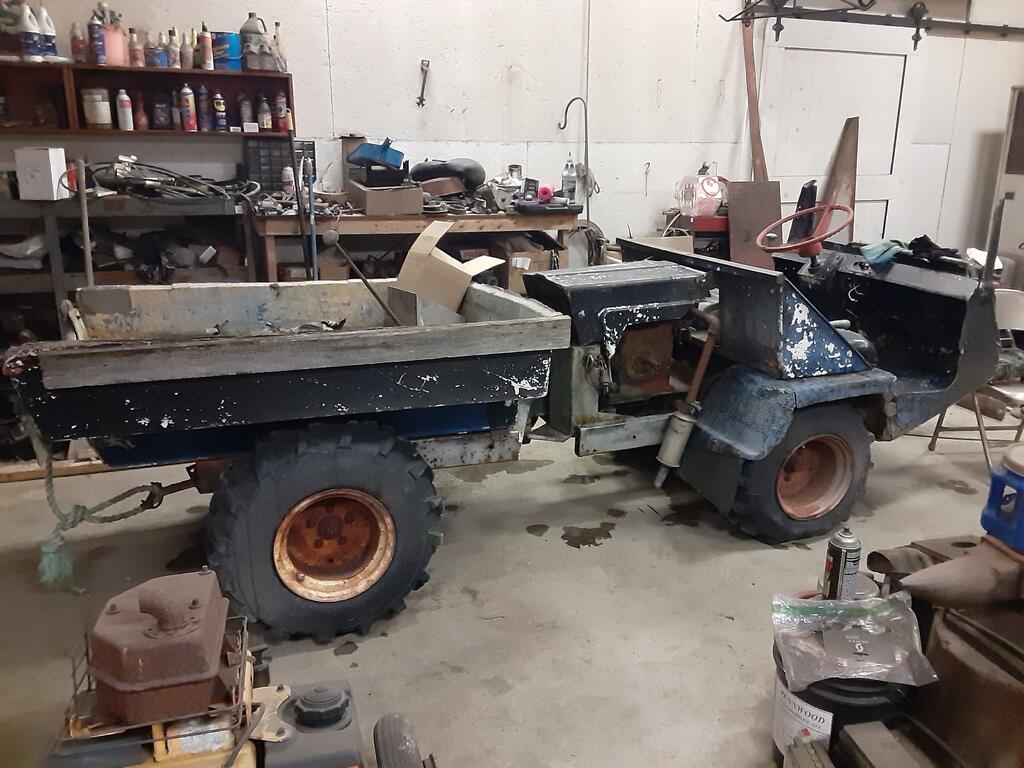

Shop time has been taken up with this beast.
This PUG belongs to a friend of mine.
It's been used and abused. I think abused might be a mild term.
It's one of those things I probably should have never let in the shop.

Besides him being a friend, it's to bad to let this beast just disappear.
Made some good progress on it.
I'm hoping Wed it will go home.

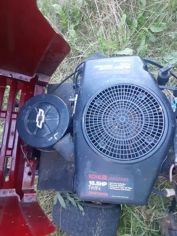

My current thought process is to use a 18.5hp Kohler Magnum opposed twin vert. shaft engine, belt clutch driven to a
Tuff Torq K61-A hydro transmission from a Toro Wheel Horse 265H. Transmission would be turned 90degree from conventional use. Matching sprockets on both axles or mount then directly to the 5 lug hubs to drive chain on both ends to sprockets attached to a drive shaft running under or beside the trans to the narrowed Ford rear axle.
I'm not sure of the final drive gear ratio for the hydro rear so sprocket size and top speed is currently NA.
The idea of using the hydro drive is so the wife can drive it by herself with ease when/if needed
Please add input of any kind.

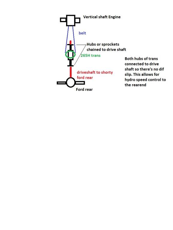

I don't s'pose you could scribble up a @wallfish toss 'em out drawing ?
wallfish
This is my take and basic idea of what he's say'n
The drive shaft is under the trans or maybe another position but connected to the trans with chains
Edited by wallfish
  • Heart 1
You're a good man John.
Trans-laytin' one Maine man's speak to another is an art all in itself.
wallfish
It's a cool idea and not 100% sure it's exactly what he's getting at.
