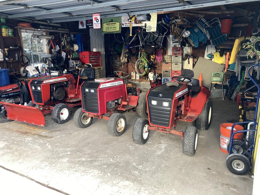

SylvanLakeWH 32,722 #127 Posted April 14, 2022 Yes. Only difference is the hood is fiberglass, wraps lower on sides and is taller and the seat pan sits higher to accommodate two batteries where the gas tank would be. Here’s some comparison pics: 3 3 1 Share this post Link to post Share on other sites

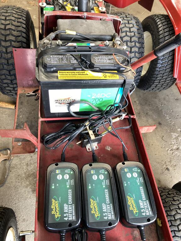

ebinmaine 80,999 #128 Posted April 14, 2022 7 hours ago, SylvanLakeWH said: accommodate ... batteries Holds ((6??)) Total? 4 under hood, 2 under seat? I know you're using 3..... 2 Share this post Link to post Share on other sites

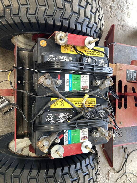

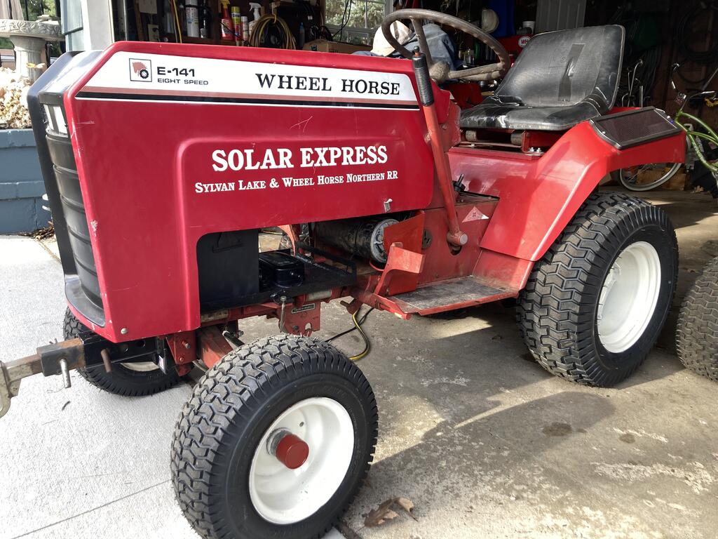

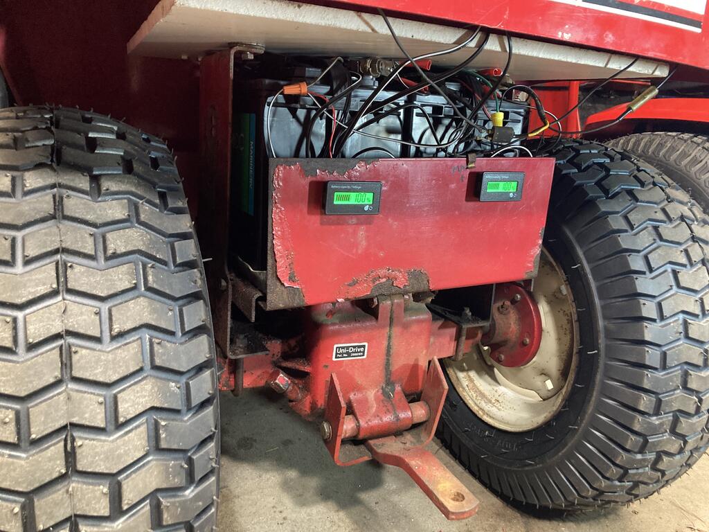

SylvanLakeWH 32,722 #129 Posted April 14, 2022 Yes standard is 6. Two banks of three wired in series then connected in parallel. I’m running three in series. 36 volt. Two under seat and one under hood. But… now there’s 4 batteries…! Big progress today. New (3) batteries installed. Train horn hooked up. Using best of old batteries dedicated to the horn and eventual lighting for the train… working on adding the battery monitors… IMG_1458.MOV 2 4 Share this post Link to post Share on other sites

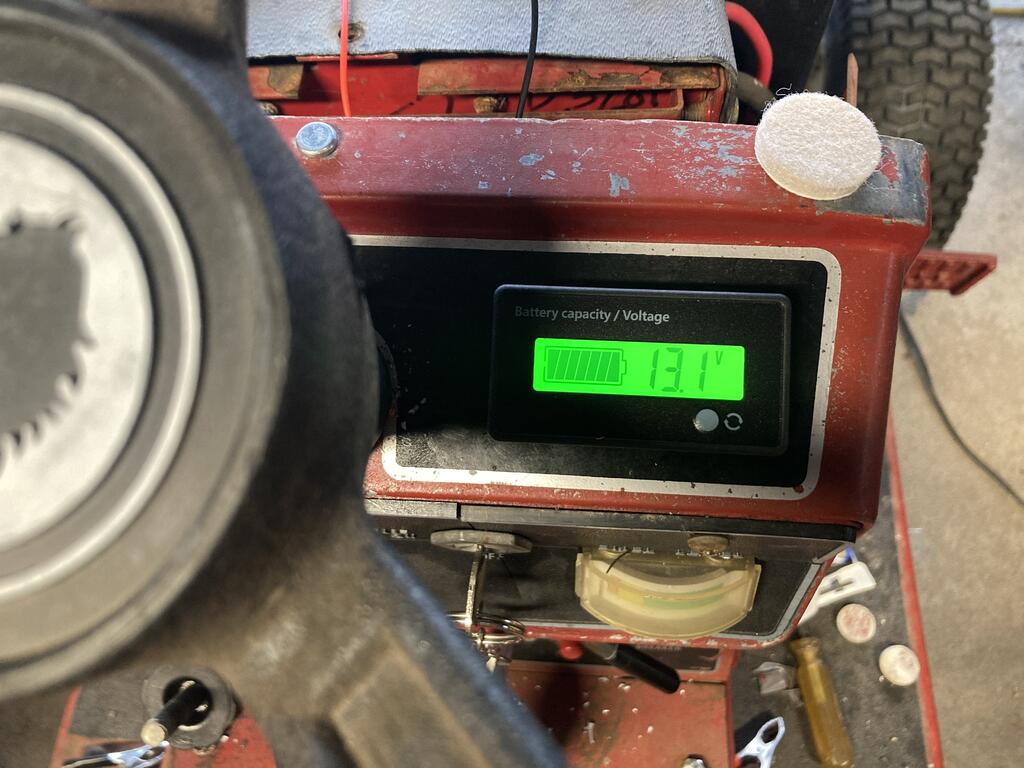

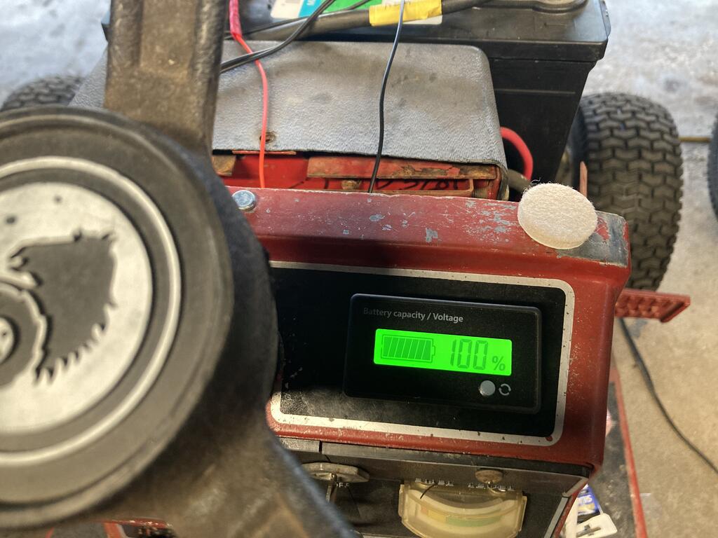

SylvanLakeWH 32,722 #130 Posted April 15, 2022 Battery monitors are in! Work great! Love being able to check status at push of button… 2 4 Share this post Link to post Share on other sites

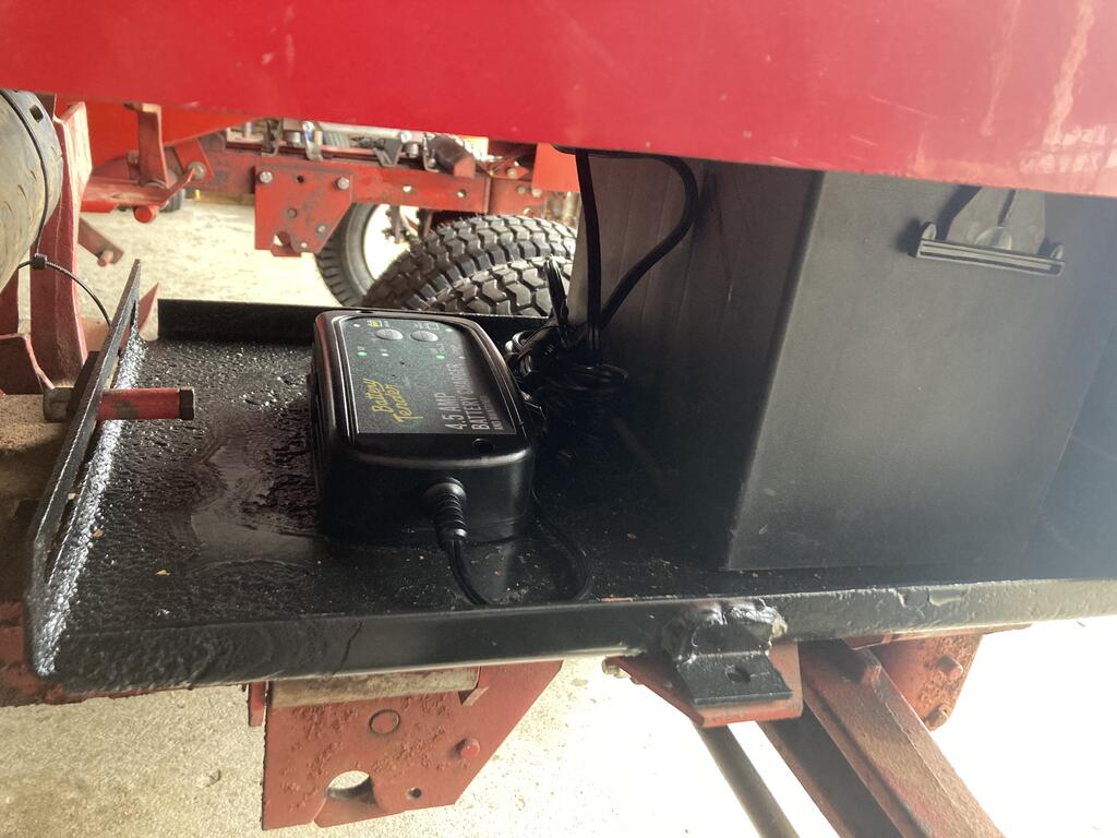

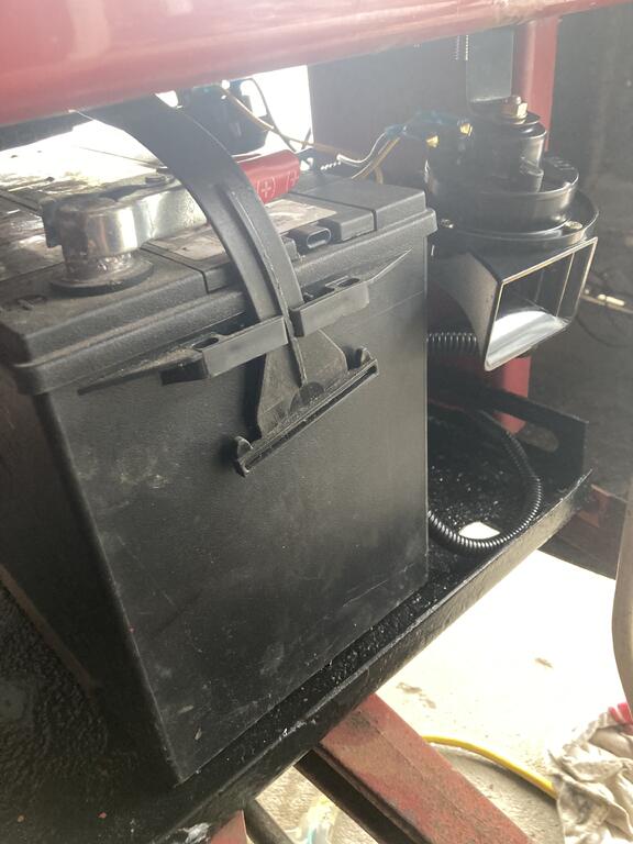

SylvanLakeWH 32,722 #131 Posted April 15, 2022 (edited) Added dedicated tender for the horn / lights / accessories battery. Edited April 15, 2022 by SylvanLakeWH 2 Share this post Link to post Share on other sites

SylvanLakeWH 32,722 #133 Posted April 17, 2022 6 hours ago, c-series don said: @SylvanLakeWHI’m just glad one of those E-Series tractors is back in service! And I or should I say we because I pretty sure I speak for us on RS are super happy to see that tractor getting ready for use as the locomotive! Thanks! But I do give most credit to Erv Troyer who got it going for Dave Mercer the previous owner. See post 14. He and Dave were very helpful early on with history and direction… I’ve been blessed to be putting the finishing touches on their great efforts… 4 Share this post Link to post Share on other sites

Maxwell-8 4,371 #135 Posted April 19, 2022 Any idea how many KW the electric motor is? 1 Share this post Link to post Share on other sites
SylvanLakeWH 32,722 #136 Posted April 19, 2022 2 hours ago, Maxwell-8 said: Any idea how many KW the electric motor is? Nope. I have read elsewhere that it supposedly was equal to a 14 hp engine but I don’t know if that is accurate. I don’t recall where I read it… No details in the owners manual I have… 2 1 Share this post Link to post Share on other sites
Maxwell-8 4,371 #137 Posted April 19, 2022 2 hours ago, SylvanLakeWH said: Nope. I have read elsewhere that it supposedly was equal to a 14 hp engine but I don’t know if that is accurate. I don’t recall where I read it… No details in the owners manual I have… 14hp is around 10.5KW. Then it must go trough a lot of battery? Your battery's are 80AH, at 12v each so 80 AH*36V for the three= 2880 watts for an hour or 2.88KWH that means you will have 3.9hp available for a complete hour. which I think is pretty good. Or at full power, I think you will have 16 minutes. That being said, pulling the train wouldn't require full power probably less then half. PS. I may be completely wrong with my calculation here, just thinking out loud. 2 1 Share this post Link to post Share on other sites
SylvanLakeWH 32,722 #138 Posted April 19, 2022 Beats me… I’m not an electric guy… I have not run it with full train but it will be in first or second gear and everything rolls pretty easy on paved flat roads… I ran it for half hour in third gear pulling one trailer with four kids and it didn’t even flinch… I now have the battery monitors and will be testing full train with weight as soon as it stops snowing!!! Should tell me how much juice it uses…I really only need 1/2 hour run times for what I do with it… so I am confident my needs will be met… 1 1 Share this post Link to post Share on other sites

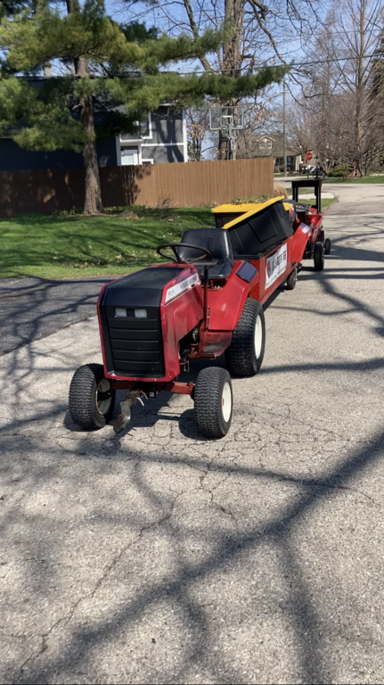

SylvanLakeWH 32,722 #139 Posted April 23, 2022 (edited) Perfect puller… Very pleased with its train duties!!! Boxes are for weight… Edited April 23, 2022 by SylvanLakeWH 1 2 Share this post Link to post Share on other sites

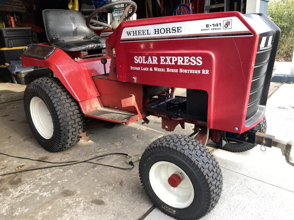

SylvanLakeWH 32,722 #140 Posted April 30, 2022 Finishing touches from @Vinylguy… 4 2 Share this post Link to post Share on other sites
ebinmaine 80,999 #141 Posted May 1, 2022 Excellent usage of space for the added decals. Very impressive work on all changes. 1 1 Share this post Link to post Share on other sites

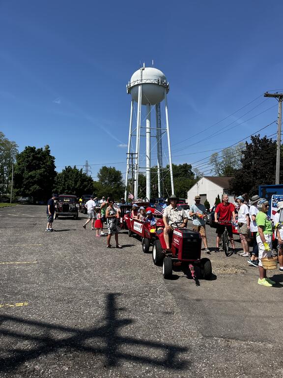

SylvanLakeWH 32,722 #142 Posted May 31, 2022 Pulled the train with 8 kids today in the local Memorial Day Parade. The E 141 worked like a charm. I am pleased.. ! 1 7 1 Share this post Link to post Share on other sites

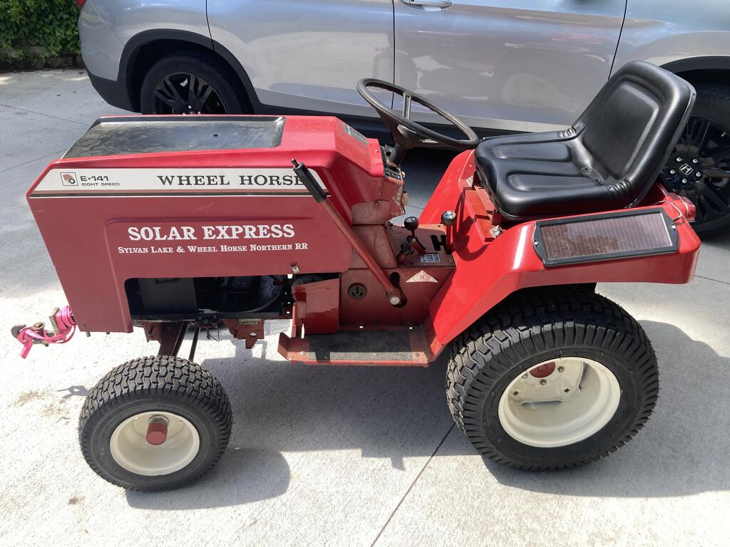

SylvanLakeWH 32,722 #144 Posted June 12, 2022 New seat today from A to Z tractor… 3 Share this post Link to post Share on other sites
Maxwell-8 4,371 #145 Posted June 12, 2022 22 minutes ago, SylvanLakeWH said: New seat today from A to Z tractor… Looks nice and comfy! Can't stand a duck tape seat myself. big upgrade. 1 1 Share this post Link to post Share on other sites
