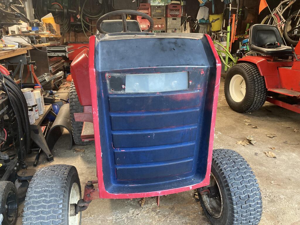

WHX?? 58,308 #26 Posted November 5, 2021 (edited) 34 minutes ago, Wheel Horse 3D said: I think the frosted like Craig's looks best. I thought the frosted might block too much light. Havta ask @jeremi3210 now I sold the tractor to him and sent the lens with it. Edited November 5, 2021 by WHX?? Share this post Link to post Share on other sites
SylvanLakeWH 32,722 #27 Posted November 5, 2021 Mama ain’t letting’ me take the youngsters for night rides… it’ll look better not seeing the bulbs I think… Share this post Link to post Share on other sites

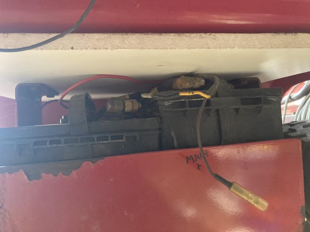

pfrederi 21,244 #31 Posted November 5, 2021 On 11/2/2021 at 9:52 PM, Handy Don said: Ye Yep. You can get 12, 24, or 36. Your choice. Its just like tapping transformer windings to get different outputs. For a very limited load that will work. however a bigger load will unbalance the batteries. Example military vehicles run 24v People tap one battery to run 12v accessorizes. Limited to a phone charger or other low draw OK but bigger draw and you start having issues the batteries do not charge up evenly... 1 2 Share this post Link to post Share on other sites
SylvanLakeWH 32,722 #32 Posted November 5, 2021 So don’t check the batteries with the 9v tongue trick…? Got it. I’m gonna need to bone up on this battery voltage amp DC balance draw stuff… 1 Share this post Link to post Share on other sites

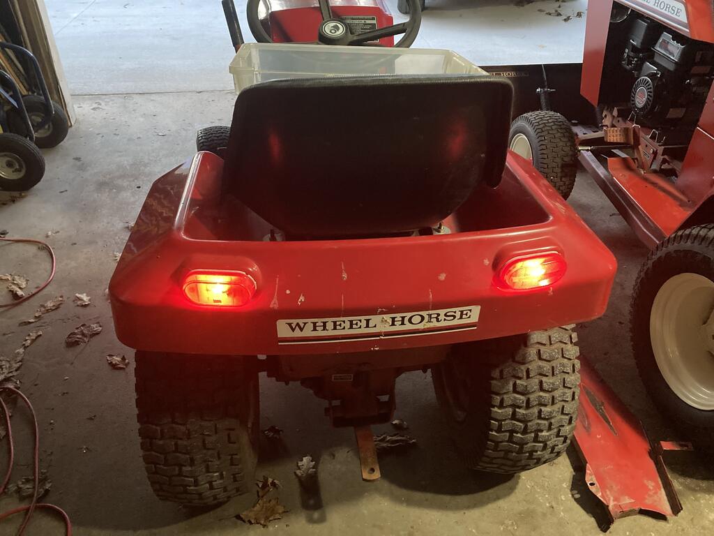

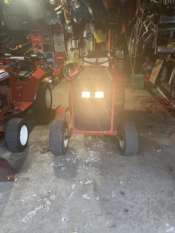

SylvanLakeWH 32,722 #33 Posted November 5, 2021 Lights work! Not going to blind you, but they do the job… 3 2 Share this post Link to post Share on other sites

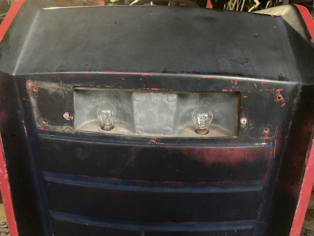

Erv Troyer 16 #34 Posted November 6, 2021 3 hours ago, SylvanLakeWH said: Lights work! Not going to blind you, but they do the job… Yes, I know - I fixed them. Put in new bulbs all around. I had to shorten the hood support rope to keep the connectors from pulling apart. The older rope on that bar is the original one, and probably could be used again. The front bulbs are 1156 tail light bulbs. You can get LED bulbs now to fit those sockets. 1 1 Share this post Link to post Share on other sites

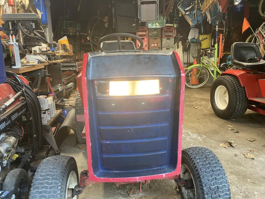

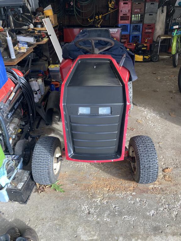

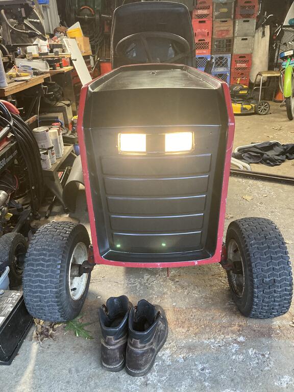

SylvanLakeWH 32,722 #44 Posted November 10, 2021 (edited) Took advantage of warm day and put coat of black on the hood. Also made the headlight cover look right with black separation… Edited November 10, 2021 by SylvanLakeWH 4 1 Share this post Link to post Share on other sites
Maxwell-8 4,371 #45 Posted November 11, 2021 That black hood, looks quite a bit beefier then an gas-powered black hood. coming along nicely! 1 Share this post Link to post Share on other sites
SylvanLakeWH 32,722 #46 Posted November 11, 2021 4 hours ago, Maxwell-8 said: That black hood, looks quite a bit beefier then an gas-powered black hood. coming along nicely! Thanks! It’s actually fiberglass and is slightly taller, wider and the sides come down a bit more compared to regular metal Black Hoods… I think the design is intended to keep more snow/rain out due to the electronics, batteries etc… 1 1 Share this post Link to post Share on other sites

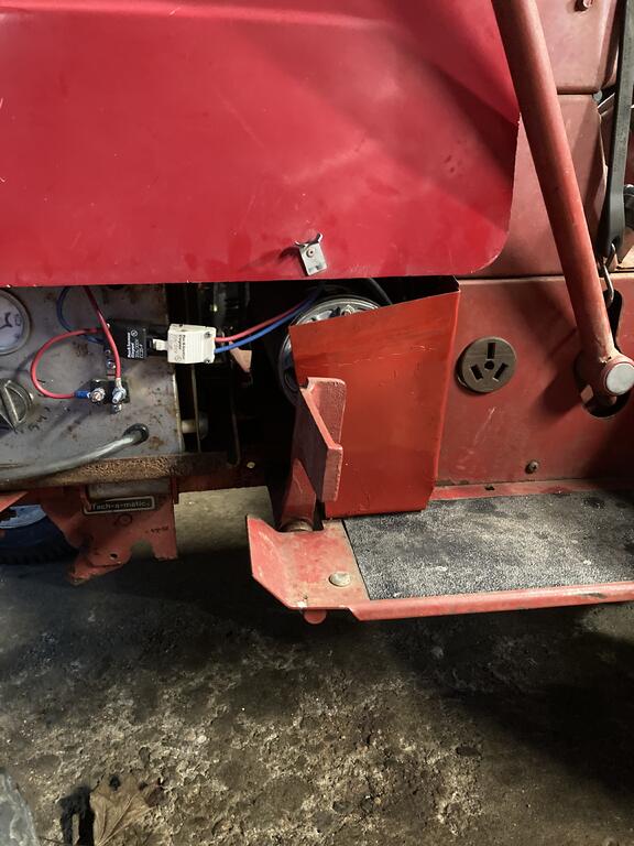

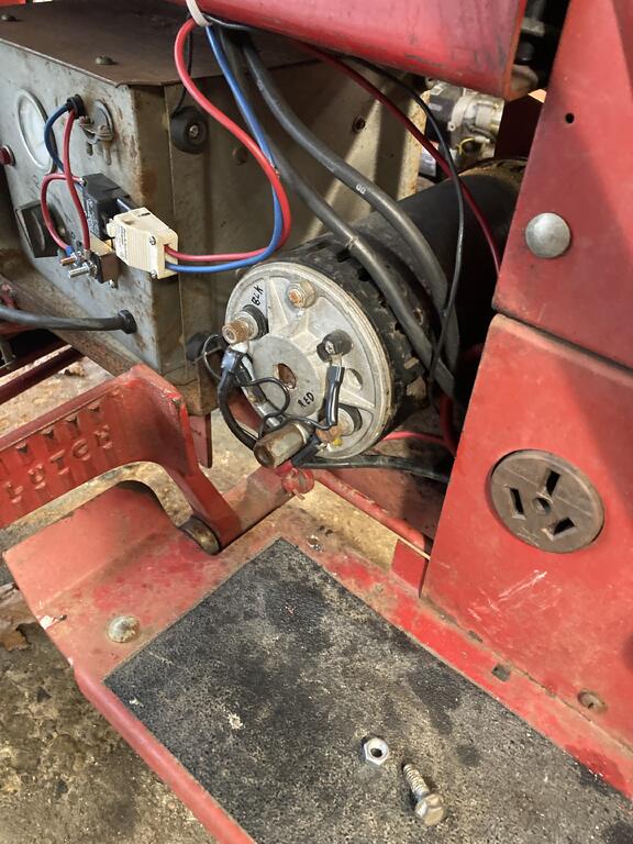

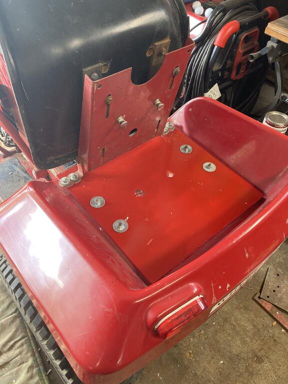

SylvanLakeWH 32,722 #47 Posted November 11, 2021 (edited) More done today… Seat pan is now solid and works great! Created a “sandwich” of PVC board above and below the seat pan. Very rigid now… Fabricated a guard for the exposed wires on clutch side of the motor. I think there must have been something there new, but long gone…used the other half of the belt guard I used for the drive belt fab… Edited November 11, 2021 by SylvanLakeWH Added pic of installed wire guard… 2 1 Share this post Link to post Share on other sites

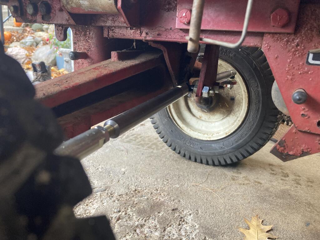

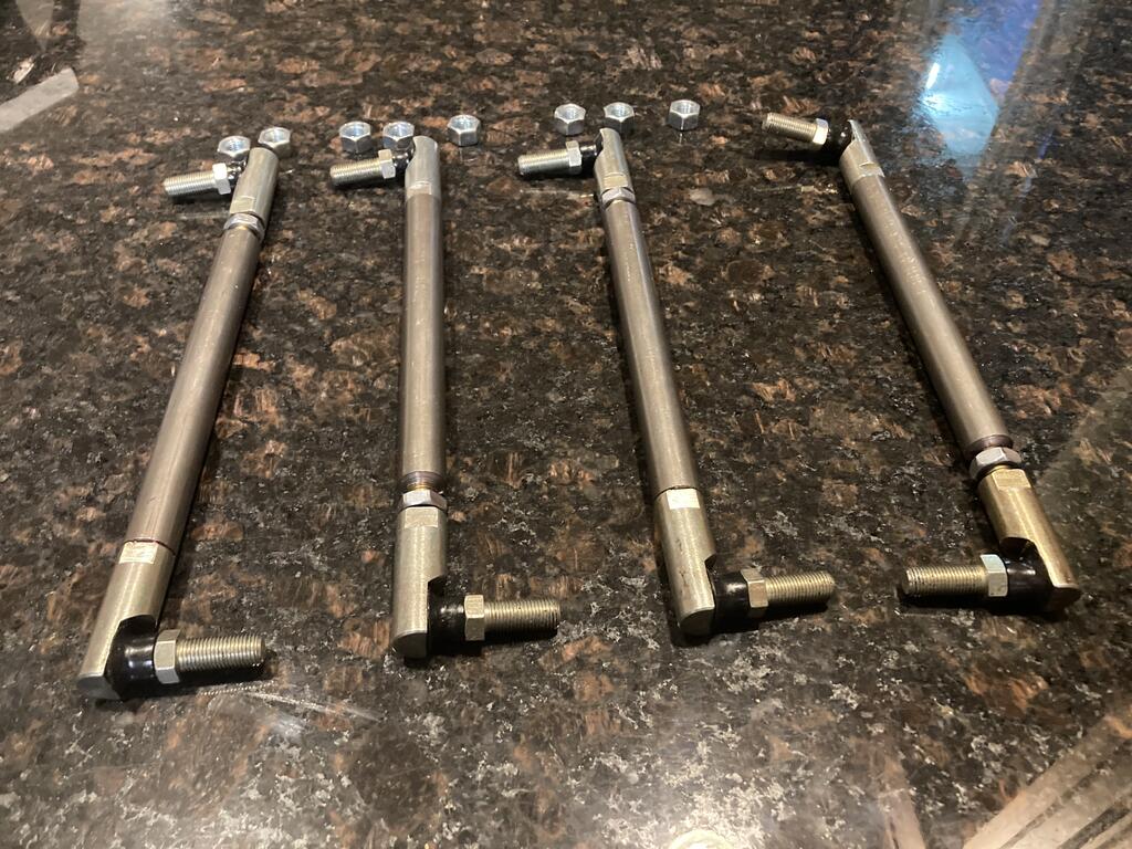

SylvanLakeWH 32,722 #49 Posted November 12, 2021 New tie rods in the mail tonight!!! Thanks Lowell - Wheelhorsepartsandmore!!! Both the E 141 and the C 105 are gonna get replacements… the E 141 has that lazy eye thing going on with the fronts going their separate ways… 🤪 1 Share this post Link to post Share on other sites
SylvanLakeWH 32,722 #50 Posted November 13, 2021 Tie rods installed… No more wandering front end…! 1 2 Share this post Link to post Share on other sites
