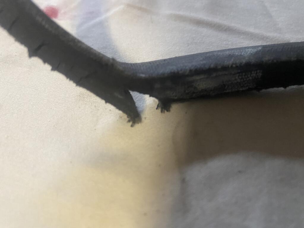

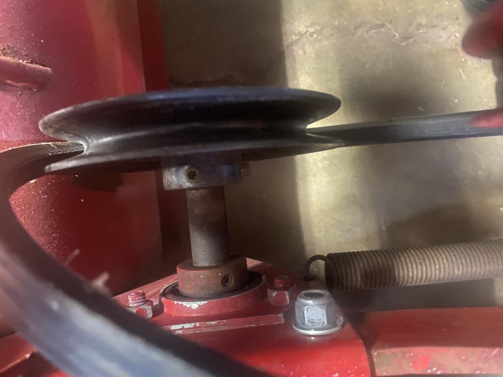

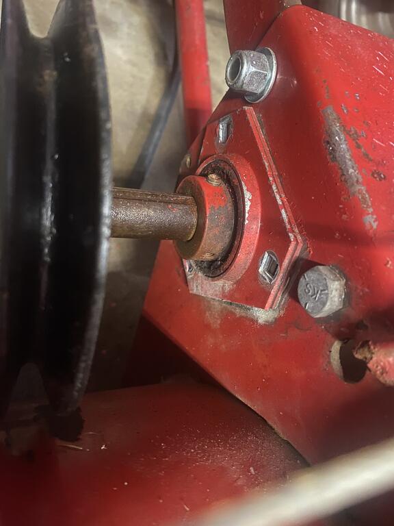

Lane Ranger 12,092 #1 Posted October 29, 2021 (edited) Ok my 42 inch snowblower has a bad belt that needs to be changed. I have a new toro belt but I see the drive pulley has to be removed to set the new belt in place. This pulley (113356 costs about $65 to replace and I am trying hard not to damage it in removal process). This pulley has two set screws which I removed. I have been spraying with penetrating oil and have been trying to remove by using a bar and hammer on the shaft side. But no luck moving it yet. I started to use a pulley puller but this thin metal would bend and destroy the pulley if I pursued this route. Any suggestions on removing this drive pulley?? Edited October 29, 2021 by Lane Ranger Share this post Link to post Share on other sites

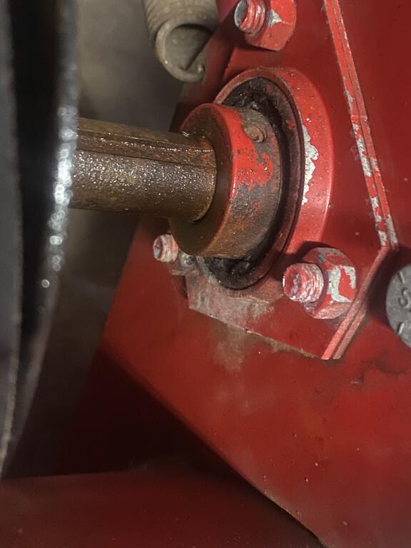

Jeff-C175 7,211 #3 Posted October 29, 2021 (edited) Can you unbolt the bearing and move shaft and all? You only need like a quarter inch. The older blowers used the cast 3 spoke pulley which was no problem for a puller. Too bad they switched. @Lane Ranger Edited October 29, 2021 by Jeff-C175 5 1 Share this post Link to post Share on other sites
Lane Ranger 12,092 #4 Posted October 29, 2021 5 minutes ago, Jeff-C175 said: Can you unbolt the bearing and move shaft and all? You only need like a quarter inch. The older blowers used the cast 3 spoke pulley which was no problem for a puller. Too bad they switched. @Lane Ranger I just found this suggestion and I am going to try this this afternoon! in response to changing the belt... i just remove two of the three bolts and loosen the third bolt that holds the flange bearing behiind the pulley. this creates enough "play" to move the pulley away from the housing and remove/replace the belt. 5 Share this post Link to post Share on other sites
peter lena 10,014 #5 Posted October 29, 2021 @Lane Ranger agree with @ jeff -c175 , on that removal awkward work areas , just add problems .btw , do a little lubrication detailing on that spring tension mount , mine was a rusty mess till i changed it to working in chassis grease . makes the belt drive work easier , pete 1 Share this post Link to post Share on other sites
pfrederi 21,046 #6 Posted October 29, 2021 If loosing shaft doesn't work a flange bearing puller should just grab the hub of the pulley 2 Share this post Link to post Share on other sites
Lane Ranger 12,092 #7 Posted October 29, 2021 41 minutes ago, Jeff-C175 said: Can you unbolt the bearing and move shaft and all? You only need like a quarter inch. The older blowers used the cast 3 spoke pulley which was no problem for a puller. Too bad they switched. @Lane Ranger I just found this suggestion and I am going to try this this afternoon! in response to changing the belt... i just remove two of the three bolts and loosen the third bolt that holds the flange bearing behiind the pulley. this creates enough "play" to move the pulley away from the housing and remove/replace the belt. this worked like a charm but I did remove all three carriage bolts and loosened the set screw on the bearing! The shaft moved enough to remove the old belt! I will install the new belt this afternoon! 2 6 Share this post Link to post Share on other sites

DougC 2,644 #9 Posted October 29, 2021 I just used my air chisel with a hammer bit and a few short zaps walked it off easily. Share this post Link to post Share on other sites
wallfish 20,510 #10 Posted October 29, 2021 Yup, remove the bearing bolts and the belt will come out. The pulley edge being close to the housing will keep the belt from being thrown off the pulley during heavy use. Like Ed, I had a smaller pulley on a SS for the speed but it did throw the belt once or twice when moving heavy piles. It was the nothing to heavy load and back again which had the belt slapping about. 1 Share this post Link to post Share on other sites
