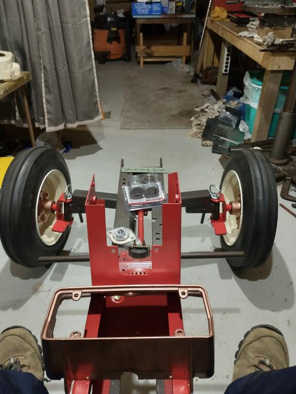

ebinmaine 79,685 #11 Posted October 28, 2021 3 hours ago, jtrosp1980 said: I want something with a bite what are the three rib Here's a pic of the front end of The Colossus build. Tri ribs or 3 ribs are a standard 2wd farm tractor tire. 1 Share this post Link to post Share on other sites
