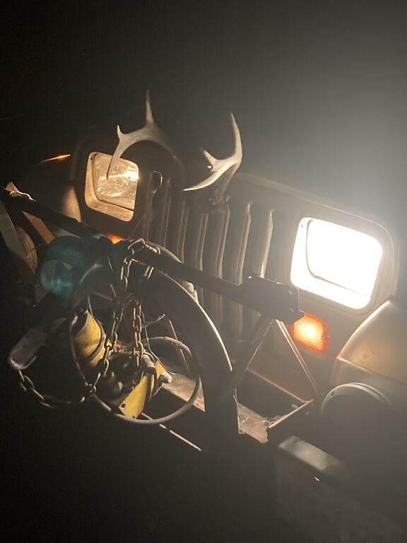

Ifixoldjunk 778 #1 Posted October 26, 2021 So I finally got my project wrangler road worthy, and I pretty much made it 100 feet down the road before I lost all my gauges. Anyone have any clue what happened? I’m pretty clueless with electrical stuff. I’m guessing it’s either a fuse or ground but where? Share this post Link to post Share on other sites
cafoose 3,882 #2 Posted October 26, 2021 (edited) Looks like your one headlight is dim which points to a possible ground problem possibly related to your gauge problem. I would check all wires around the headlight for possible breaks or corroded connections or anything that looks wrong. Clean and tighten all of your connections including grounds Edited October 26, 2021 by cafoose Share this post Link to post Share on other sites
