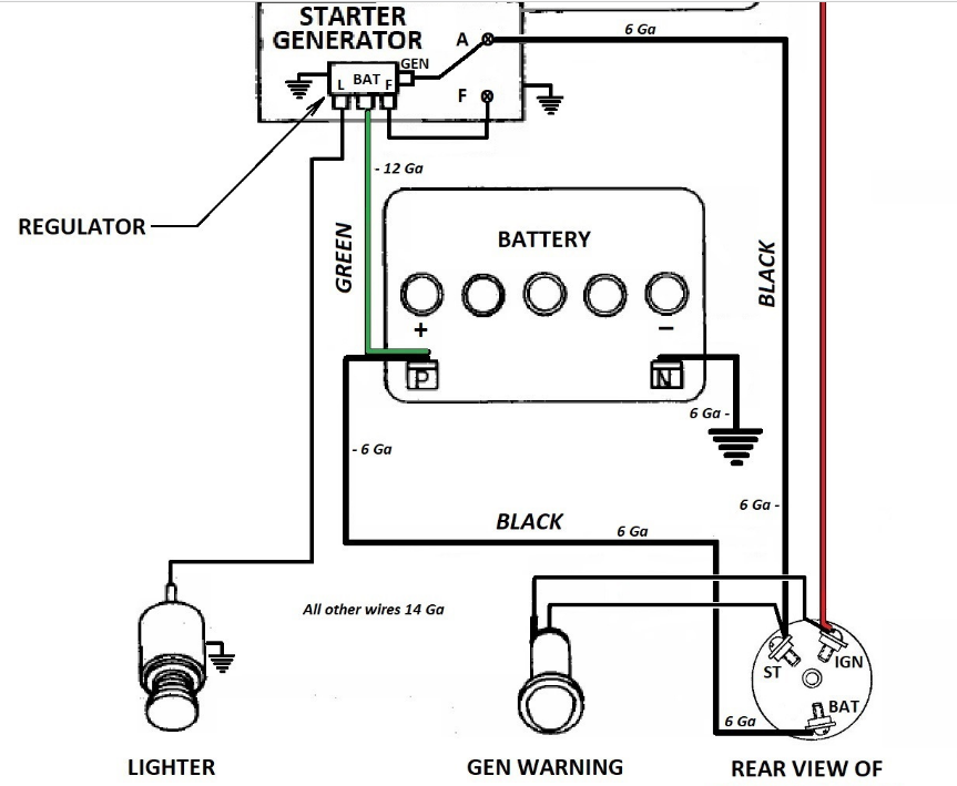

520hC-120 136 #1 Posted October 24, 2021 Just put a K301 in my 1055 puller. I rewired the whole system with the help of isavetractor’s wiring diagram for delco Rémy generator tractors. I have a new battery in the tractor which is the correct size U1. It has 12.5 volts. Very healthy battery I use it for my John Deere with a 23 horse twin Kawasaki and it turns it great. In other words the battery and wiring are fine. When I turn the key, the starter generator spins the motor to the next compression stroke, stops for 1-2 seconds, and spins it again until it reaches compression. With no belt on the motor spins very fast. I’m at a loss here. Ran into this with my K241 on another tractor too. And just today I had the oil pan off this K301 and the ACR (auto compression release) is working. IMG_0401.MOV 1 Share this post Link to post Share on other sites

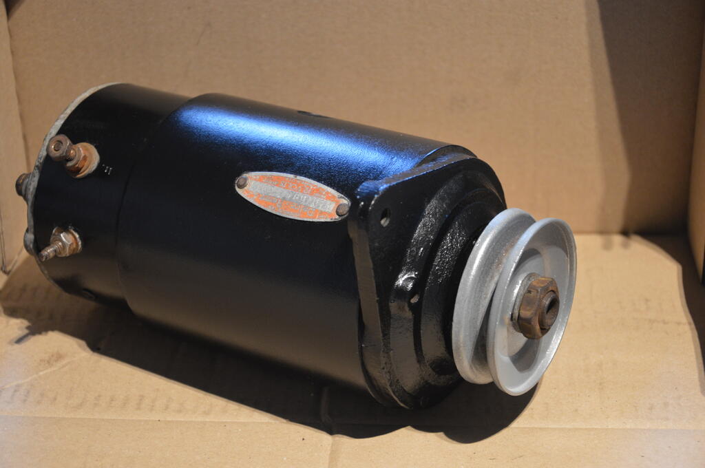

J854D 141 #6 Posted October 24, 2021 What first caught my eye in your video was the yellow starter/generator. Cub Cadet (yellow) starter/generators rotate the opposite direction from Wheel Horse generators. I can’t make out the model number on the generator tag in your video to verify it, but it appears to be spinning counter clockwise. The two Wheel Horse starter/generators that I have are listed as clockwise. Perhaps your generator is turning the engine over in the wrong direction. -JD- 1 Share this post Link to post Share on other sites
520hC-120 136 #7 Posted October 24, 2021 You’re totally right. I thought of it briefly but then forgot about it as I did with a couple of things during this swap. I have an extra generator off a wheel horse that I will put on and try. If I remember correctly, the extra generator I have did the same action. I will swap it tomorrow and let you guys know. Share this post Link to post Share on other sites
J854D 141 #8 Posted October 25, 2021 If you go to delcoremy.com and type in the model number of your generators it wil list the voltage, amperage and direction of rotation. Or just bench test it to see which way it motors. -JD- Share this post Link to post Share on other sites

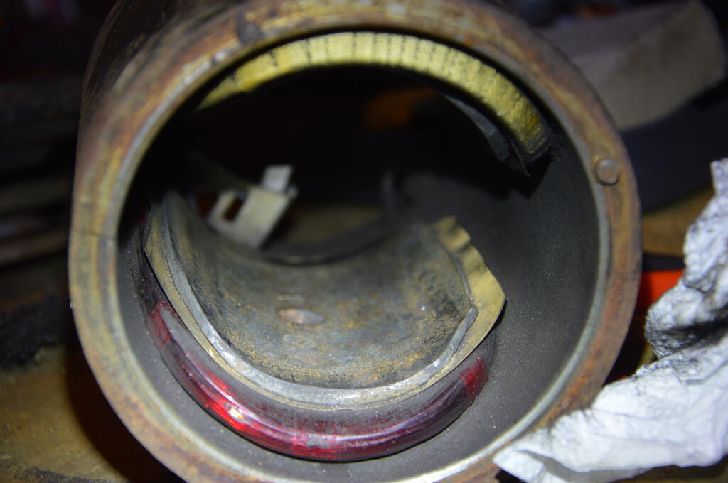

Maxwell-8 4,370 #9 Posted October 25, 2021 I had the same problem, I check the grounds, and sanded the well, which was an improvement. But I decided to open her up, since that is very easy on these. I cleaned it out good! the dust from the brushes is conductive, creating some kind of resistance i think. I also sanded the top copper armeture with a scothpad (this was before) and oiled the bearings And she works like she should now! 4 Share this post Link to post Share on other sites

gwest_ca-(File Mod) 11,854 #12 Posted October 25, 2021 One should wire wheel the ends of the housing and the ends of the end caps where they contact. That is the path to ground. Any well used starter will benefit from a new armature bushing or bushings. They only wear on one side resulting in an oval bore and that increases the rolling resistance. 1 Share this post Link to post Share on other sites

squonk 44,918 #15 Posted October 25, 2021 13 hours ago, J854D said: What first caught my eye in your video was the yellow starter/generator. Cub Cadet (yellow) starter/generators rotate the opposite direction from Wheel Horse generators. I can’t make out the model number on the generator tag in your video to verify it, but it appears to be spinning counter clockwise. The two Wheel Horse starter/generators that I have are listed as clockwise. Perhaps your generator is turning the engine over in the wrong direction. -JD- JD nailed it. Spinning the engine backwards. I didn't see the little movie thingy when I read the original post. Share this post Link to post Share on other sites
520hC-120 136 #16 Posted October 26, 2021 Update time, great news. I sanded both of the armatures and the field coils’ plates. New bearings, brushes and terminals. Cranks the motor fast and motor is running like a top. Only thing is I don’t believe it is charging. Battery is 12.4 volts when running. F terminal has .3 volts on it when running. A terminal has 2 volts on it when running. Did the classic test for these where you hook F terminal to ground and move positive to F to stop the motor but there is no change when I take the ground off of F. Are there any continuity checks to make sure F is connected to what it’s supposed to be in the motor? 1 Share this post Link to post Share on other sites

520hC-120 136 #19 Posted October 27, 2021 I used my Wheel Horse one. I rebuilt it as stated above. Voltage regulator is mounted on the inside of the tunnel underneath the tank. I will check the ground to it and make sure. I contacted pfrederi and got some good info from him. Will keep updating. Share this post Link to post Share on other sites
