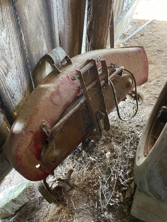

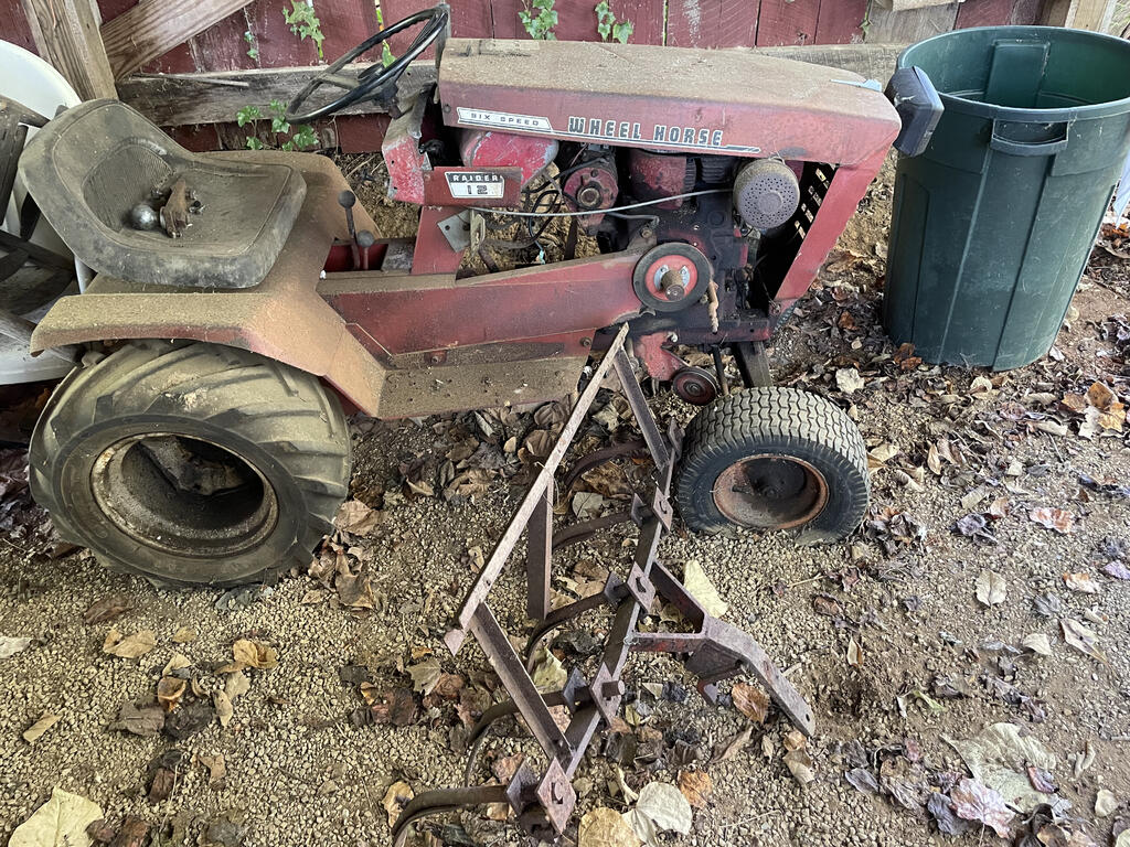

First post on this site. Any info would greatly be appreciated. Looking for information on this Raider 12, picture has model and SS#. It has a Kohler engine, mowing deck and cultivator. It was my parent’s and I used growing up mowing yards and plowing tobacco. Around 1990, dad replaced motor with original short block and replaced mower deck. Mower has not been used in 20 years, but the 3 blades turn freely. Tractor has been sitting in shed and not ran in 5 years. Motor turned over with jumper cables but did not start. The Cultivator plow has had some metal added to place Concrete block for weight, that dad and I added. I don’t know if I should sale for scrap metal or for someone to restore. Any recommendations?

Model number says it is a 1968.  It does have the #5060 10 pinion Li9mited Slip transmission.  I'm thinking you are in a catch 22...that is...it is not worth much not running, and if you got it running the memories are going to make you want to clean it up.  And then it becomes a keeper.  Ask me how I know??  My Dad had 4 Wheel Horses that I got running after he passed...now I have 5.  :occasion-xmas:

Thanks for all the feedback. I think I can get it running later this winter. If I do decide to sale I will Post something on this site. Thanks. Don
ohiofarmer
 You might get it running today. It already turns over with jumper cables.
  First test. Remove the air cleaner and spray a bit of carb cleaner into the carburetor. If it pops off, you have already proven that it has compression and spark. If there is no spark, remove the points cover and pass some sandpaper or a points file to clean up the points. You can also check to see if there is voltage at the coil before filing the points.
  If it does spark, do the first test again. Then disconnect the fuel line and use a slave tank with fresh fuel to the carburettor after checking  how much dirt is in the fuel bowl. Make sure to depress the clutch pedal when cranking the engine. My raider has a safety switch under the pedal.
  Those 12 horsepower engines are almost the ideal between fuel usage and power. Plenty of power to run a 42 inch deck
