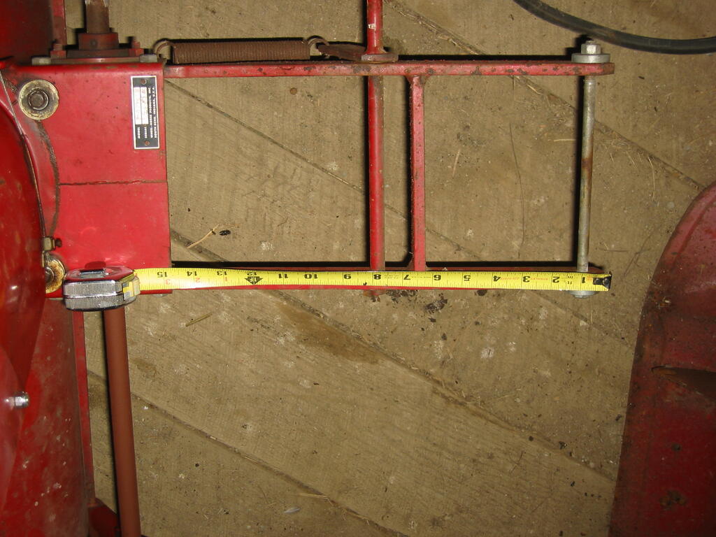

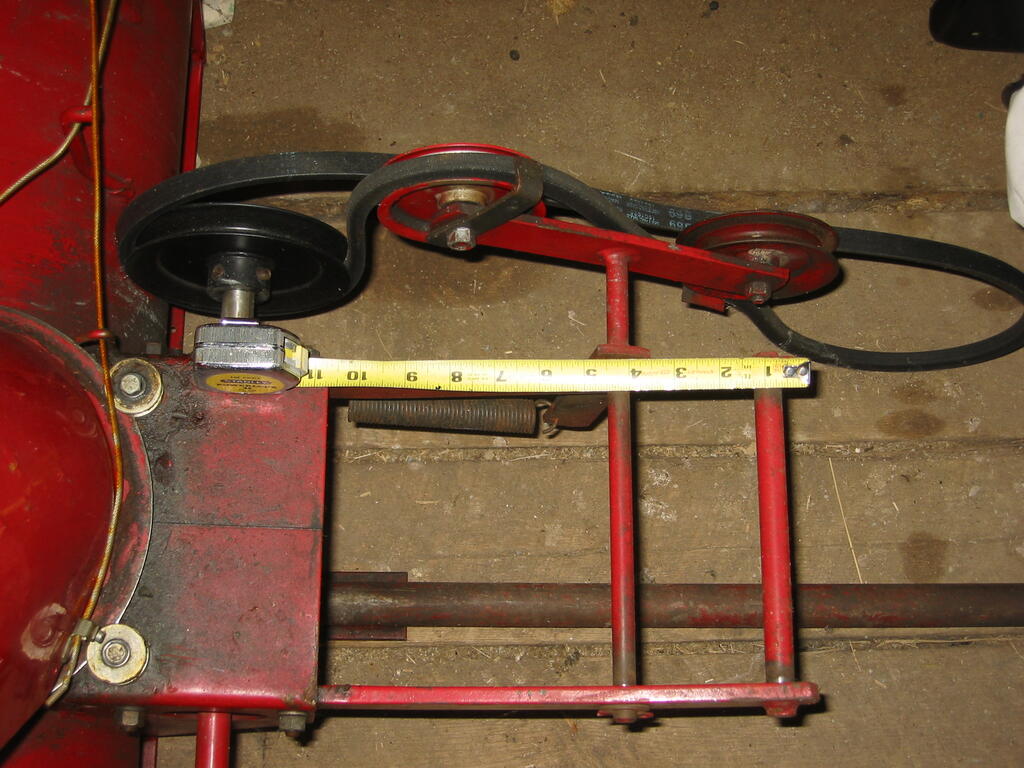

Jeff-C175 7,211 #6 Posted October 12, 2021 If you look through these two threads you will see what I had to do to get an older blower to work with my 'newer' machine: I had to modify the lift frame and the idler bracket. I don't know if you would have to do the same or not, but good info in the threads from various members. 1 Share this post Link to post Share on other sites
