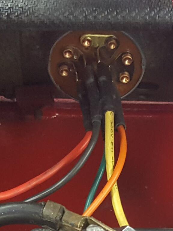

Gregor 4,848 #26 Posted October 13, 2021 I ran across this pic of my 141. You can get by without the plastic plug. I now have the correct terminal ends, and an open barrel crimping tool, At the time I did this tractor, I didn't have them. 1 Share this post Link to post Share on other sites

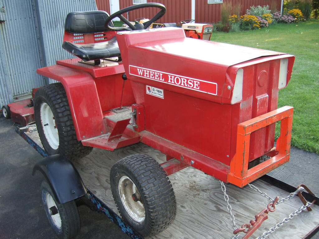

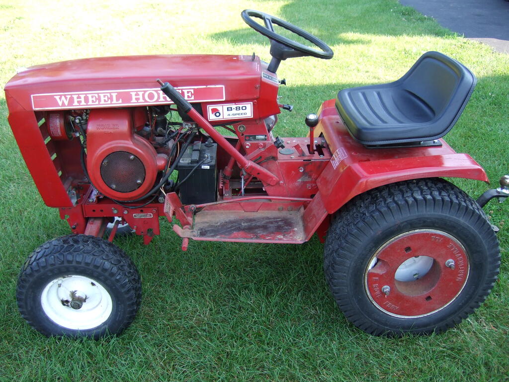

DarylJ 49 #31 Posted October 15, 2021 Here are a few pics of some of the WH's. A two or three aren't 8hp models. 1 3 1 Share this post Link to post Share on other sites
DarylJ 49 #32 Posted October 15, 2021 Couldn't fit them all into the above message. Here are more pics. 3 3 Share this post Link to post Share on other sites
ebinmaine 80,084 #33 Posted October 15, 2021 Excellent collection! Share this post Link to post Share on other sites
