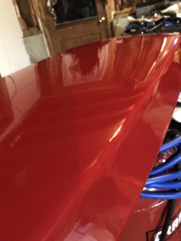

Lee1977 7,499 #7 Posted October 11, 2021 (edited) 40 minutes ago, Jeff-C175 said: Or the Horror Fright "purple gun". I painted my truck with a FH purple gun. I can't say all of them are good best to try it out on something else first. I did some primer first as I could sand it out. The gun did great the only problem I had was me, all the mistakes were mine. Edited October 11, 2021 by Lee1977 4 Share this post Link to post Share on other sites

Lee1977 7,499 #10 Posted October 11, 2021 (edited) 23 minutes ago, Jeff-C175 said: ... I can see is NO HANDRAILS? My HO insurance company would have a FIT with that! Truck looks great though! Sorry, They like my money! They did replace my roof last year it was 10,000 so I have got a little back. I didn't use cheap paint. It was $140 a quart with the thinner and hardner. I bought two of those guns. The one I used I could not get appart with out destroying it. I just cleaned the plastic can the sprayed lacquer thinner through it. I used it 6 or 8 different times. I had the bed and fenders off when I painted it. Edited October 11, 2021 by Lee1977 2 Share this post Link to post Share on other sites
