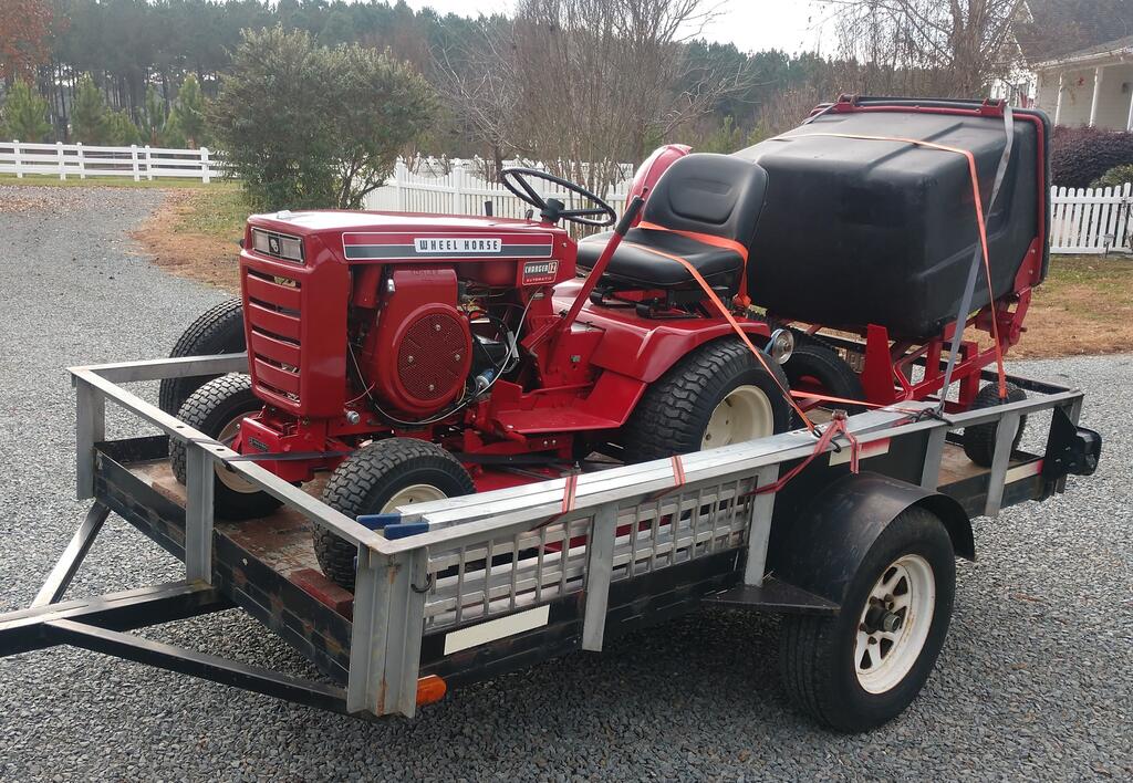

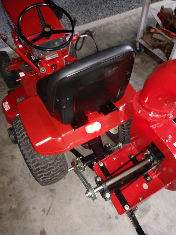

kpinnc 19,036 #101 Posted December 4, 2021 (edited) Took the Charger home today. Happy to say it worked like a champ! Now to get back to finishing the 523! Edited December 4, 2021 by kpinnc 4 3 Share this post Link to post Share on other sites

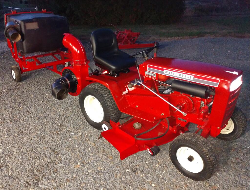

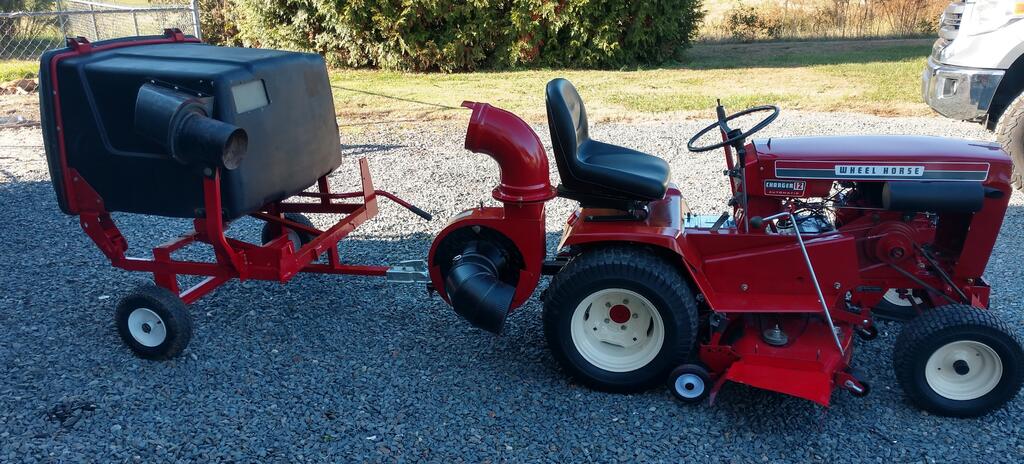

c-series don 12,609 #103 Posted December 5, 2021 (edited) @kpinncCan we please see more pictures of the whole setup? It looks awesome. Edited December 5, 2021 by c-series don 1 Share this post Link to post Share on other sites
kpinnc 19,036 #104 Posted December 5, 2021 2 hours ago, c-series don said: kpinncCan we please see more pictures of the whole setup? It looks awesome. I'll have to get some of it all together. As many as I took, I got nothing of the whole thing with the hoses hooked up like a big dummy. 2 Share this post Link to post Share on other sites

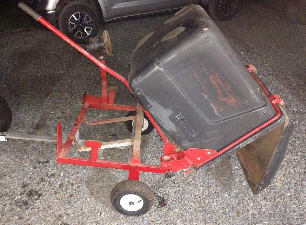

Jeff-C175 7,211 #105 Posted December 5, 2021 Just curious if you've thought about 'back pressure'? Is this the only air vent on the container? I guess that's a screen of some sort over the hole? I wonder how much more suction you would get with a bigger vent... Share this post Link to post Share on other sites
kpinnc 19,036 #106 Posted December 5, 2021 (edited) 1 hour ago, Jeff-C175 said: I wonder how much more suction you would get with a bigger vent... Actually that is the plexiglass window that allows you to see when it's full. It's just really dusty in that pic. Sorry for the lack of detail. I really wish I had better pics of the dump bin. I'll get some next week if I remember. The entire back door (about 3x4 feet) is double walled with the inner being mesh. The air is ducted out the bottom of the door towards the ground. Basically the entire door is one big vent on the bottom. In all seriousness, this thing will pick gravel up off the ground even with the deck disengaged. I had to go bigger on the pulleys to bring the RPMs down to about 4K. The impeller turns slightly faster than the engine, because I know my FIL rarely runs his old Kohlers above about 3/4 throttle. He's not big on letting them idle, but babies them quite a bit. Edited December 5, 2021 by kpinnc 2 1 Share this post Link to post Share on other sites

Horse Newbie 7,405 #113 Posted December 6, 2021 On 12/5/2021 at 9:03 AM, c-series don said: @kpinncCan we please see more pictures of the whole setup? It looks awesome. I was gonna ask that too ! Share this post Link to post Share on other sites
Horse Newbie 7,405 #114 Posted December 6, 2021 On 12/5/2021 at 12:14 PM, kpinnc said: I'll have to get some of it all together. As many as I took, I got nothing of the whole thing with the hoses hooked up like a big dummy. Is that a homemade set up ? Share this post Link to post Share on other sites
kpinnc 19,036 #115 Posted December 6, 2021 18 minutes ago, Horse Newbie said: Is that a homemade set up ? Yes and no. More accurate to say "adapted" from other stuff. The bin is from a Kubota zero turn. I used it for years, but not mounted on a trailer, so that part is my work. I just don't need leaf pickup anymore, so I made it to work with the Charger. 1 1 Share this post Link to post Share on other sites

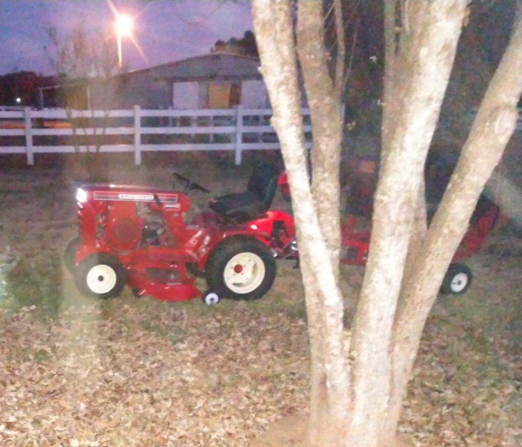

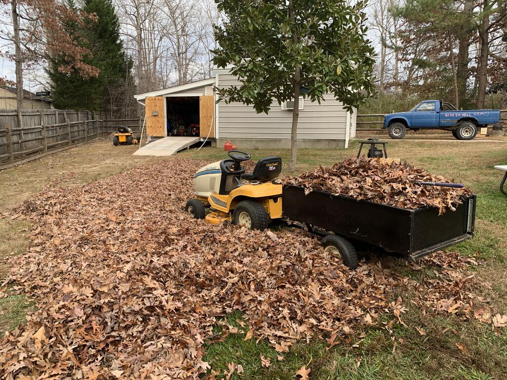

Horse Newbie 7,405 #119 Posted December 18, 2021 On 12/6/2021 at 2:42 PM, kpinnc said: I just don't need leaf pickup anymore Why ?… no trees ?… I spent a ton of money getting 10 White Oaks cut down last May. Had to evict a momma coon and 2 babies. Anyways now I get up my neighbors leaves… All these and more come from Sherwood Forest next door. 1 1 Share this post Link to post Share on other sites
SylvanLakeWH 32,778 #120 Posted December 18, 2021 @Horse Newbie … uhm, just sayin, if your tractors were the correct color - - those leaves would blow the other way out of shear terror… 3 Share this post Link to post Share on other sites
Horse Newbie 7,405 #121 Posted December 19, 2021 1 hour ago, SylvanLakeWH said: @Horse Newbie … uhm, just sayin, if your tractors were the correct color - - those leaves would blow the other way out of shear terror… Look closely in the stable with the two doors flung open… a in there ! Notice no leaves fell near the stable ! I had those off-color tractors before I discovered ‘s, and besides, I need some cut-rate equipment to do menial tasks while I save the thoroughbred’s for the Triple Crown ! 1 1 Share this post Link to post Share on other sites
