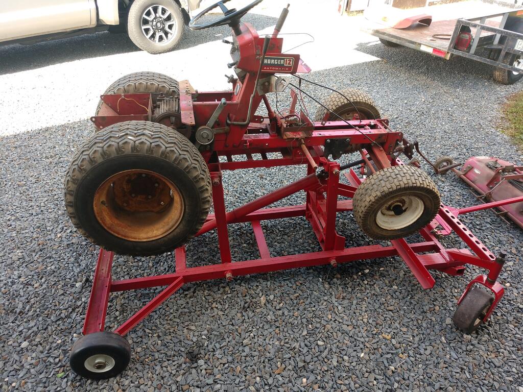

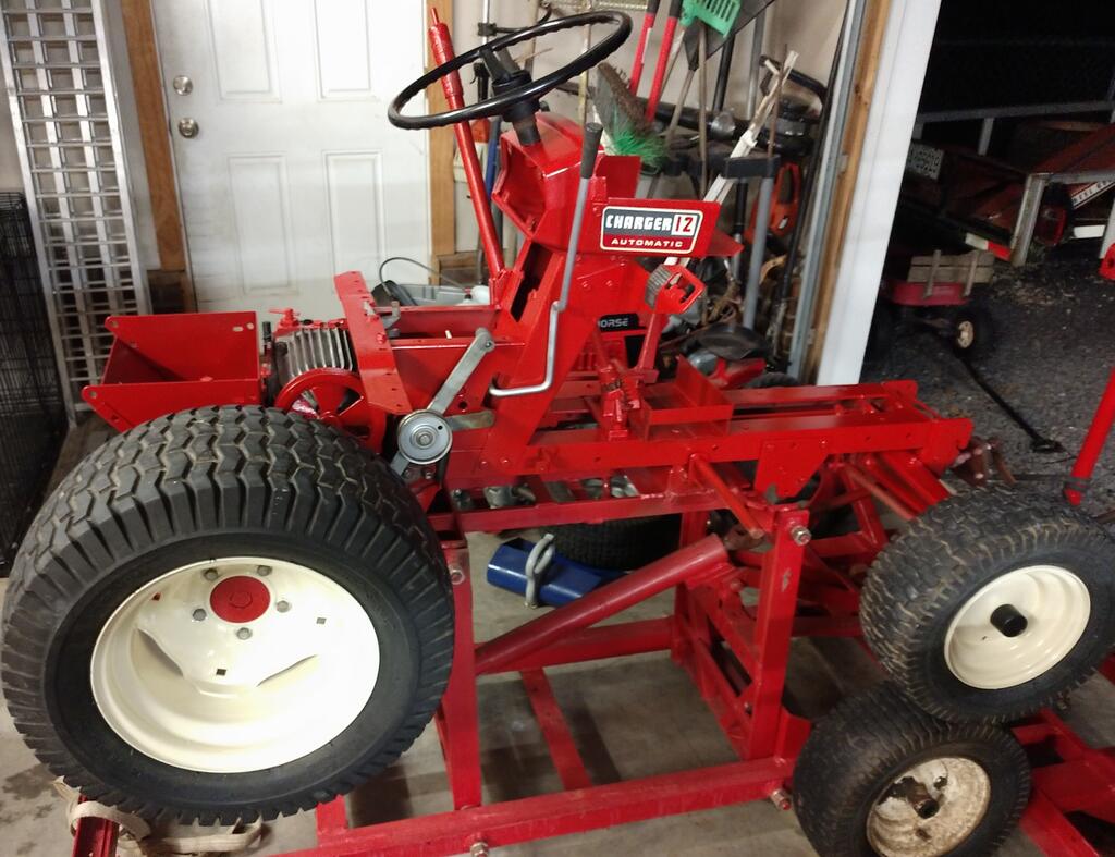

kpinnc 18,756 #1 Posted October 11, 2021 I've been working on a leaf vac for my father in law, and he decided to put in on his Charger 12. That actually will be the easier of the two tractors he has for the belt routing anyway, because the other is a 416-8. So I go to pick up the tractor, because I've done all I can without the tractor itself, and he had basically taken it apart to clean it up, and he had a K321 he wants to put on it as well. So what you see below is what I'm starting with, but no major mods and I'm just getting it all together and "touched up". Did I mention I have too many projects? 2 Share this post Link to post Share on other sites

oliver2-44 11,632 #3 Posted October 11, 2021 Nice of him to help you with the disassembly. Looks like your almost finished, he just left you with the simple things, rear wheel hubs and the steering wheel. 3 Share this post Link to post Share on other sites
kpinnc 18,756 #4 Posted October 11, 2021 2 hours ago, oliver2-44 said: Nice of him to help you with the disassembly. Looks like your almost finished, he just left you with the simple things, rear wheel hubs and the steering wheel. Oh we ain't taking either off on this project. This one is gonna be quick. As a friend of mine said once, it's gonna be a 10 footer! 1 Share this post Link to post Share on other sites

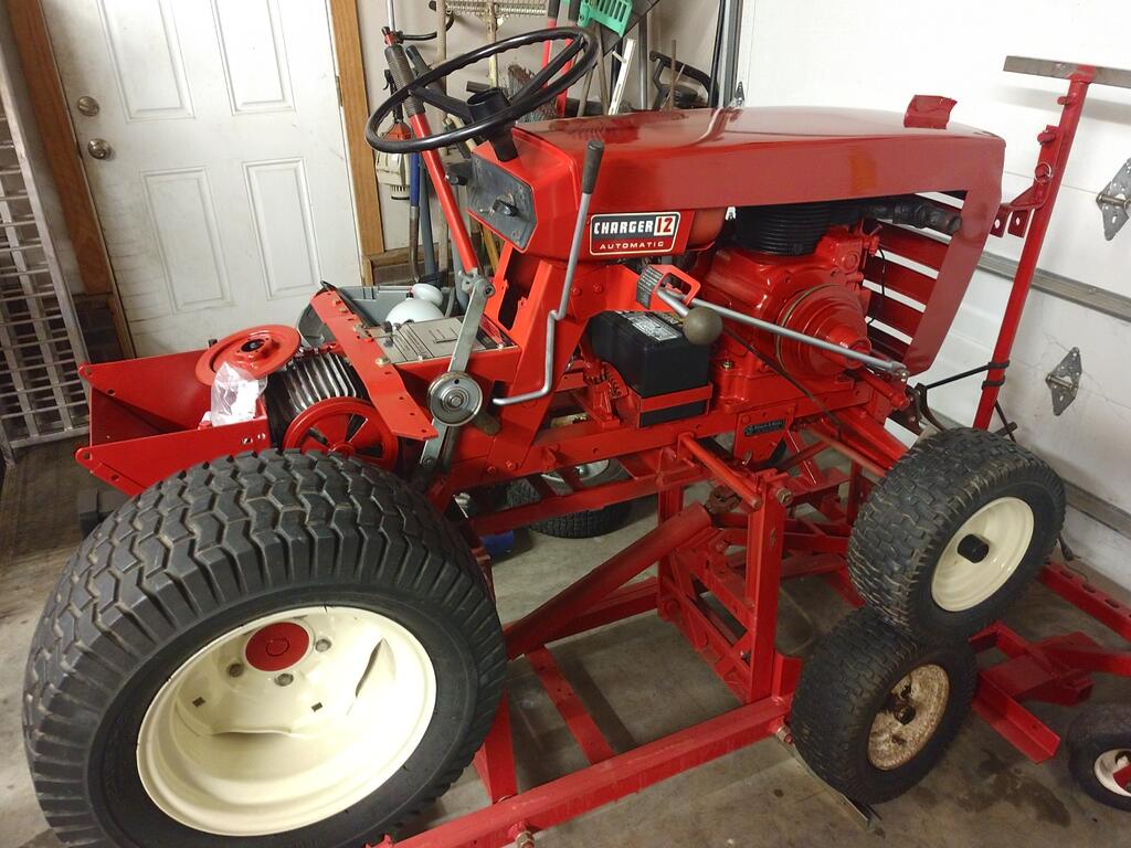

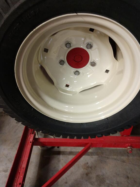

kpinnc 18,756 #12 Posted October 12, 2021 (edited) In the spirit of improving the performance of this machine by painting it, I've started a quick "refresh" with rattle cans. I have a leftover set of decals, so it should look decent when finished. It helps alot when it was pretty much disassembled and pressure washed when I got it... Not bad for one afternoon... Did I mention I have too many projects? Dang I need a warehouse! Edited October 12, 2021 by kpinnc 5 Share this post Link to post Share on other sites

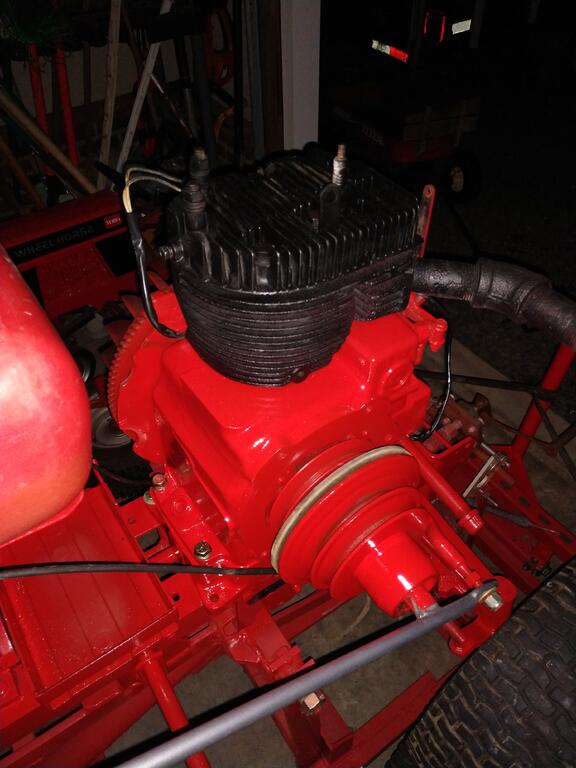

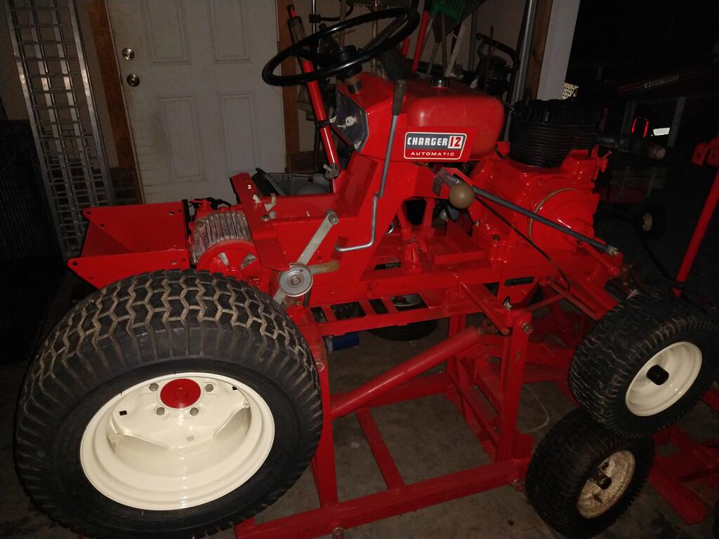

kpinnc 18,756 #13 Posted October 13, 2021 (edited) Got the engine painted and bolted up. I forgor how bleeping heavy an old cast iron Kohler is- especially when you try not to booger the paint! I know it looks funny, but I always put stove paint on the cooling fins. Edited October 13, 2021 by kpinnc 5 Share this post Link to post Share on other sites

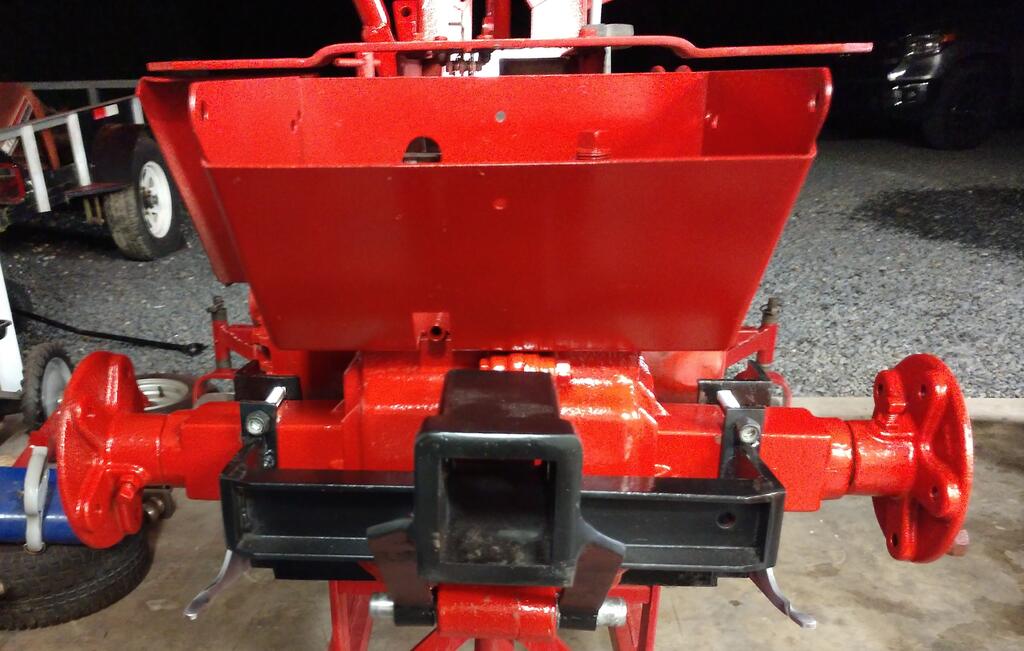

kpinnc 18,756 #15 Posted October 15, 2021 (edited) Found some more paint! So I got a few more items painted today. The hood looks like crap, so it's getting another coat tomorrow. The other parts cleaned up very nice. Then I realized the tower is a completely different red than the rest, even though its all the same stuff. Too late to turn back now, it will just have to look like it does. Edited October 15, 2021 by kpinnc 1 Share this post Link to post Share on other sites

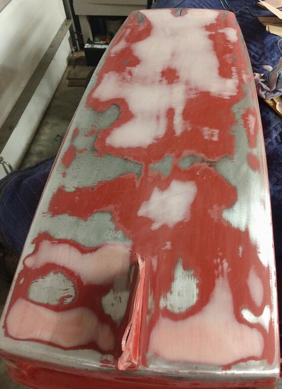

kpinnc 18,756 #18 Posted October 16, 2021 I glazed the hood tonight just so I can get rid of the deep scratches and dimples. I should have done this in the beginning, but rushed and now I'll have to back up and punt... I did it to myself! 1 Share this post Link to post Share on other sites
Jeff-C175 7,209 #19 Posted October 16, 2021 8 minutes ago, kpinnc said: glazed What dat duz mean? " glazed " ? 1 Share this post Link to post Share on other sites
Lee1977 7,710 #20 Posted October 16, 2021 6 hours ago, Jeff-C175 said: What dat duz mean? " glazed " ? Glazing putty comes in a tube like tooth paste. 1 Share this post Link to post Share on other sites
Jeff-C175 7,209 #21 Posted October 16, 2021 (edited) 3 hours ago, Lee1977 said: Glazing putty comes in a tube like tooth paste. Maybe I know it as "Red Lead" ? Is that what it means? Hey, look! It says "GLAZING" right there on the package! Doesn't say anything about LEAD at all! I think in the 'olden days' it did and that's why we called it 'red lead'. I think I would have waited for the paint to cure before putting that stuff on also... Edited October 16, 2021 by Jeff-C175 1 Share this post Link to post Share on other sites
kpinnc 18,756 #22 Posted October 16, 2021 That is the exact stuff. I'm gonna block sand it and wait a couple days before repainting. Very little compound will be left- just in the scratches and pits. It isn't a full covering, because I'll take it back almost to bare metal agian. 2 Share this post Link to post Share on other sites

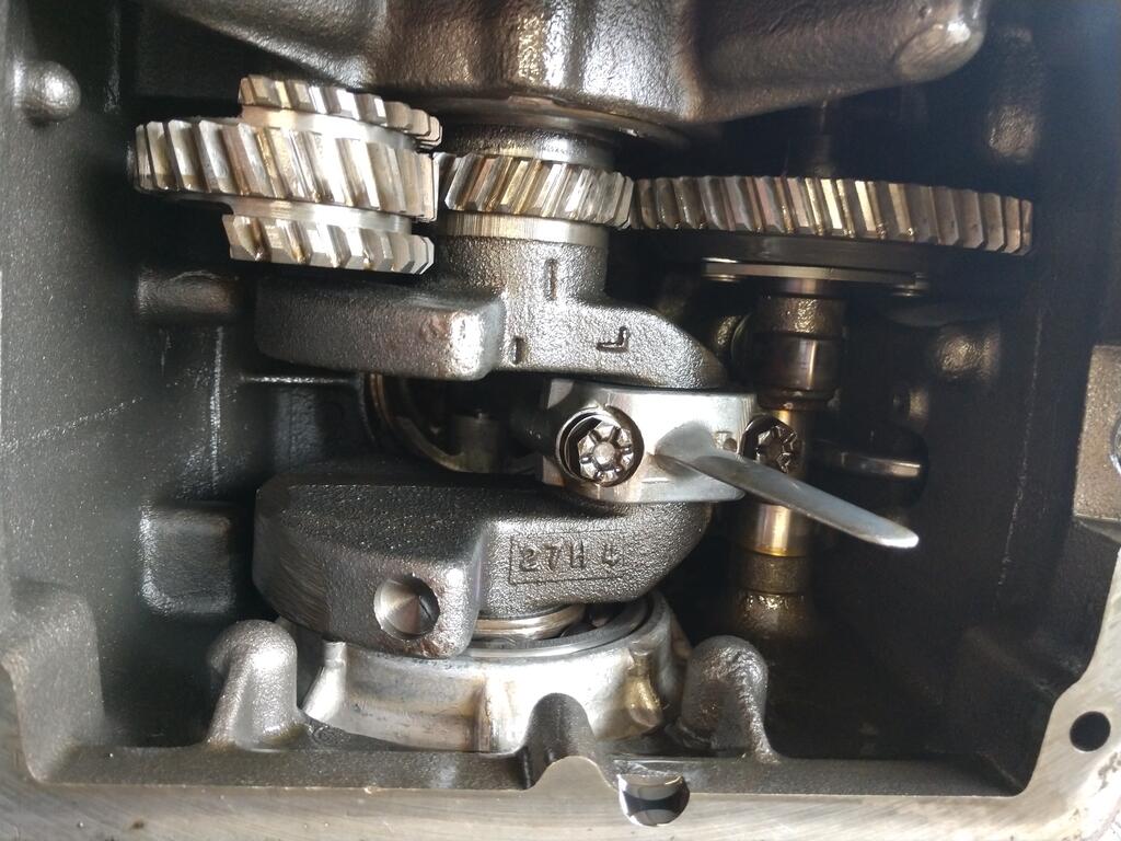

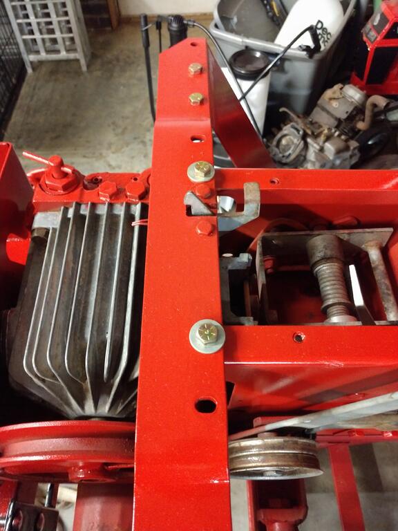

kpinnc 18,756 #23 Posted October 18, 2021 (edited) Did something I've never done before on this one: I left balance gears intact. I tried to get to the top one first with my clip plier thingys (I have about a dozen different sizes), and could not reach the clip. No way I was gonna touch the bottom one without ensuring I could get the top first... I just don't have time in this to do a full teardown. The only reason I opened it this much was to drill and tap the oil pan for the frame bolts. This engine was never on a Wheel Horse before. The inside of the engine looks great. I know he babies his engines (35 years as a diesel mechanic), and services them religiously but this is really bugging me! Edited October 18, 2021 by kpinnc 1 Share this post Link to post Share on other sites
Lee1977 7,710 #24 Posted October 18, 2021 (edited) I busted mine off could not get keeper or bearing off the second one so I left it. With the gear gone don't believe it can cause any trouble. Edited October 18, 2021 by Lee1977 1 Share this post Link to post Share on other sites
kpinnc 18,756 #25 Posted October 20, 2021 (edited) I have sanded this summa***** until I can't leave fingerprints anymore, not to mention feel my hands. And I'm still nowhere near ready for paint. Maybe half way... Oh well, happiness is red in your snot rag! Gonna set it in the sun tomorrow, and final sand and do it again the next day before priming. What a flipping pain! Edited October 20, 2021 by kpinnc 2 Share this post Link to post Share on other sites
