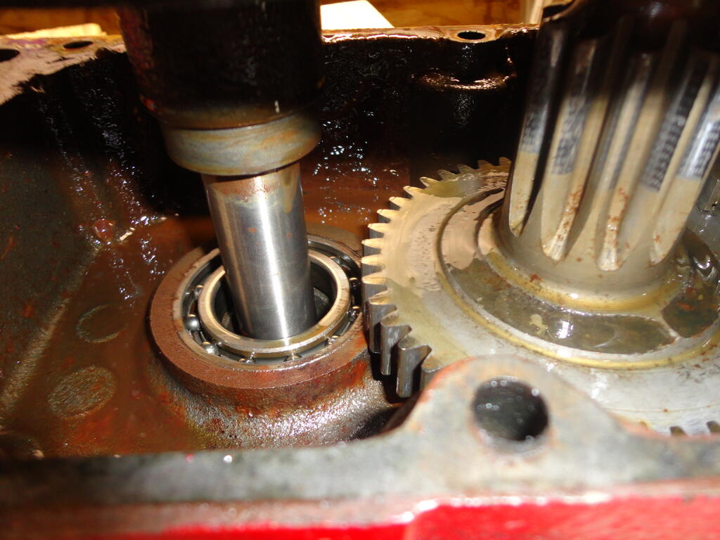

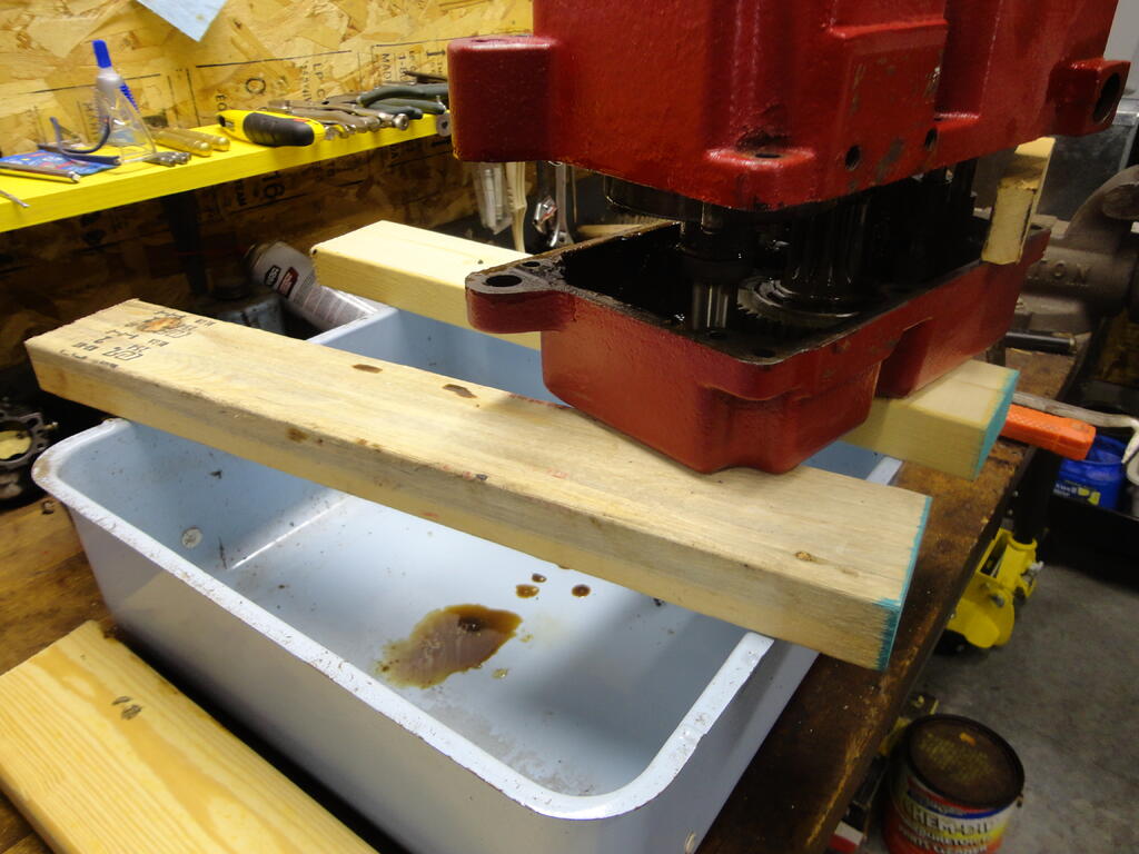

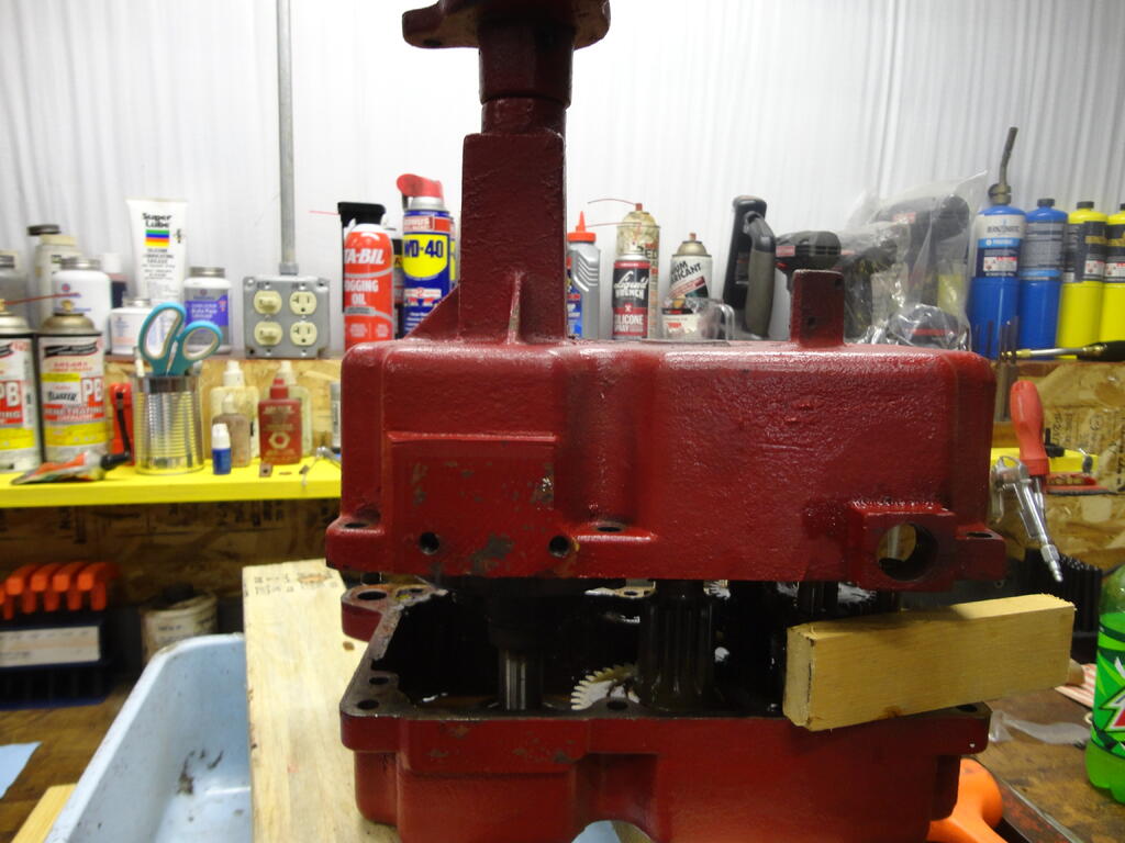

Moparfanforever 926 #40 Posted October 8, 2021 (edited) SOOOOOO , i couldn't stand it and started working on the trans this evening. I had this metal pan out of an old fridge and used these 2x4's under the trans and the combination worked perfect. BUT , i can get the half of the case as high as the drive pulley shaft and that is as far as it wanted to go , and i didn't want to try to force it any farther without asking on here. The hub is stuck on the axle but good , i hope that isn't what is keeping the case from coming off because the axle will have to go in the press to get the hub off. The good thing is there was very little water in the oil that was left in the trans and no rust that i can see so far !! Well, no really bad rust. Is the hub holding me up from getting the case off or do i have to get angry with it ??? Also , the big bearing in the case on the side that the axle wouldn't turn looks perfect and rolls eeeeeasy. At least that is not the problem. Edited October 8, 2021 by Moparfanforever added context 1 Share this post Link to post Share on other sites
953 nut 65,344 #41 Posted October 9, 2021 1 hour ago, Moparfanforever said: The hub is stuck on the axle but good , i hope that isn't what is keeping the case from coming off You will need to get that hub off. A bottle jack, some long bolts and another hub or sheet of 1/4" steel can make a hub behave. Share this post Link to post Share on other sites
squonk 46,161 #42 Posted October 9, 2021 Can you grab that axle and turn it now? Thinking maybe that axle was stuck in the differential carrier. (Rust around the axle where it exits the carrier) Share this post Link to post Share on other sites
Moparfanforever 926 #43 Posted October 9, 2021 Yep , the axle will turn now with the cases apart. I guess that is kinda good ?? I tried to get the hub off the way 953 Nut has pictured with a two ton bottle jack and the hub is not having it , still won't budge. If there is not a workaround to get the cases apart , I think the only thing I can do is cut a chunk out of the hub or a slot in it and wedge something in the slot ?? I am not an original kind of person , so i do not mind putting newer style hubs on if i can't find a three bolt hub. Wifey says we are mowing today , so that will blow most of my day , UGH. I have a transmission to get apart !! 1 Share this post Link to post Share on other sites

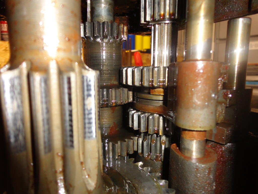

Moparfanforever 926 #45 Posted October 9, 2021 6 minutes ago, squonk said: Since,cents scents I have never been inside one of these transmissions, I a$$umed the axle rode on that outer brg. But I see what I would call the differential carrier rides there. I think the axle is stuck or was stuck in that carrier. That would still allow the other side to rotate when jacked up. Could be the rust on the axle causing the problem. To the necked eye , it doesn't look bad in there , but the camera sure does see it . I want to take it all apart anyhow and clean everything , no turning back !! Share this post Link to post Share on other sites
squonk 46,161 #46 Posted October 9, 2021 I think there is enough rust in there that you want to check every bearing. Share this post Link to post Share on other sites

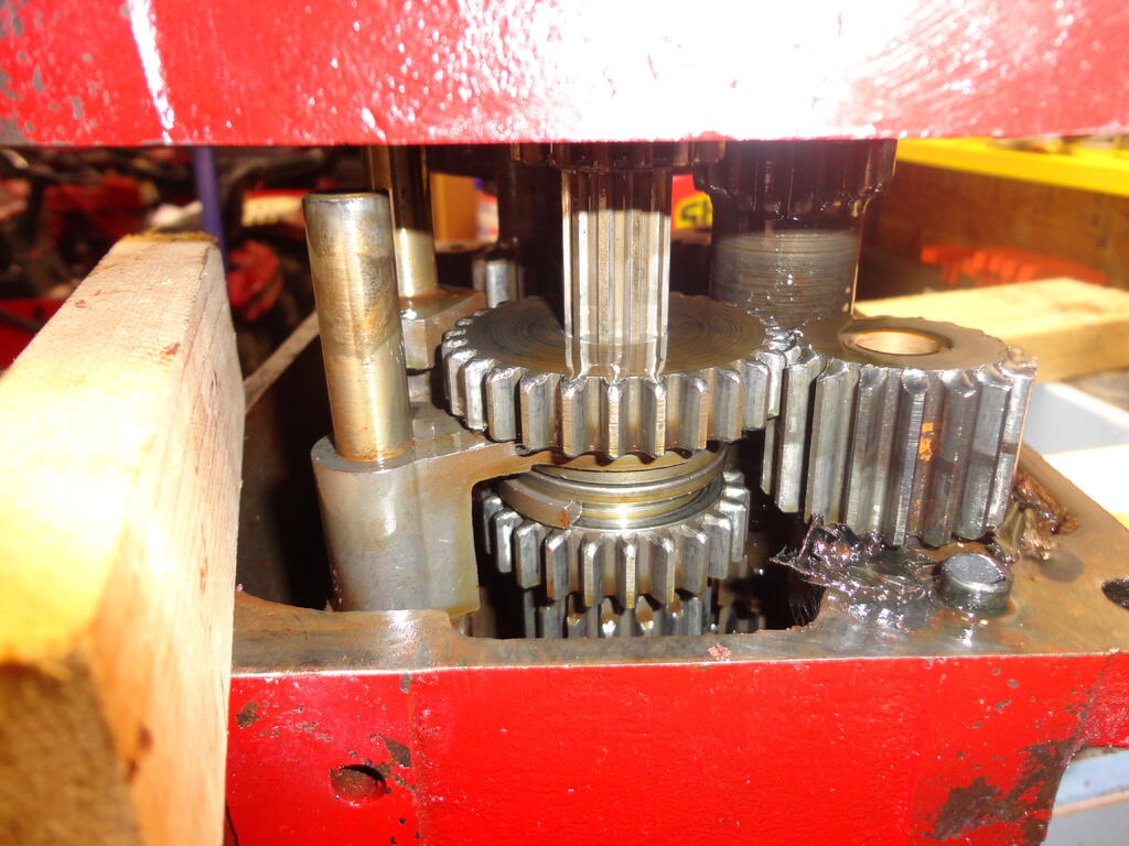

stevasaurus 23,662 #47 Posted October 9, 2021 1st, the 1533 ball bearings were never the problem...the differential sets in those bearings and the differential was OK and turned. 2nd, that rust you see on the axle does nothing but look like rust. That end of the axle rides in the axle gear and is held in place by the pinions. (and we know the pinions were turning) It almost has to be the right side outer needle bearing. Can you get the other hub off??? If you can, you can pull off the deep half with the differential stuck in that side. Another option is to get that differential back in place and try to loosen and take out the 4 bolts holding the differential together...if you can get your hands and a wrench in there. The 3rd option is to take a 4" grinder and carefully cut 2 slots down the length of the stuck hub. You do not have to go all the way through, just close. Take a chisel and hammer and the cast metal will snap apart. On a lighter note, I really understand starting this last night. These transmissions are so easy to work on (once you get the hubs, & pulleys off) that it can drive you nuts trying to figure out what the heck is wrong. 1 Share this post Link to post Share on other sites

stevasaurus 23,662 #49 Posted October 9, 2021 BTW...all of the inside gears look great. Change the seals, and maybe 1 or 2 bearings, clean it out and put it back together. Share this post Link to post Share on other sites
