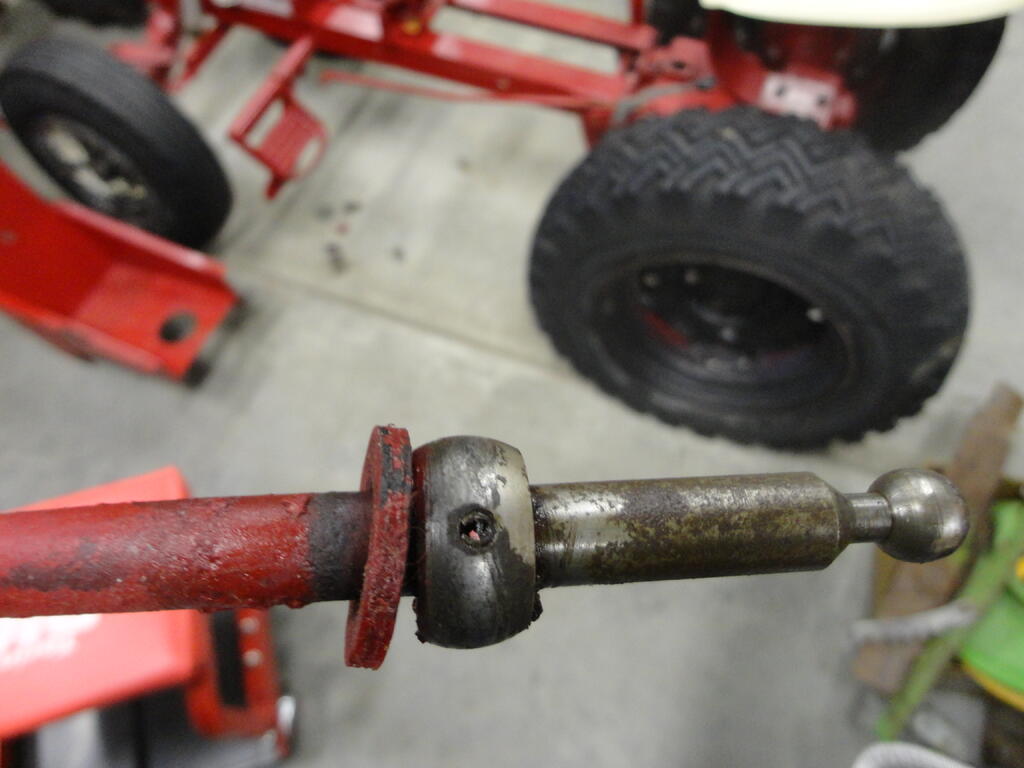

Moparfanforever 933 #1 Posted October 6, 2021 I brought a 702 roller home probably five or six years ago and tore it down and painted most of it and drained the oil out of the transmission , fortunately there was no water in the trans. The tractor would be in neutral and roll around just fine , but the shifter flopped around like a dashboard hula girl on a bumpy road. It has sat all this time in my garage unmolested until today , and i went to move it and the pass. side wheel/tire will not roll ?? The left side tire will roll just fine with no sound from the trans. and the shifter sounded like it went into all gears , but it must be in gear ?? The input pulley turns with no resistance. i took a couple of pics. of the shifter and the roll pin is intact and i see no wear on the ball. Tried to get a pic into the trans. but my camera wouldn't get a good pic , but the trans looks like it is in neutral, the square blocks are not off center , if that makes sense. Anyone have an idea what might have happened just sitting all these years ?? Thanks !! Darrell Share this post Link to post Share on other sites

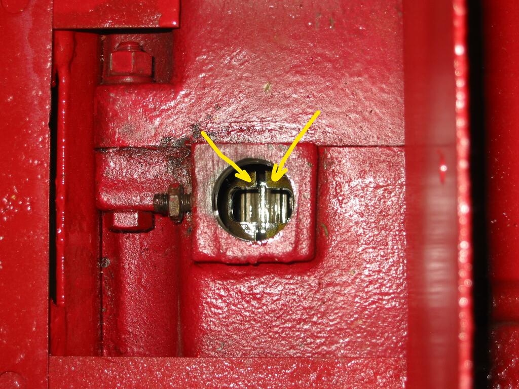

gwest_ca-(File Mod) 12,419 #9 Posted October 7, 2021 12 hours ago, Moparfanforever said: the shifter flopped around like a dashboard hula girl on a bumpy road. She may be dancing because the spiral pin that locks the donut to the shifter is sheared allowing the donut to turn on the shifter. Have you tried shifting the rails with a long screwdriver? Share this post Link to post Share on other sites
Moparfanforever 933 #10 Posted October 7, 2021 42 minutes ago, gwest_ca said: She may be dancing because the spiral pin that locks the donut to the shifter is sheared allowing the donut to turn on the shifter. Have you tried shifting the rails with a long screwdriver? I don't think the roll pin is sheared , pics above it is still there , but I will check. Never messed with one of these trans before , how do you shift the rails with a long screwdriver ?? I am going to go out and cuss at it some more and see if I find anything out. Thanks for all the help !! Share this post Link to post Share on other sites
squonk 47,798 #11 Posted October 7, 2021 Right side bearing frozen. Differential action will allow the opposite side to turn. Same as making a hard right turn. Share this post Link to post Share on other sites

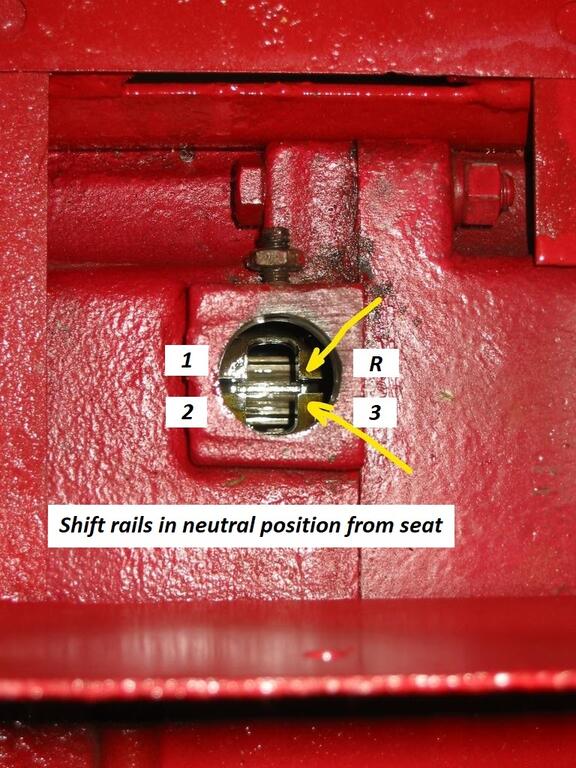

gwest_ca-(File Mod) 12,419 #12 Posted October 7, 2021 If the blocks on the rails are centered in the hole that is neutral. Using a screw driver shift the front rail (R & 1) left-(1) and right-(R) to select a gear. Bring front rail back to neutral and try the rear rail (2 & 3). Sliding rail to left-(2) and right-(3). One of the rails must always be centered-(N position) If both rails are centered the transmission is in neutral-(N) Share this post Link to post Share on other sites
pfrederi 21,005 #13 Posted October 7, 2021 Use a big screw driver and move the U shaped forks till they line up like this... 1 Share this post Link to post Share on other sites
gwest_ca-(File Mod) 12,419 #14 Posted October 7, 2021 1 Share this post Link to post Share on other sites

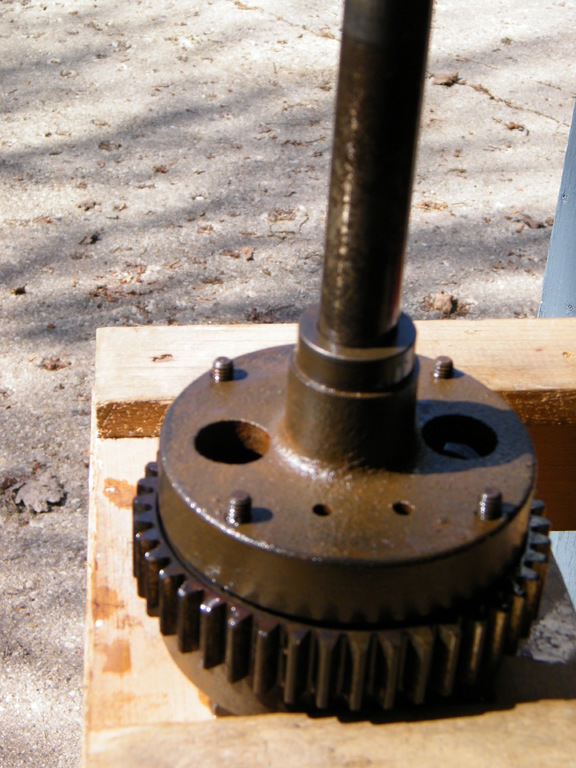

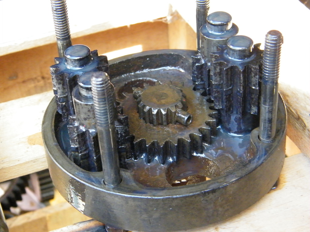

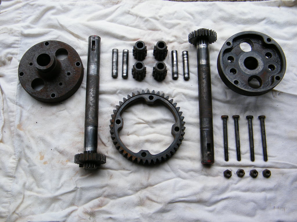

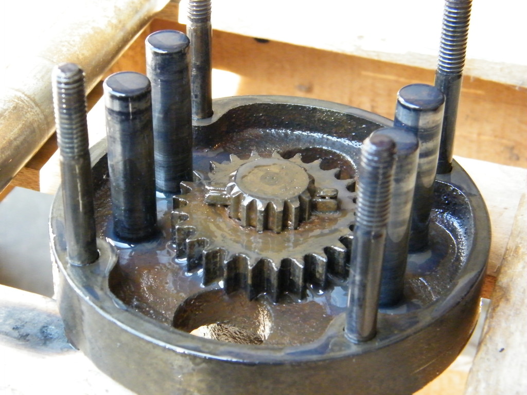

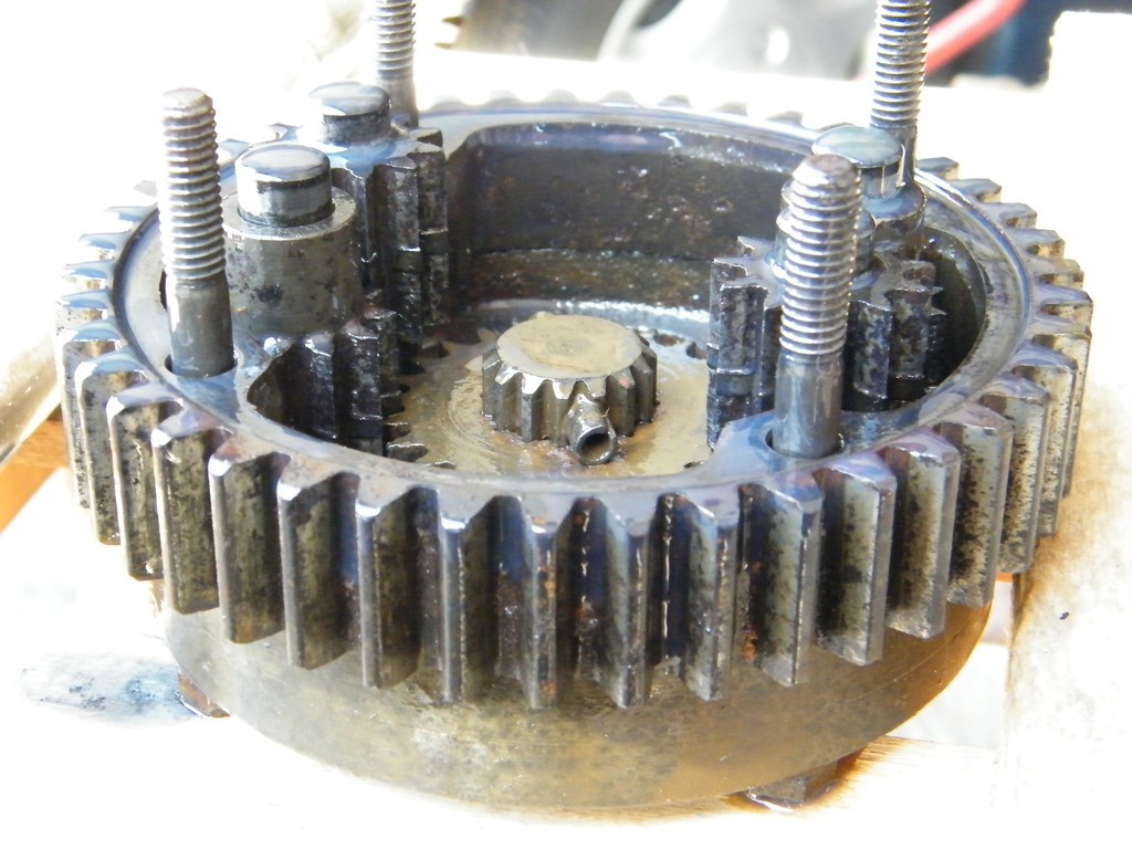

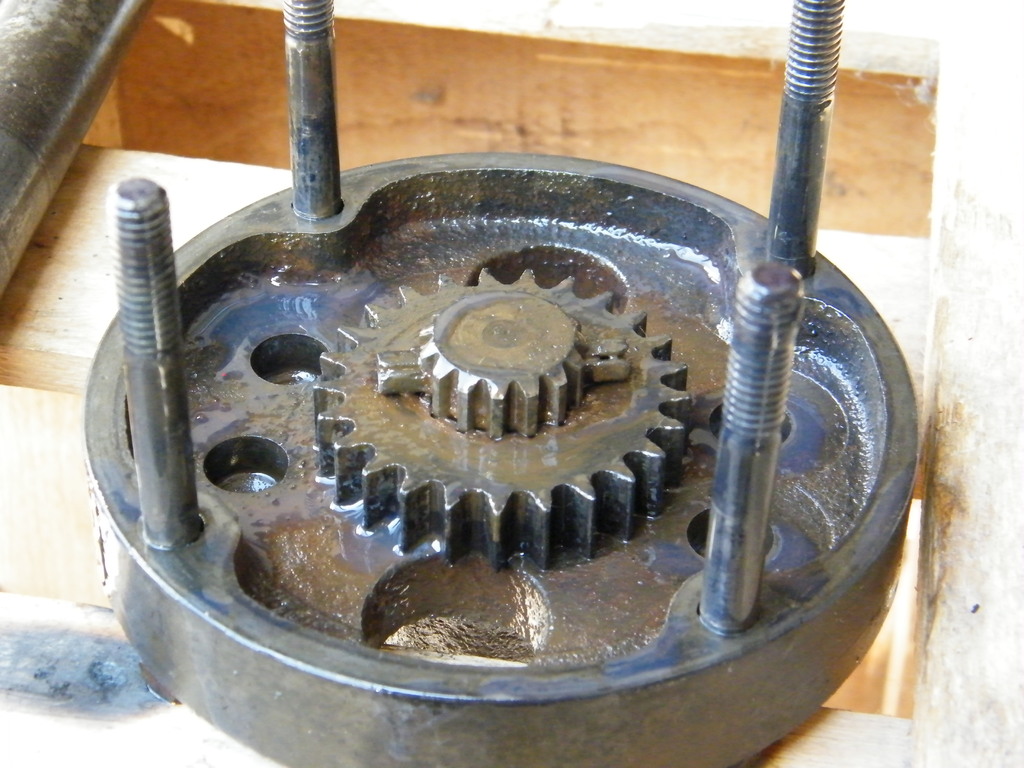

stevasaurus 23,786 #23 Posted October 8, 2021 OK, trying to figure out what you said: (1) in neutral, turn left and right does not move. You could turn the left tire though?? (2) in gear, turned input shaft...brake drum and left tire turned, but not right. My thoughts...your differential turns, all gears leading to differential are OK. At least the pinions working the left tire are OK. Possibilities...no pinions in differential for right axle...no teeth on right axle gear...broken right axle...and a froze bearing. Teeth on right tire pinions are stripped and jamming the right axle gear. This picture shows all the parts of a differential like yours. Use this thread for the videos. This trans is basically the same, just brake drum is on cluster gear shaft instead of mushroom gear. Share this post Link to post Share on other sites
