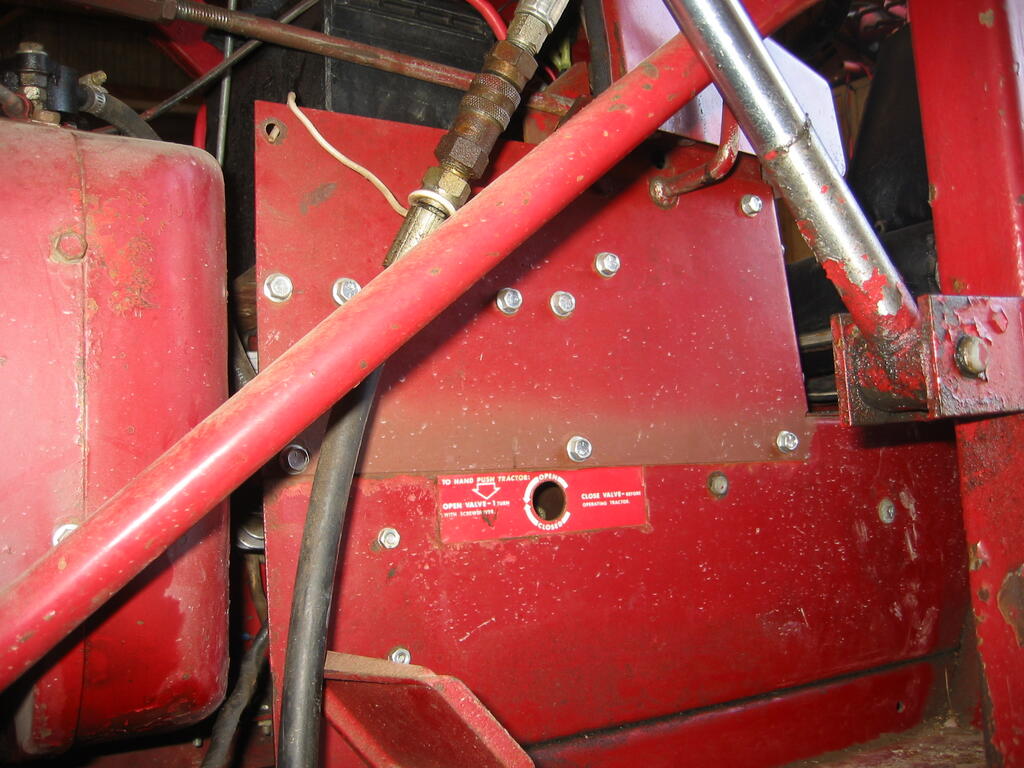

pacer 3,180 #9 Posted October 5, 2021 1 hour ago, nohasslekindaguy said: where is the release valve? Sitting in the seat - on the left side panel below and about inline with the battery is a round hole maybe 3/4-1" - peep inside there (prolly need a flashlight) and should see one of 2 types (that I know of) One is a square head and other takes a flat blade screwdriver - the square head will take a 3'8" ratchet extension. There should? be a decal, but all too often is missing. To release turn counter clockwise about I turn, tighten clockwise till snug. They are rather notorious for being stuck in the closed position, The screwdriver type is bad about getting ... wallowed? out and cant get a grip on. I've had 2 D's that only way I got them loose was to remove the unit. Share this post Link to post Share on other sites

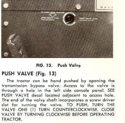

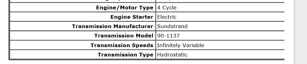

Gregor 4,848 #11 Posted October 5, 2021 Not much available for a '74 D series tractors as far as manuals. I did find this for a '75. They both appear to have a Sundstrand 90-1137 hydro unit, so maybe this pic is accurate for the '74 also. I have never seen one, but it looks like what @paceris describing above. Not much to go on, but it's all I can find. Share this post Link to post Share on other sites
8ntruck 9,328 #12 Posted October 5, 2021 What kind of hydro unit is on the tractor? If it is an Eaton 11 series, you can push the tractor in neutral - but only at a slow walking speed. If the hydro is a Sunstrand, it will have a tow valvethat must be opened to prevent internal damage from moving or pushing the tractor in neutral. Disclaimer - I have owned an Eaton 11 series for about a month. I've never been inside of it. My knowledge of Sunstrands is book knowledge only. Share this post Link to post Share on other sites
Gregor 4,848 #13 Posted October 5, 2021 (edited) Again this info is for a "75 D-200, so I can't say it's accurate for a "74. Edited October 5, 2021 by Gregor Share this post Link to post Share on other sites

pfrederi 21,215 #18 Posted October 6, 2021 Parking brake has nothing to do with the free roll issue. It activates the parking pawl in the transaxle. Make sure the tow valve is closed (Pic) Does the tractor have good power forward and backward. if you put it up against a solid object will she dig holes with the rear wheels when you try to push it??? (Try this both forward and backwards) If it doesn't dig in then your hydro is worn. if it will only in one direction then there are other possibilities. Download the sundstrand manual here and look at the diagnostic pages Share this post Link to post Share on other sites
