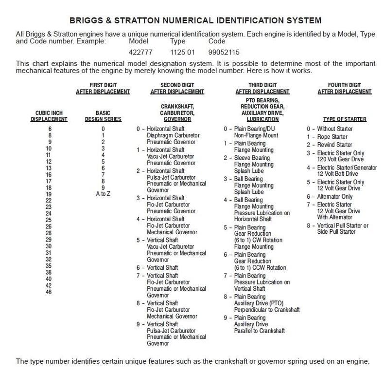

bds1984 1,513 #69 Posted October 6, 2021 1 hour ago, Horse Newbie said: Aww man !... My 1984 Work Horse with the twin Briggs must not have ball bearings...may as well carry it to the scrap yard ! And I had just started a thread on a refresh of the machine... 18 HP Briggs will have ball bearings, the rest will not unless the second-to-last digit in the model number is a 3 or 4. 3 1 Share this post Link to post Share on other sites
Horse Newbie 7,405 #70 Posted October 6, 2021 41 minutes ago, bds1984 said: 18 HP Briggs will have ball bearings, the rest will not unless the second-to-last digit in the model number is a 3 or 4. I have a GT-1600...isn't that a 16 hp ? 1 Share this post Link to post Share on other sites
Horse Newbie 7,405 #71 Posted October 6, 2021 (edited) Just from what I've seen, unless I didn't notice, my Briggs twin is missing the engine ID sticker. Any other way to ID the engine other than just guessing based on the year of tractor and hp ? Edited October 6, 2021 by Horse Newbie Share this post Link to post Share on other sites
ebinmaine 79,685 #72 Posted October 6, 2021 6 hours ago, Horse Newbie said: I have a GT-1600...isn't that a 16 hp ? Yes it is. Don't be the least bit concerned about not having ball bearings. On road vehicles don't either. 1 Share this post Link to post Share on other sites
ebinmaine 79,685 #73 Posted October 6, 2021 6 hours ago, Horse Newbie said: Just from what I've seen, unless I didn't notice, my Briggs twin is missing the engine ID sticker. Any other way to ID the engine other than just guessing based on the year of tractor and hp ? The only way I know of is to remove a cylinder head and measure the bore & stroke. 1 Share this post Link to post Share on other sites
