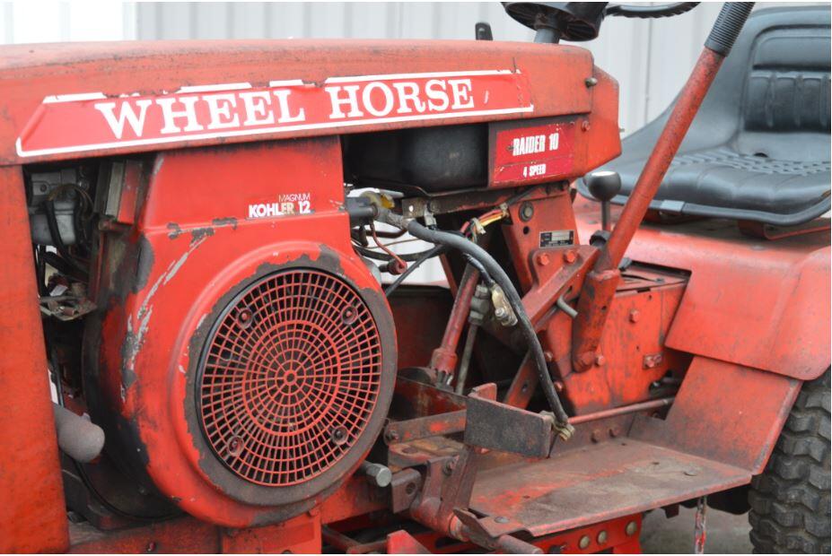

Maxwell-8 4,371 #9 Posted October 5, 2021 Look at my raider 10 newer style Kohler, an M12 apart from wiring, just a strait forward bolt-on 1 Share this post Link to post Share on other sites
bds1984 1,519 #10 Posted October 5, 2021 1 hour ago, Maxwell-8 said: Look at my raider 10 newer style Kohler, an M12 apart from wiring, just a strait forward bolt-on The patina on the M12 makes it look like an original engine to your Raider. 1 1 Share this post Link to post Share on other sites
Maxwell-8 4,371 #11 Posted October 5, 2021 1 minute ago, bds1984 said: The patina on the M12 makes it look like an original engine to your Raider. indeed the engine is at least 15 years younger but looks the same age as the Raider 10. I love the patina on this set-up Share this post Link to post Share on other sites
