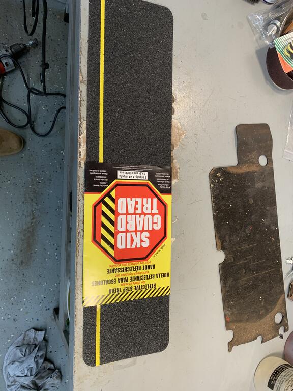

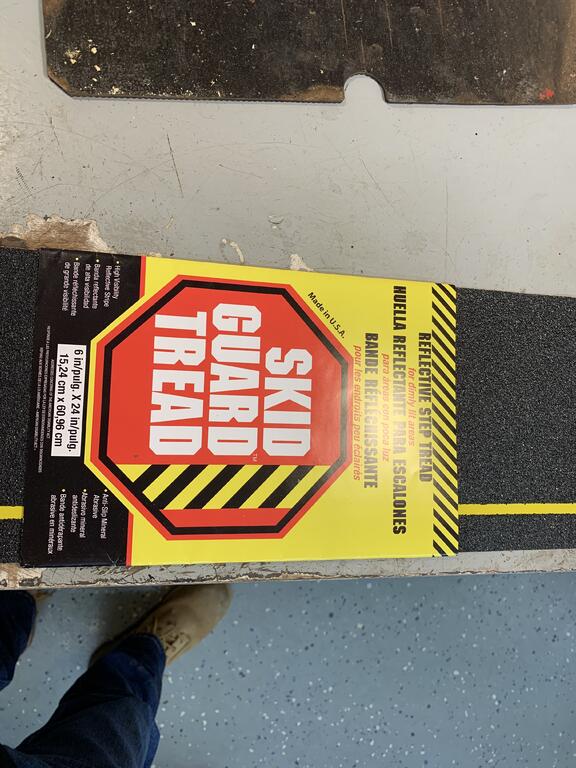

Horse Newbie 7,405 #1027 Posted March 29, 2022 26 minutes ago, WHX?? said: What's with the yellow strip on the floor board Newbie... just somthin different? That’s just like a safety stripe put on the edge of the stair step tread. The material is designed to be stuck to a stair tread. I got it at Lowes… 2 2 1 Share this post Link to post Share on other sites
WHX?? 58,175 #1028 Posted March 29, 2022 Ahhhh.... a go fast stripe now! 1 1 3 Share this post Link to post Share on other sites
Bill D 3,156 #1029 Posted March 29, 2022 4 hours ago, Horse Newbie said: That’s just like a safety stripe put on the edge of the stair step tread. The material is designed to be stuck to a stair tread. I got it at Lowes… I've used that same material on my foot boards. Good stuff. 1 Share this post Link to post Share on other sites
Jeff-C175 7,211 #1030 Posted March 29, 2022 47 minutes ago, Bill D said: same material "Yellow! Why's it always have to be yellow!" Too bad they don't come with a RED stripe! But they look great anyway! 2 1 Share this post Link to post Share on other sites

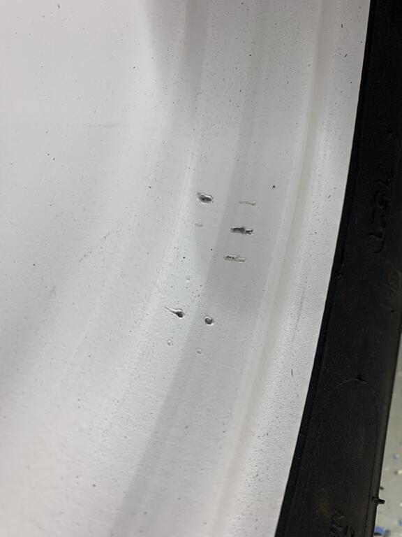

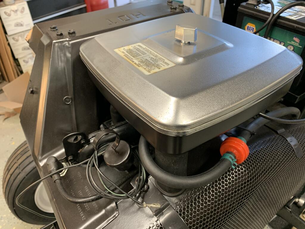

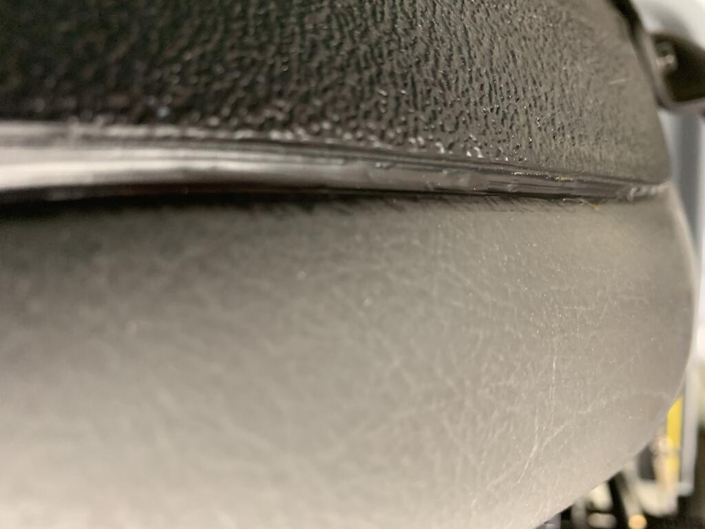

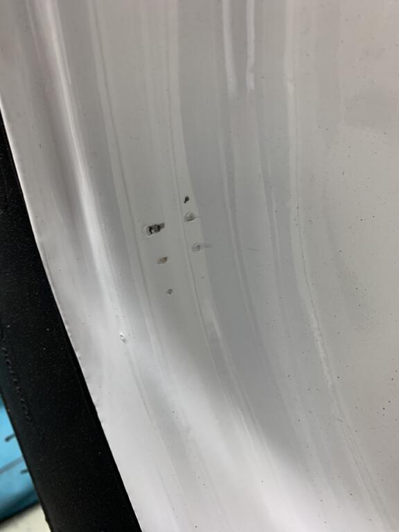

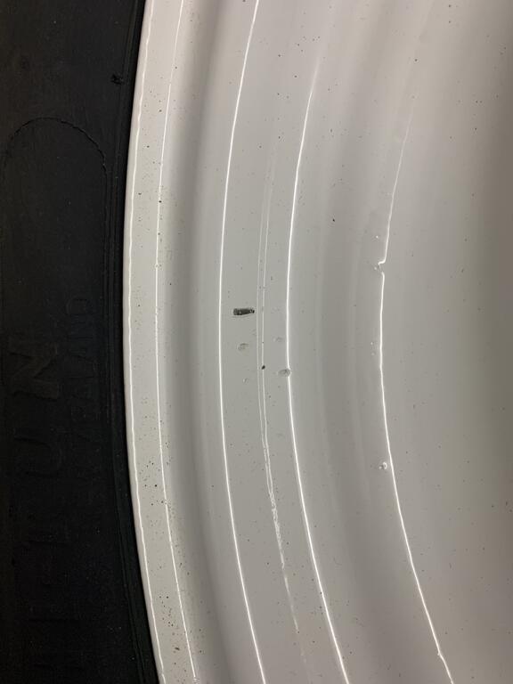

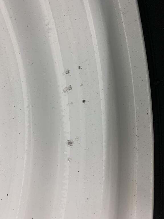

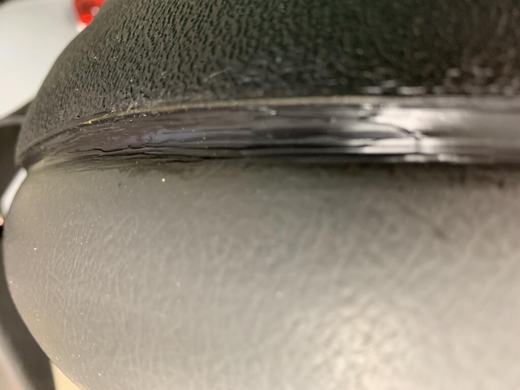

Horse Newbie 7,405 #1037 Posted March 31, 2022 I got the Work Horse air filter box on… waiting on the PTO safety switch from Fleabay… then I will “fire it up, fire it up, fire it up ! I had to run a bead of caulk around the back of the seat where the seat back meets the cushion… I bought the seat from a guy on CL, and after it sat in my 98 Silverado back seat for a year I guess the glue got tired so I had to re glue it. Then I had to caulk the seam to hide the glue. Also still need to touch up these spots on the rims where the tire shop scratched them mounting the Ags… 4 1 Share this post Link to post Share on other sites

WHX?? 58,175 #1042 Posted March 31, 2022 How the heck did the tire shop maim those rims there? Usually they skarf up the edge like I do .... Those look like hubcap marks. 1 Share this post Link to post Share on other sites
ebinmaine 80,756 #1043 Posted March 31, 2022 2 minutes ago, WHX?? said: How the heck did the tire shop maim those rims there? Usually they skarf up the edge like I do .... Those look like hubcap marks. I've operated tire machines in the past that had self-expanding jaws which would make marks a lot like those. That was what held the rim centered while the tire was being installed. 3 1 Share this post Link to post Share on other sites

Horse Newbie 7,405 #1046 Posted March 31, 2022 1 hour ago, WHX?? said: How the heck did the tire shop maim those rims there? Usually they skarf up the edge like I do .... Those look like hubcap marks. What @ebinmaine said… 1 hour ago, ebinmaine said: I've operated tire machines in the past that had self-expanding jaws which would make marks a lot like those. That was what held the rim centered while the tire was being installed. Yep… that’s what did it… the same shop did the tires on my 1994 520H without a scratch… Wonder if it was because the AGS are stiffer ? 2 Share this post Link to post Share on other sites
Horse Newbie 7,405 #1047 Posted March 31, 2022 1 hour ago, WHX?? said: Those look like hubcap marks. Not hub cap marks… no caps going on the Work Horse… When I put hub caps on my 1994 520H rims, I put a little red dot where one of the hub cap clips lined up… that way as long as I always line up at least one clip with the red dot, if it does scratch the wheel, the scratches will remain in one place and not wind up being all the way around the wheel… Of course how often does one take off and re-install hub caps ? 3 Share this post Link to post Share on other sites
ebinmaine 80,756 #1048 Posted March 31, 2022 17 minutes ago, Horse Newbie said: Wonder if it was because the AGS are stiffer ? That's a legitimate possibility 2 Share this post Link to post Share on other sites
76c12091520h 4,284 #1049 Posted March 31, 2022 2 hours ago, Horse Newbie said: What @ebinmaine said… Yep… that’s what did it… the same shop did the tires on my 1994 520H without a scratch… Wonder if it was because the AGS are stiffer ? I've been wondering this whole time why they clamped on the front side of the rim instead of the back....... 2 Share this post Link to post Share on other sites
ebinmaine 80,756 #1050 Posted March 31, 2022 1 minute ago, 76c12091520h said: I've been wondering this whole time why they clamped on the front side of the rim instead of the back....... A lot of the tire machines clamp on the deep side of the rim which in our case happens to be the FRONT, unlike most vehicles. 3 Share this post Link to post Share on other sites
