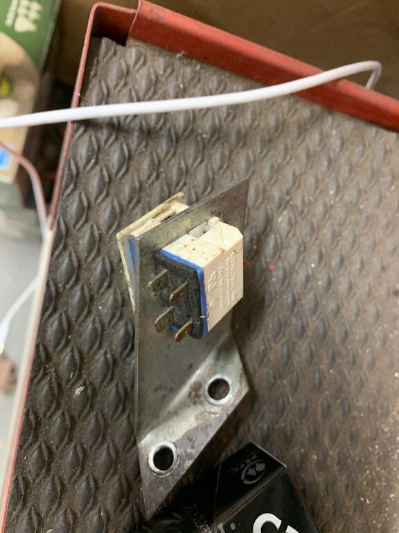

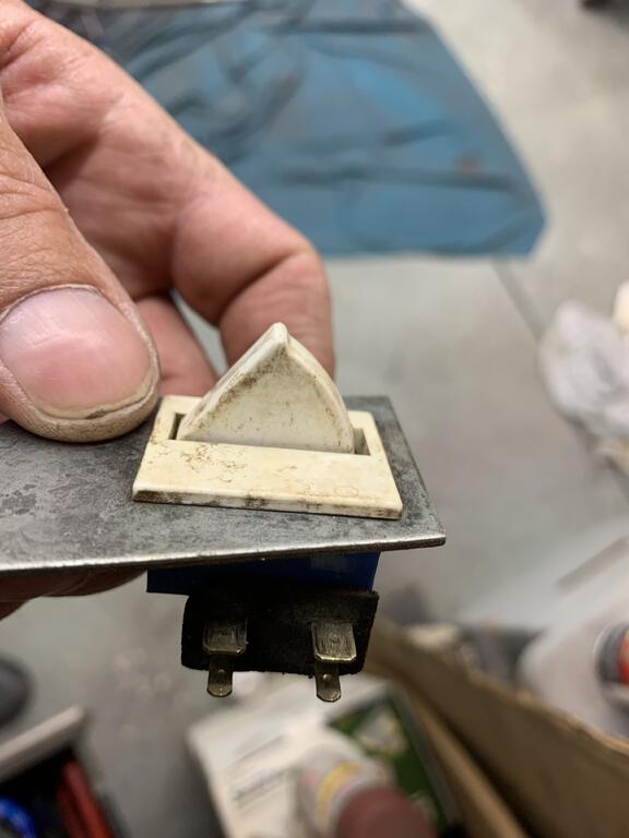

Horse Newbie 7,405 #1002 Posted March 27, 2022 (edited) Sanded and painted the air filter box for the Work Horse today… but we have a problem. I could not resist trying to Fire it up, Fire it up, Fire it up, as they say at Taryl’s… but I turn the key and nothing… New battery. About a month or so ago when I got the transmission back in and the drive belt on she cranked fine . I was checking the transmission a little… What’s the first thing I should check ? Edited March 28, 2022 by Horse Newbie 1 1 Share this post Link to post Share on other sites
SylvanLakeWH 32,580 #1003 Posted March 27, 2022 Check the battery. May have a drain… may have left key on… etc. Then trace all wires. May just have overlooked a simple connection… 1 Share this post Link to post Share on other sites
Horse Newbie 7,405 #1004 Posted March 27, 2022 @SylvanLakeWH, On any of the safety switches, does it matter which wire goes to which terminal ? Could I just jump any particular switch to bypass and check it ? Share this post Link to post Share on other sites
Horse Newbie 7,405 #1005 Posted March 27, 2022 How do I jump the key switch ? Share this post Link to post Share on other sites
SylvanLakeWH 32,580 #1006 Posted March 27, 2022 (edited) I’d just jump each switch one at a time, simple on / off… direction won’t matter… Battery good? Edited March 27, 2022 by SylvanLakeWH 1 Share this post Link to post Share on other sites
Horse Newbie 7,405 #1007 Posted March 28, 2022 (edited) @SylvanLakeWH… I got it! I started jumping switches while I had another member on the phone (if he wants to break his anonymity he can). It turned out to be the PTO switch. Just ordered one on Fleabay… Thanks a million for the quick response! Edited March 28, 2022 by Horse Newbie 3 3 Share this post Link to post Share on other sites

kpinnc 18,970 #1009 Posted March 28, 2022 My apologies for the confusion there. I had my 310-8 on my brain, and the PTO switches are seperate. I've never seen one like that before, but I'm glad you found it. You'll be crusin' soon! 1 Share this post Link to post Share on other sites

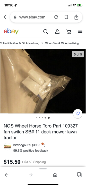

8ntruck 9,305 #1013 Posted March 28, 2022 @kpinncDid you find a new one or a used one on the 'bay? The brake switch on my C195 is of similar look and construction. I could not find a source for a new one, so I ended up opening the switch to clean the contacts and increase the spring force a bit. 1 Share this post Link to post Share on other sites
Horse Newbie 7,405 #1014 Posted March 28, 2022 @8ntruck… the PTO switch above is from my 1984 Work Horse GT-1600. I think the Work Horses was comparable to the 300 series Wheel Horses… somebody correct me if I’m wrong… Share this post Link to post Share on other sites
Horse Newbie 7,405 #1015 Posted March 28, 2022 54 minutes ago, kpinnc said: Case of beer I think you’re just looking for a reason to drink beer… if a person needs one that is… 1 Share this post Link to post Share on other sites

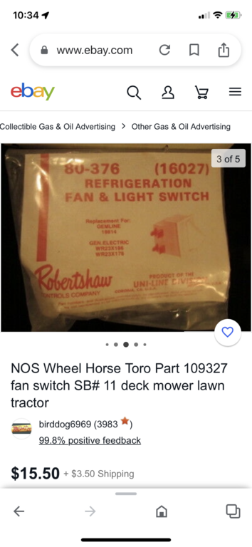

Horse Newbie 7,405 #1016 Posted March 28, 2022 The PTO switch part number off the 1984 Work Horse GT-1600 is 109327. Found it new on Fleabay… it is also used as a light and fan switch on refrigerators…. 2 Share this post Link to post Share on other sites

8ntruck 9,305 #1019 Posted March 28, 2022 Different manufacturer for your replacement. I was chasing a Littlefuse part number on my brake switch - which turned out to be NLA. I will keep the appliance parts house in mind for future needs like this. 2 Share this post Link to post Share on other sites
ebinmaine 80,756 #1020 Posted March 28, 2022 2 hours ago, 8ntruck said: Different manufacturer for your replacement. I was chasing a Littlefuse part number on my brake switch - which turned out to be NLA. I will keep the appliance parts house in mind for future needs like this. @Horse Newbie and @8ntruck When that's verified as a working switch in the application it would be a great idea to type out all that info in a post using extra "keywords" so we can search it later. 1 Share this post Link to post Share on other sites
