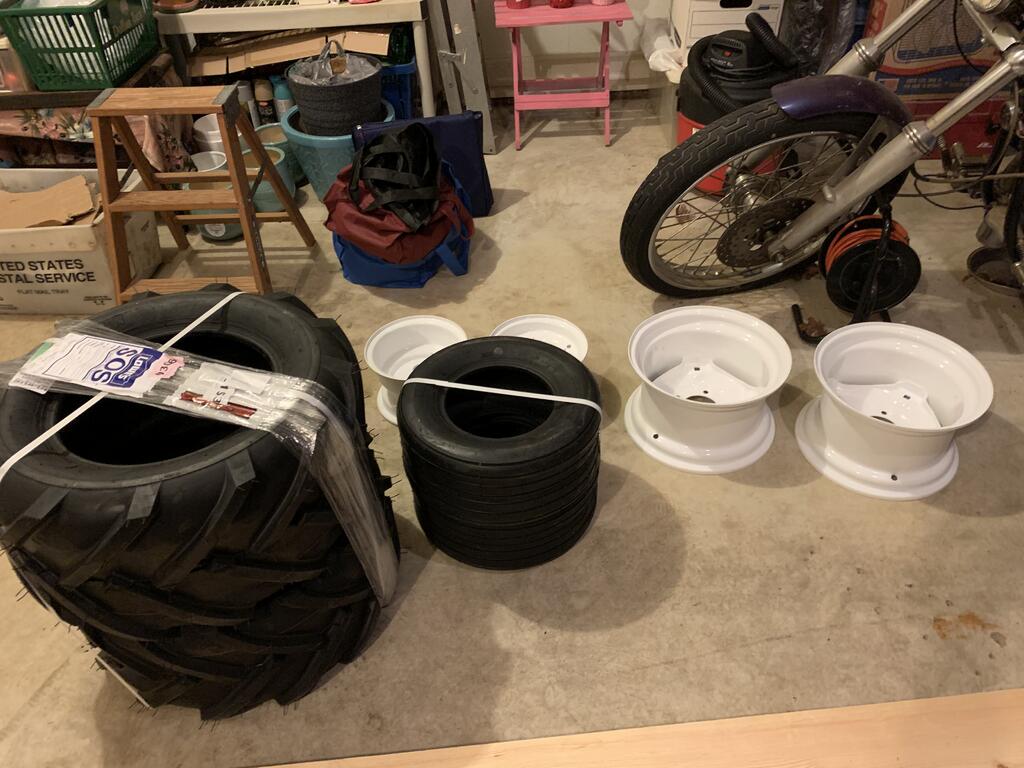

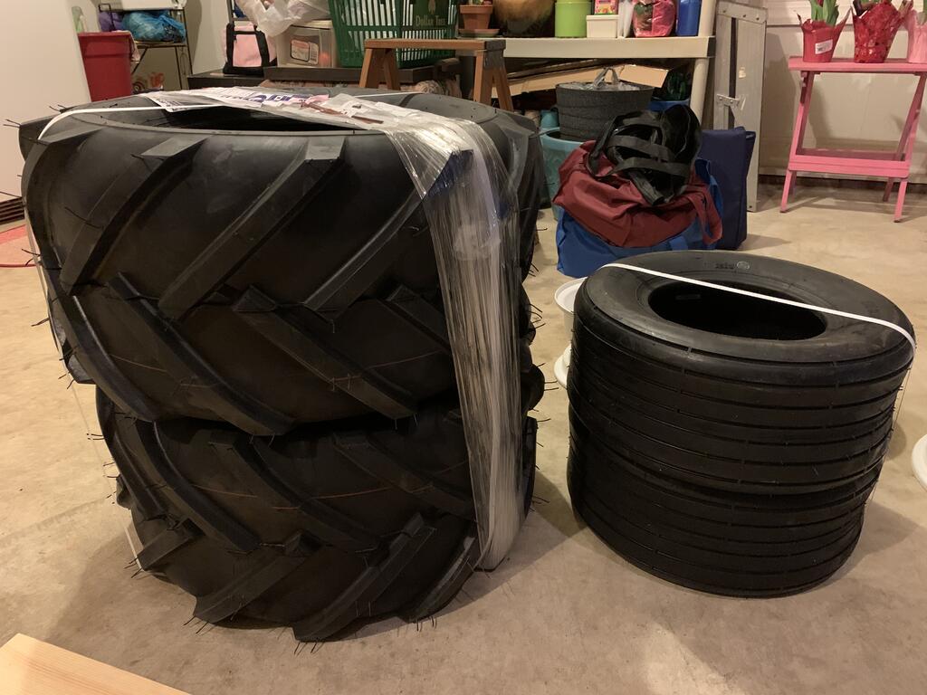

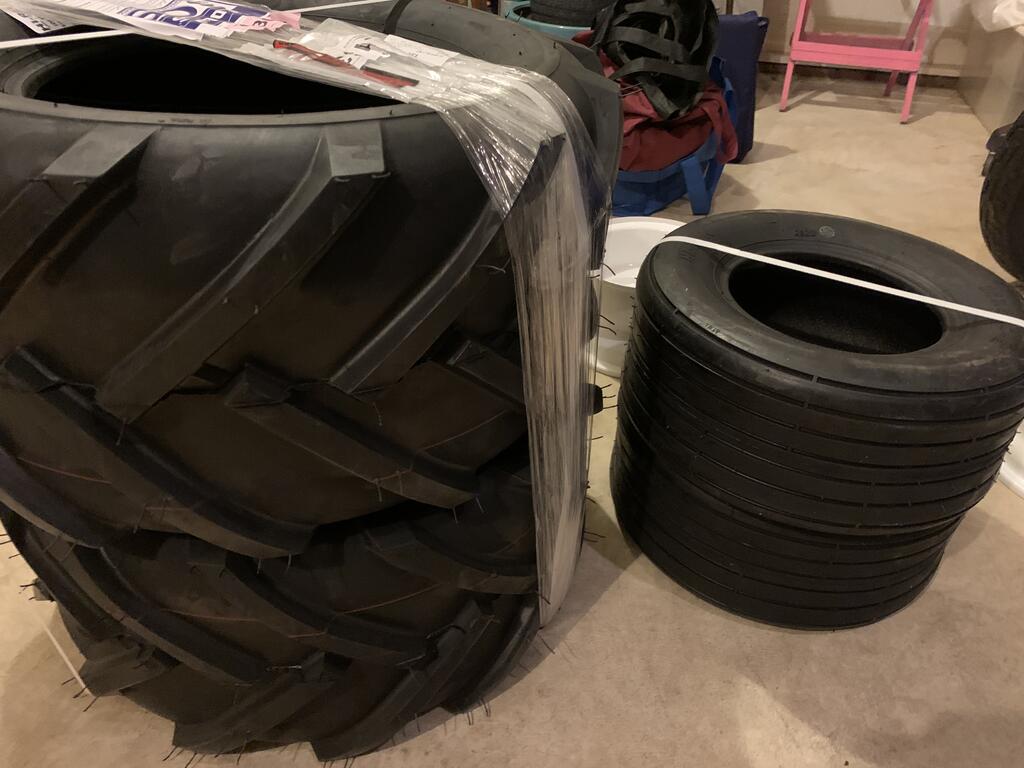

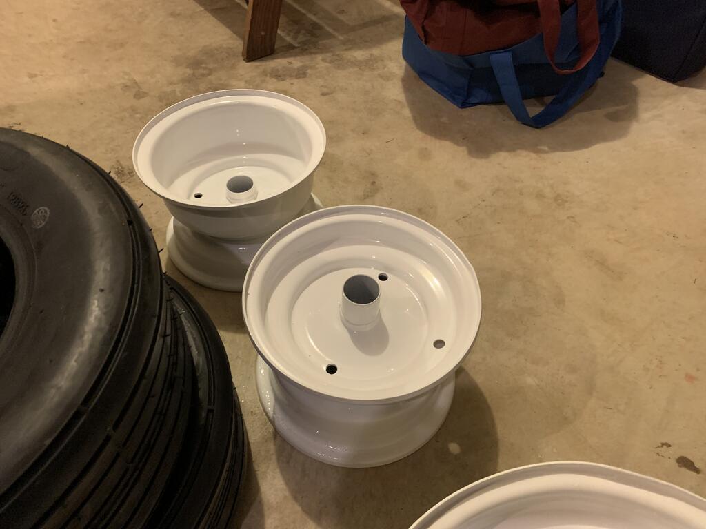

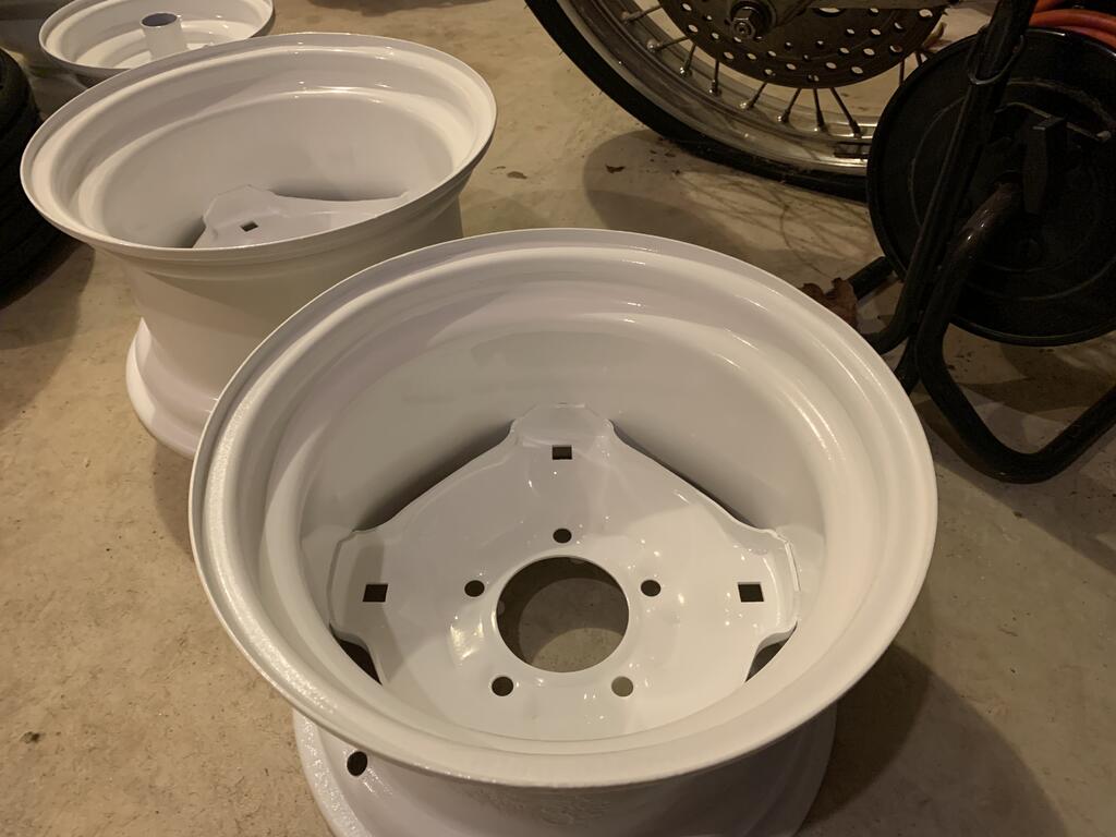

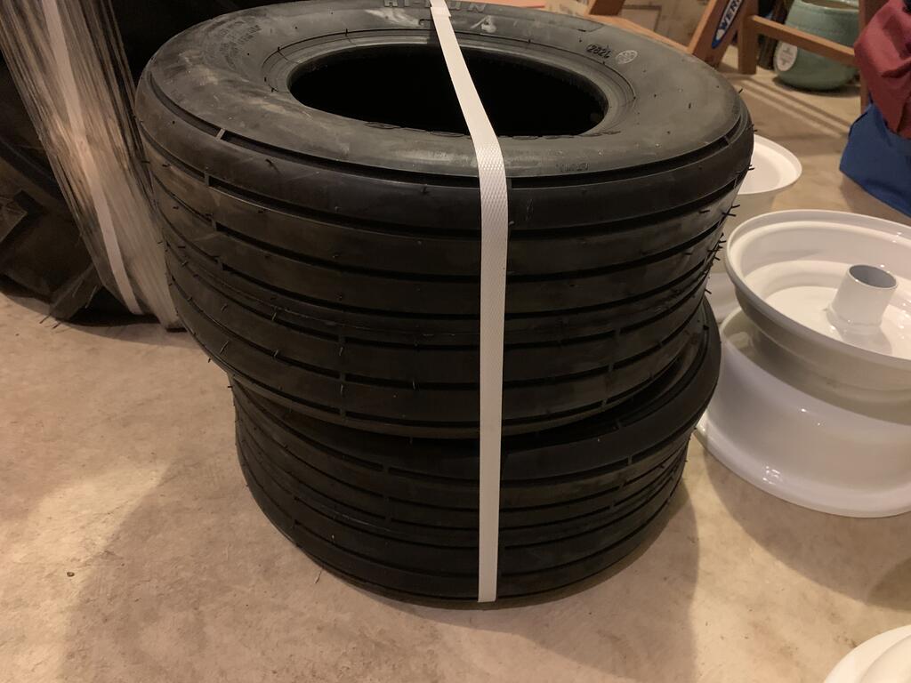

Horse Newbie 7,405 #794 Posted February 12, 2022 Picked up my powder coated wheels today after work… then picked up my ags and straight ribs… More work will be done on the Work Horse this weekend ! 3 6 Share this post Link to post Share on other sites
