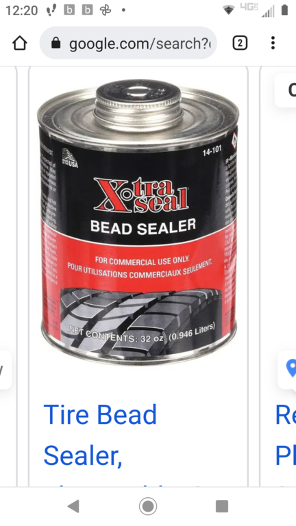

Horse Newbie 7,405 #751 Posted January 30, 2022 I think this is to cement a plug or patch. Share this post Link to post Share on other sites
Bill D 3,156 #752 Posted January 30, 2022 I have tire bead sealer. Got it at Napa. Works great. 1 1 Share this post Link to post Share on other sites
Horse Newbie 7,405 #753 Posted January 30, 2022 Thanks @Bill D… I’ll check my local NAPA. 1 Share this post Link to post Share on other sites

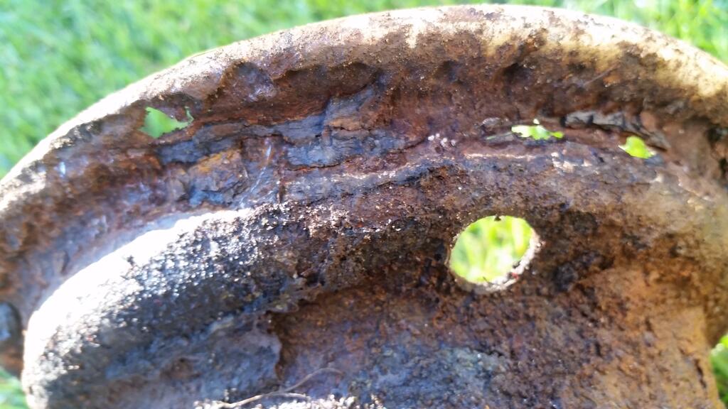

sjoemie himself 3,227 #754 Posted January 30, 2022 10 hours ago, kpinnc said: I've got wheels uglier than that that still hold air fine. Especially if you powdercoat them, they should be fine.. and as @ebinmaine said you can always use tubes. If you really want to make the rims smoother I would suggest getting them sandblasted first, then apply putty or filler which can be used with powdercoating. And lastly get them powdercoated. Should be good as new.. 2 Share this post Link to post Share on other sites
WHX?? 58,178 #755 Posted January 30, 2022 The bead sealer goes on as somewhat a liquid but then dries but does not harden. It's messy and you'll get it all over everything but once it sets it peels right off. 3 hours ago, sjoemie himself said: then apply putty or filler I don't think that would work with these rims! 4 1 Share this post Link to post Share on other sites
Jeff-C175 7,211 #756 Posted January 30, 2022 11 hours ago, kpinnc said: He's right. Dunno why I couldn't find it before... https://shop.advanceautoparts.com/p/xtra-seal-vulcan-cement-14-008/16910029-P @Horse Newbie is right. That's a cement for patching. 2 Share this post Link to post Share on other sites
sjoemie himself 3,227 #757 Posted January 30, 2022 59 minutes ago, WHX?? said: I don't think that would work with these rims! Depends how big your bucket of filler is 4 1 Share this post Link to post Share on other sites
kpinnc 18,970 #758 Posted January 30, 2022 1 hour ago, Jeff-C175 said: @Horse Newbie is right. That's a cement for patching. Sorry I clicked the wrong picture. 3 Share this post Link to post Share on other sites

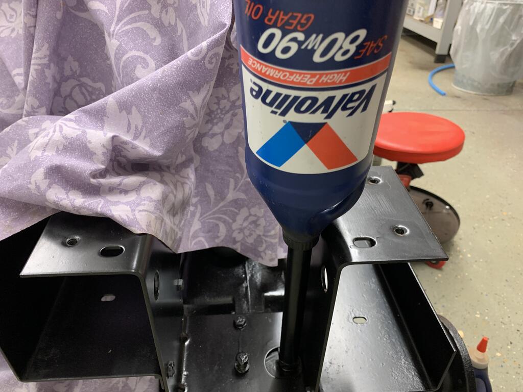

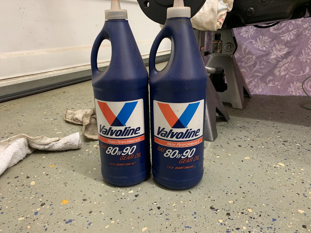

Horse Newbie 7,405 #765 Posted February 1, 2022 Tried to call the powder coat shop today… left message … no call back yet… But there’s still plenty to do on the Work Horse. Soooo… I put the new transmission input shaft seal in, and just for a little extra insurance I put some RTV gasket sealer around the shaft hole where it recesses in to receive the seal. It was rated for differential work. Let’s hope for no leak this time. I put it in backwards like @WHX?? said he has done before. Also went ahead and poured about 1/2 qt. of 80-90 gear oil in her. I’ll wait and top it off in a day or so to let that RTV sealer set up a little. 2 1 Share this post Link to post Share on other sites

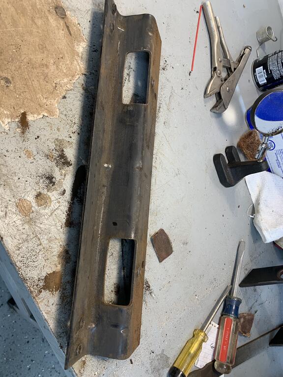

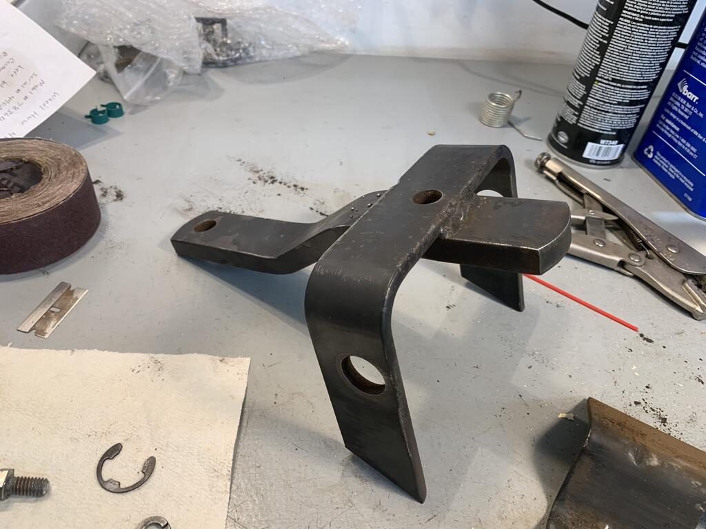

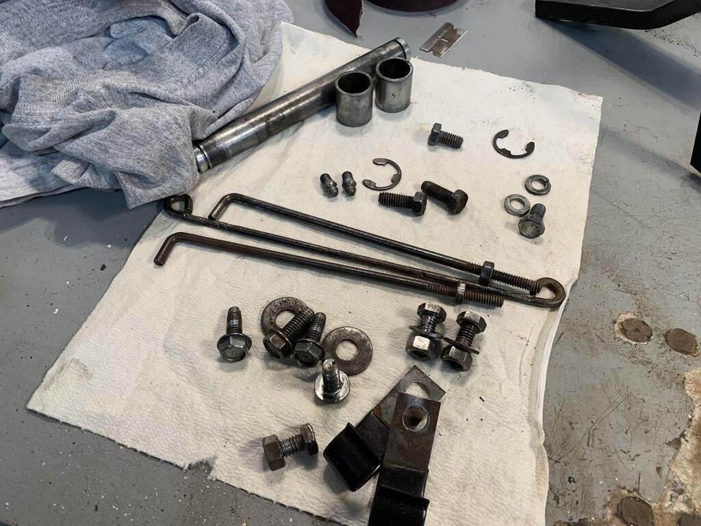

Horse Newbie 7,405 #766 Posted February 1, 2022 Also cleaned and sanded a few more parts to paint Satin Black… 2 2 Share this post Link to post Share on other sites
