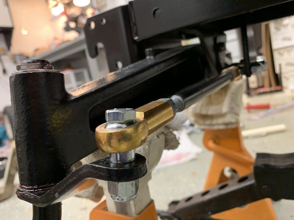

Horse Newbie 7,405 #576 Posted January 21, 2022 (edited) 18 minutes ago, Jeff-C175 said: I think you should have jam nuts at both ends of the tie rods. If you don't you'll end up wearing out the threads. Dag-nab it ! Edited January 21, 2022 by Horse Newbie 2 Share this post Link to post Share on other sites

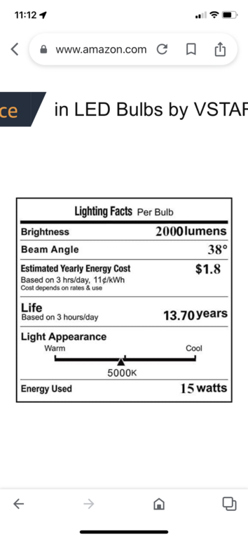

kpinnc 19,107 #577 Posted January 21, 2022 2 minutes ago, Horse Newbie said: Anybody used these for headlights ? Not specifically. How much are they? If the Lumens rating is correct, they'll be bright. Share this post Link to post Share on other sites

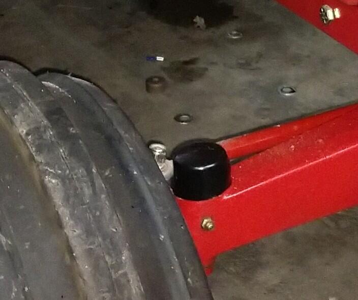

Jeff-C175 7,212 #578 Posted January 21, 2022 Think about putting dust caps on the spindles too... You can get these in black also. 1 1 Share this post Link to post Share on other sites
Horse Newbie 7,405 #579 Posted January 21, 2022 8 minutes ago, kpinnc said: Not specifically. How much are they? If the Lumens rating is correct, they'll be bright. 8 minutes ago, kpinnc said: Not specifically. How much are they? If the Lumens rating is correct, they'll be bright. $17.53… 1 Share this post Link to post Share on other sites
Jeff-C175 7,212 #580 Posted January 21, 2022 (edited) 20 minutes ago, Horse Newbie said: Anybody used these Different name on mine, but I'm sure the dame samn thing. Mine are 6000K which means a little bit 'whiter', perhaps almost 'blue-ish', than the 5000K. I figure if I'm going LED I'm gonna get 'em as white as possible, but 5000K is good too. I wouldn't go any lower than that because they start to turn yellow. Edited January 21, 2022 by Jeff-C175 2 Share this post Link to post Share on other sites
Horse Newbie 7,405 #581 Posted January 21, 2022 7 minutes ago, Jeff-C175 said: Think about putting dust caps on the spindles too... You can get these in black also. Looks like your washer is up higher than mine… Share this post Link to post Share on other sites

Jeff-C175 7,212 #583 Posted January 21, 2022 (edited) 57 minutes ago, Horse Newbie said: Looks like your washer is up higher than mine… I don't believe there's a washer on mine at all. I think the 'hump' you see in the cover is the top of the spindle. Mine have C-clips and not split cotters. You might have to flatten that cotter head with a hammer. Edited January 21, 2022 by Jeff-C175 1 Share this post Link to post Share on other sites

Horse Newbie 7,405 #587 Posted January 21, 2022 If I hammer that cotter pin head down flat, those black dust cover caps will slid over the top of the end of the axle where the spindle shaft comes up through right ? Share this post Link to post Share on other sites

kpinnc 19,107 #589 Posted January 21, 2022 8 minutes ago, Horse Newbie said: If I hammer that cotter pin head down flat, those black dust cover caps will slid over the top of the end of the axle where the spindle shaft comes up through right Yep, they work great! Got them on the Bronco, and I should get a set for a couple others too. 1 Share this post Link to post Share on other sites

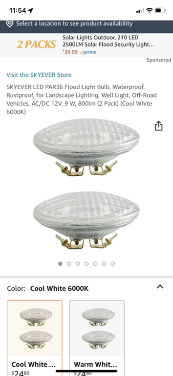

Horse Newbie 7,405 #590 Posted January 21, 2022 On 1/19/2022 at 11:20 PM, Jeff-C175 said: I took a look see at my LED head lamps and they are labeled AC/DC so they will work on either, but the flicker would still be a problem with the limited output of the stator on your engine, and the RPMs will change the FREQUENCY of the flicker. MANY of the ones I see on Amazon are also AC/DC. @Jeff-C175 are these the ones you have ? @kpinnc look 6000K ! Share this post Link to post Share on other sites

Jeff-C175 7,212 #592 Posted January 21, 2022 25 minutes ago, Horse Newbie said: If I hammer that cotter pin head down flat, those black dust cover caps will slid over the top of the end of the axle where the spindle shaft comes up through right ? Correct. 1 Share this post Link to post Share on other sites

Jeff-C175 7,212 #594 Posted January 21, 2022 (edited) 10 minutes ago, Horse Newbie said: are these the ones you have ? Looks like it. These were already in the machine when I got it a few months ago. But yeah, that is probably them. Those ones you showed were higher Lumens though... but these are pretty bright too. I imagine side by side 800 versus 2000 would be huge though. Edited January 21, 2022 by Jeff-C175 Share this post Link to post Share on other sites
