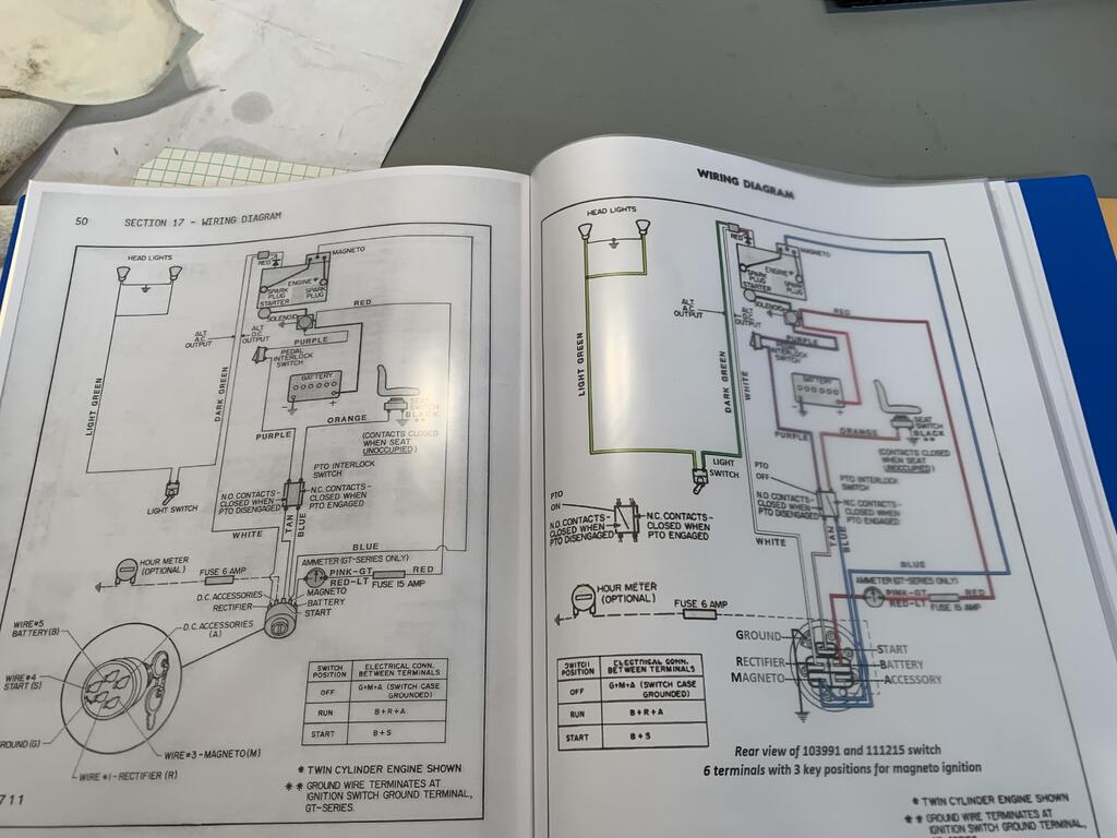

Horse Newbie 7,405 #565 Posted January 20, 2022 (edited) Want to give a big THANK YOU to @Jeff-C175 ! I was needing some help with the wiring on the Work Horse and he really came through ! He sent me a Parts and Service Manual, as well as a color coded wiring diagram. So in my typical, not quite, but almost anal fashion; I had to go to OfficeMax and print it off, put the pages in sheet protectors, and put it in a binder. Thanks again Jeff !… so now it’s time to take the wiring harness back out, make a few changes as far as wiring in for tail lights, and rerouting the harness as it shows in the manual. Edited January 21, 2022 by Horse Newbie 2 1 Share this post Link to post Share on other sites
Jeff-C175 7,212 #566 Posted January 20, 2022 54 minutes ago, Horse Newbie said: Thanks agin Jeff !… You're welcome! But all I did was look it up in the manuals section and post the link! For future reference, here's the link to the main page of the 'files' section: https://www.wheelhorseforum.com/files/ 1 1 Share this post Link to post Share on other sites

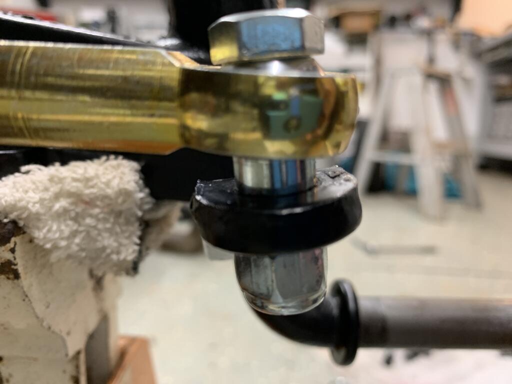

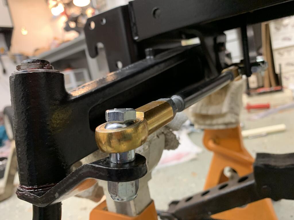

Horse Newbie 7,405 #568 Posted January 21, 2022 A couple of pages back @kpinnc suggested I use spacers on my bolts to get the ball joints on my tie rod ends up off of my spindle arms… so I did . Here’s some pics. Thanks Kevin ! 2 Share this post Link to post Share on other sites

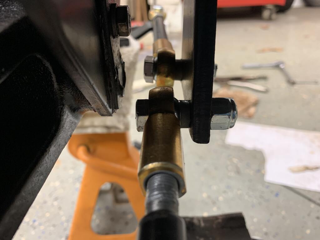

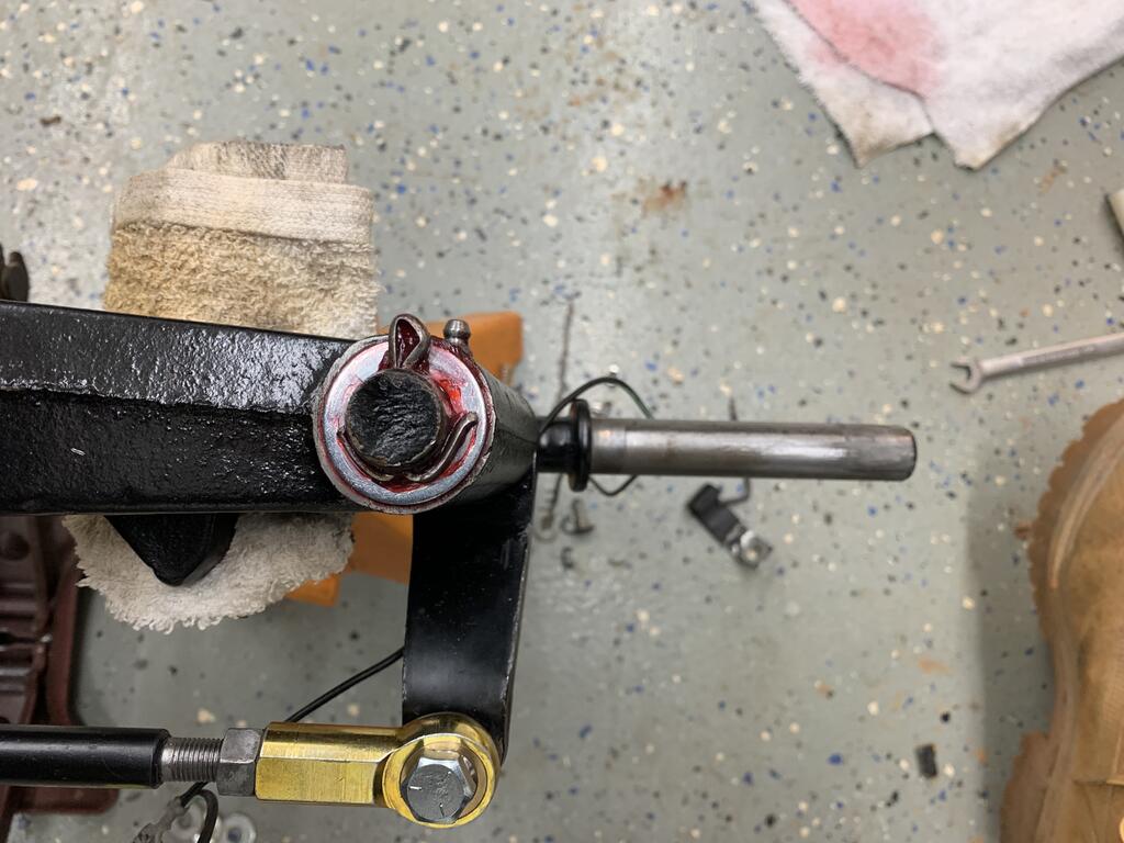

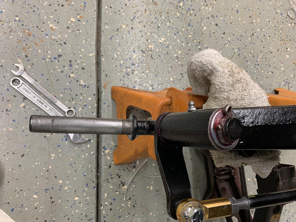

Horse Newbie 7,405 #569 Posted January 21, 2022 Set the toe-in by eyeballing it… should be fine… 3 Share this post Link to post Share on other sites

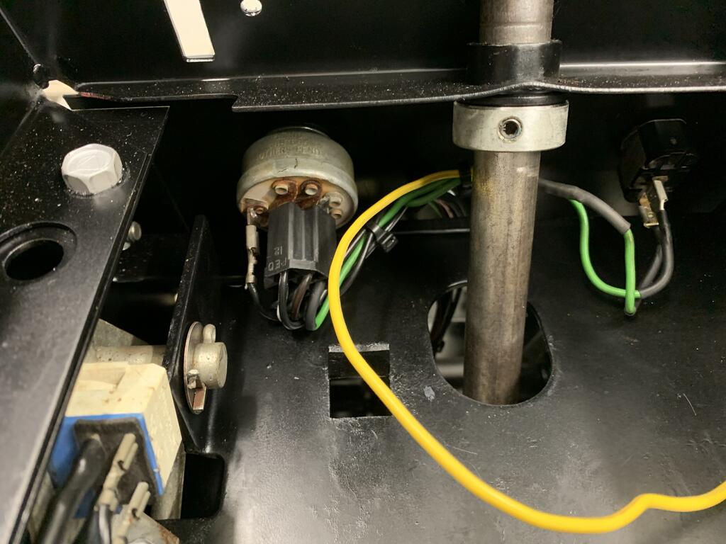

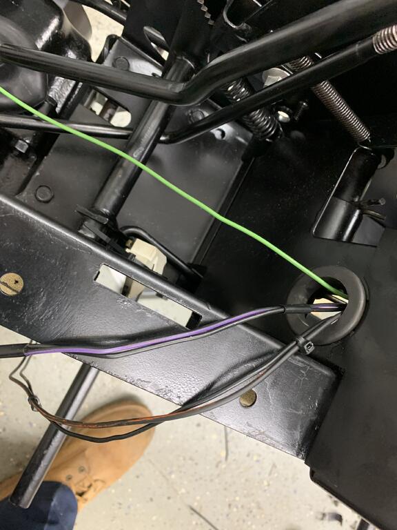

Horse Newbie 7,405 #570 Posted January 21, 2022 (edited) Replaced a few spade connectors … I have to call it the female side because I don’t know the real name of it. Came off the accessories terminal on the switch, split the wire to one wire for a future hour meter, and the other to the light switch. Came off light switch and split that wire… one for LED headlights and one for LED tail lights . I guess since the Work Horses did not have tail lights that will be an upgrade. Got most of the wiring harness put back in. Edited January 21, 2022 by Horse Newbie 1 2 Share this post Link to post Share on other sites

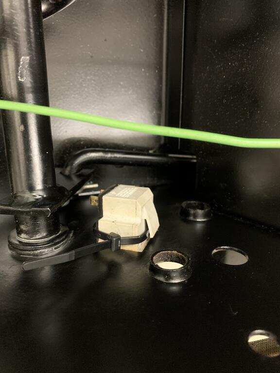

Horse Newbie 7,405 #571 Posted January 21, 2022 Has anyone else encountered the safety switch on the clutch pedal fitting loosely in its hole ? I looks like it still works fine fitting loosely, but I may try to make a sheet metal clip to slide down the body of the switch to hold it tight in place. I tried a zip tie , but that didn’t hold it tight and I would rather have a more permanent fix . Share this post Link to post Share on other sites
kpinnc 19,110 #572 Posted January 21, 2022 1 hour ago, Horse Newbie said: A couple of pages back @kpinnc suggested I use spacers on my bolts to get the ball joints on my tie rod ends up off of my spindle arms… so I did . Here’s some pics. Thanks Kevin ! That looks great! 1 Share this post Link to post Share on other sites

Jeff-C175 7,212 #574 Posted January 21, 2022 I think you should have jam nuts at both ends of the tie rods. If you don't you'll end up wearing out the threads. 1 1 Share this post Link to post Share on other sites

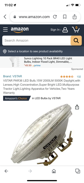

Horse Newbie 7,405 #575 Posted January 21, 2022 Anybody used these for headlights ? Share this post Link to post Share on other sites
