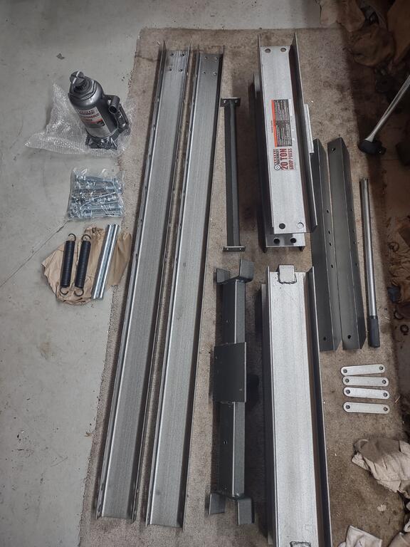

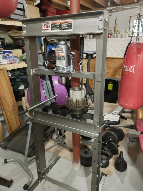

ebinmaine 81,035 #1 Posted October 3, 2021 All set up and I've already used it! 14 2 Share this post Link to post Share on other sites
squonk 48,278 #2 Posted October 3, 2021 I have the 12 ton bench top model. I like the ability to stick it on my lift table and roll it around or toss it into the pick up bed when I was working and bring it to the job site. 3 Share this post Link to post Share on other sites
ZXT 2,402 #3 Posted October 3, 2021 Excellent! I have a 20 ton as well. It's paid for itself 10x over. 1 Share this post Link to post Share on other sites

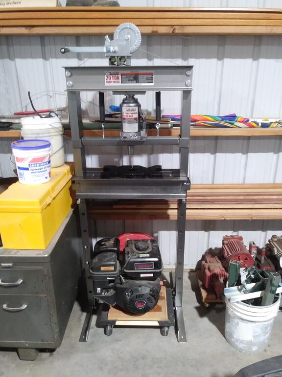

WHX?? 58,310 #10 Posted October 4, 2021 Mike and I have the same one. 2 Share this post Link to post Share on other sites
RandyLittrell 3,946 #11 Posted October 4, 2021 45 minutes ago, WHX?? said: Mike and I have the same one. That winch mod is one I need to do!! Randy 1 Share this post Link to post Share on other sites
WHX?? 58,310 #12 Posted October 4, 2021 Check out what Cleat did in this thread Randy. 2 1 Share this post Link to post Share on other sites

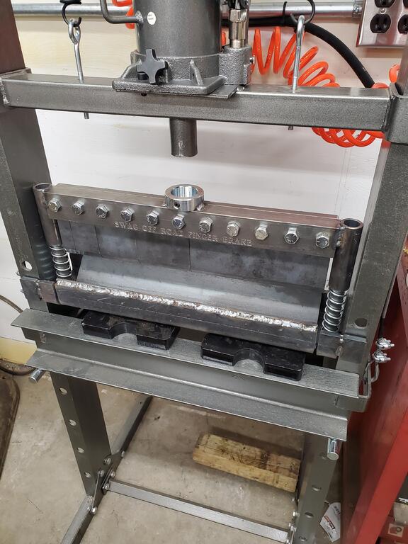

prondzy 3,891 #13 Posted October 4, 2021 4 hours ago, RandyLittrell said: I have had one of those for years and while I don't use it very often, its damn handy when I do. I would like to make a metal brake to go in it. Randy Check out swag offroad they have a brake for the HF 20ton. I have their finger brake 4 Share this post Link to post Share on other sites
RandyLittrell 3,946 #14 Posted October 4, 2021 1 minute ago, prondzy said: Check out swag offroad If I ever hit the lottery, I would order one of everything to make!! They make some really cool stuff! I have watched a lot of there videos. Randy 1 Share this post Link to post Share on other sites
ebinmaine 81,035 #15 Posted October 4, 2021 53 minutes ago, prondzy said: swag offroad Good quality stuff. I have the portable band saw table. Wasn't cheap and is very sturdy. I'll check out the site for more items. 2 Share this post Link to post Share on other sites

sparkys toy 77 #17 Posted April 11, 2022 Bought the same press 30% off great deal love it the base was a pain to adjust the height so I made this mod and it made raising and lowering it very easy 25 dollar boat winch from you guessed it HF 30% off 1 3 Share this post Link to post Share on other sites
WHX?? 58,310 #18 Posted April 11, 2022 Nice ... I have a boat winch with nothing to do I should use it. What do you guys have for rollers on the corners or does the cable just ride on the bolts? @prondzy 1 Share this post Link to post Share on other sites
prondzy 3,891 #19 Posted April 11, 2022 14 hours ago, WHX?? said: Nice ... I have a boat winch with nothing to do I should use it. What do you guys have for rollers on the corners or does the cable just ride on the bolts? @prondzy Rollers from a block and tackle you can pick them up at any big box store. 3 2 Share this post Link to post Share on other sites
sparkys toy 77 #20 Posted April 14, 2022 I was lazy at the time and just used a copper sleeve on the bolts but the pulleys look like the way to go if you're going to change the height often Share this post Link to post Share on other sites

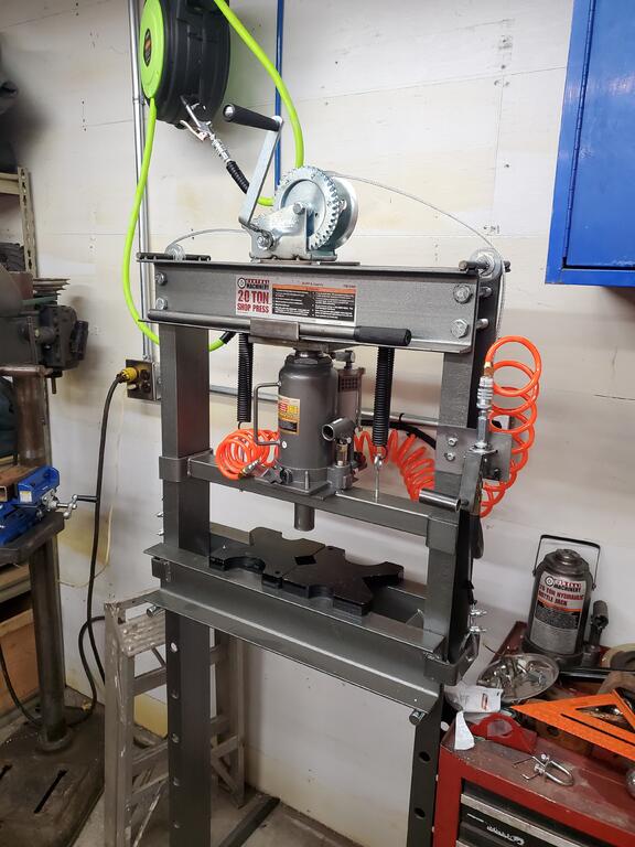

Thor27 892 #21 Posted April 15, 2022 HF also sells an air over hydraulic jack for those, I have shot more exploded stuff across my shop than I care to admit since. 2 Share this post Link to post Share on other sites
WHX?? 58,310 #22 Posted April 15, 2022 7 hours ago, Thor27 said: HF also sells an air over hydraulic jack for those Yes see Mike's pic. Rigged up Nice! 19 hours ago, sparkys toy said: copper sleeve on the bolts Good idea & prolly what I would do. I have arbors of different lengths so I don't have to change real often. 1 Share this post Link to post Share on other sites
