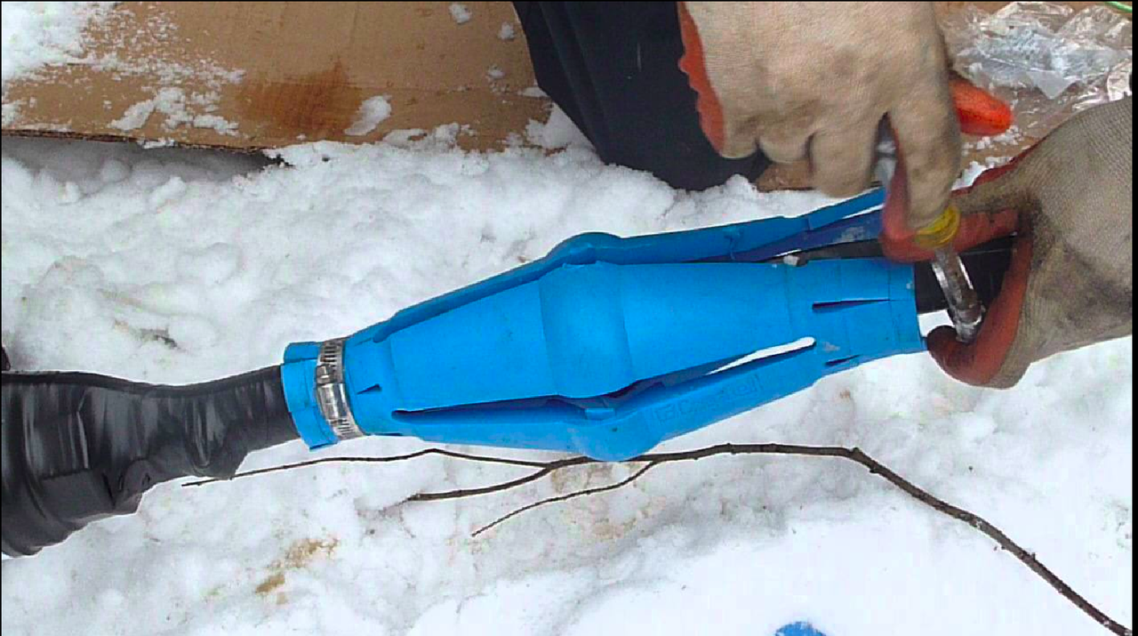

bc.gold 3,406 #1 Posted October 2, 2021 (edited) Some folks just don't belong in a rural setting, I happened to be visiting when the neighbors pump quit, second pump is two years. The list of problems found left me shaking my head, basement is damp which caused the contact point on the pressure switch to corrode, then I check the pump control on the wall for power its live both on line and to the pressure switch. We head over to the well and there's a power cord laying on the ground with a taped connected, remove the tape and found the copper corroded, cut and reconnect, back to the basement. Now that the contacts on the pressure switch have been cleaned the spark when making contact is visible but no water pressure. Used my amp meter the 1/2 hp power submersible pump is drawing 20 amps, owners manual says 5, I'm curious why the breaker has not kicked, idiot has a 40 amp breaker for the pump. From the deep well pump control box he has power connected to the white neutral, Oh and the best part when he installed the new pump two years ago set it right on the bottom of the well and now its silted in solid, told him he now has to rent a large diesel compressor and send the air hose right to the bottom to blow out the mud and silt. We're in limestone country, that pump may never dislodge. I've heard of people using dynamite to clean out a well, one stick gets the job done. But his casing is plastic. I'm no longer offering my assistance, if the house burned down they would hold me responsible and gawd only knows what other electrical connections he has Jerry rigged. It;s much safer playing in my own yard. Edited October 3, 2021 by bc.gold 3 1 6 Share this post Link to post Share on other sites

bc.gold 3,406 #4 Posted October 2, 2021 5 minutes ago, Roger R said: Document, date and record everything you found and did, just in case of legal action. Courts like organized and carefully laid out journals. Do not omit even the smallest of details. After seeing the wire laying on the ground poorly taped with corrosion then using the white neutral as a power wire I packed up and went home, If he does manage to pull the pump I'm curious to see if he even used the proper shrink tube on the pump connection. Not curious enough to go back and help with this nightmare. In all honesty this should be reported, they have small children on the property along with animals. Here's another blooper, they had a milk cow when she quit producing milk they butchered the animal, not aware they had to freshen the cow. 2 4 Share this post Link to post Share on other sites

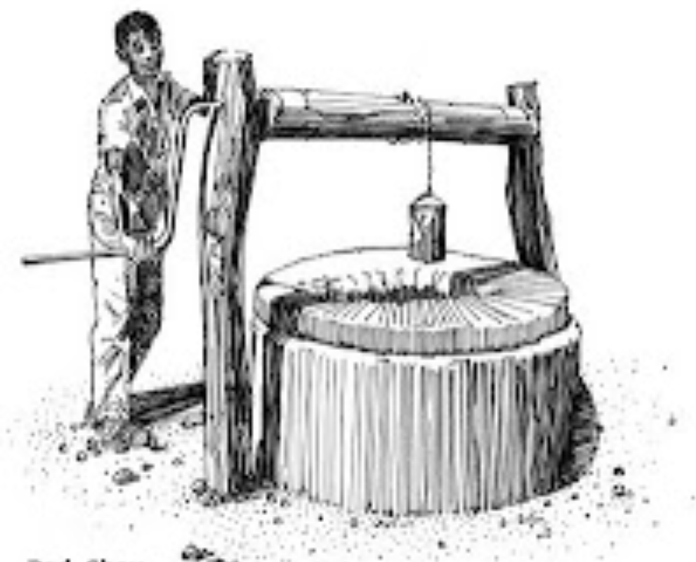

bc.gold 3,406 #11 Posted October 3, 2021 (edited) 2 hours ago, Handy Don said: Any decent driller, seller, or installer will recommend these--and they aren't expensive! Not rocket science, ya just gotta go ask people with some knowledge! Before I left for home the other day told him that I use a makeshift windlass to pull a deep well pump. bet ya $20.00 he pulled the pump the hard way. Edited October 3, 2021 by bc.gold 2 Share this post Link to post Share on other sites
bc.gold 3,406 #12 Posted October 3, 2021 (edited) Before he was able to replace the old pump they were without water for a year, he was unable to pull the pump. The day I was there he tried pulling on the rope and the pump would not budge this is when I told him the water line first had to be removed from the pitless saddle. It just occurred to me this is the reason they were unable to remove the old pump replaced two years ago. If I had made a mistake like this I would be sure to remember not to repeat it. Edited October 3, 2021 by bc.gold 2 Share this post Link to post Share on other sites

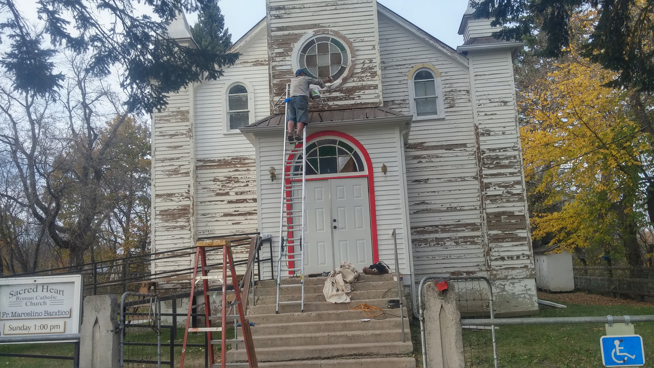

bc.gold 3,406 #15 Posted October 9, 2021 This is Tom the fellow with the loose nuts, painting the church. Share this post Link to post Share on other sites

Handy Don 16,315 #17 Posted October 9, 2021 12 minutes ago, bc.gold said: This is Tom the fellow with the loose nuts, painting the church. It's too painful. Just recognizing the risk makes one feel obligated to keep him from breaking his neck as he is valiantly trying to do a good deed. 1 Share this post Link to post Share on other sites

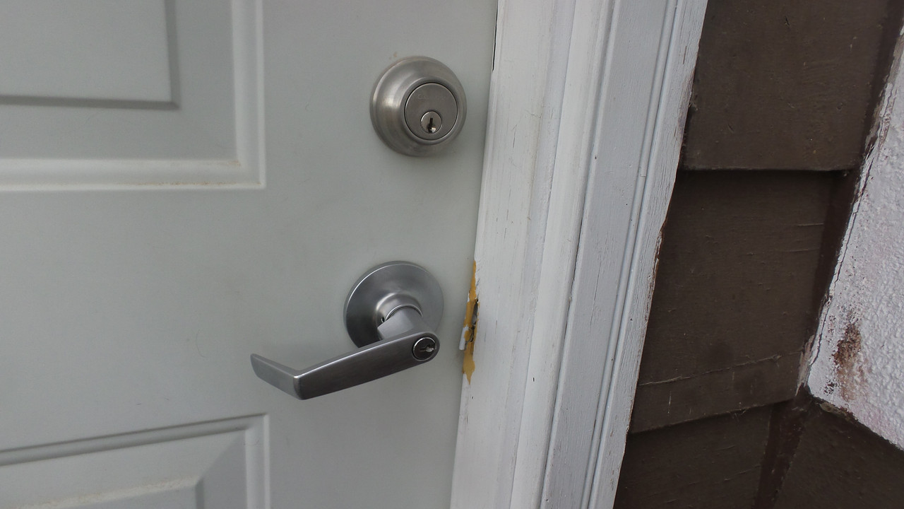

bc.gold 3,406 #20 Posted October 29, 2021 Couple days ago visiting a neighbor while leaving the mud room noticed a large gap between the door and frame wide enough to drive a truck through. After closing the door had a look from the outside and this is when I noticed the dead bolt was barely making contact with the striker. Clarence was still sitting at the kitchen table with the window open, I told him that problem could be fixed by removing the door casing then adding shims, a day later I heard that someone had broken in a stole his new John Deere mower from the attached garage. Share this post Link to post Share on other sites

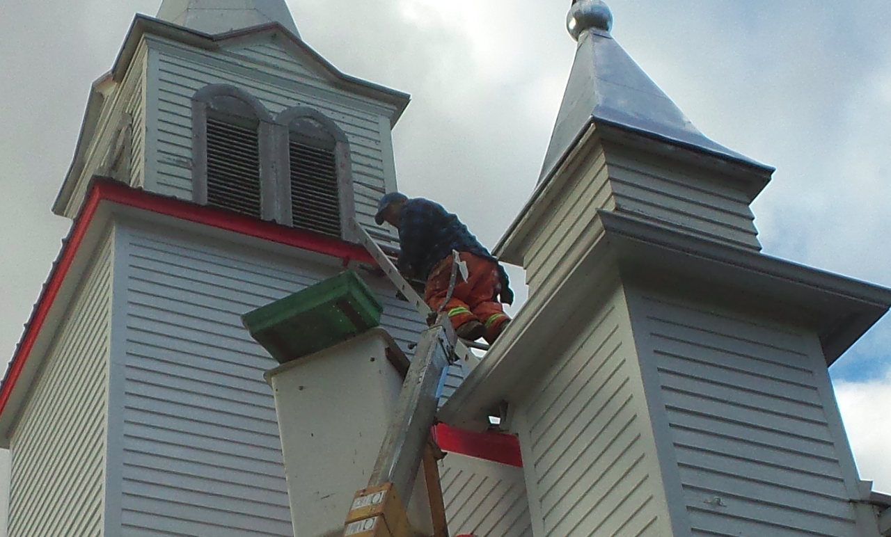

bc.gold 3,406 #22 Posted October 30, 2021 Tom working off of short ladder. Share this post Link to post Share on other sites
Handy Don 16,315 #23 Posted October 30, 2021 I guess the boom truck doesn't reach high enough or doesn't offer as much daring excitement. Also, he doesn't have many more days when he can work now that the temperature is starting to fall. I will say, though, that that church is looking nice. 1 Share this post Link to post Share on other sites
