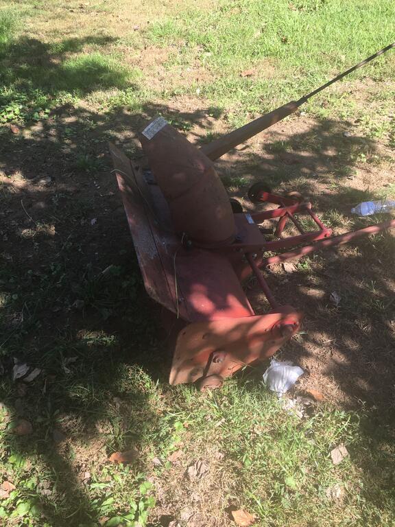

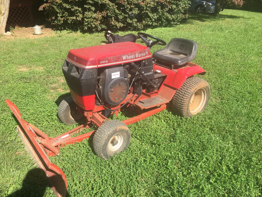

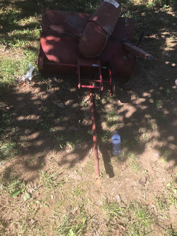

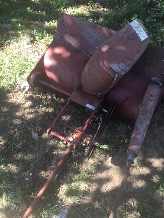

Newb here, recently purchased a b310 that now runs with snow thrower, plow, and mower deck for what I believe to be a good deal for $200. My question to all y’all gurus is what am I missing for my snow thrower attachment? I’d like to get it squared away before winter I know I’m going to need a belt and chain any help would be greatly appreciated.

Find the model number on your blower and then take a look through our manuals section. Should be exploded views with part numbers to show you all the parts you will need.
https://www.wheelhorseforum.com/files/category/28-snow-blowers/

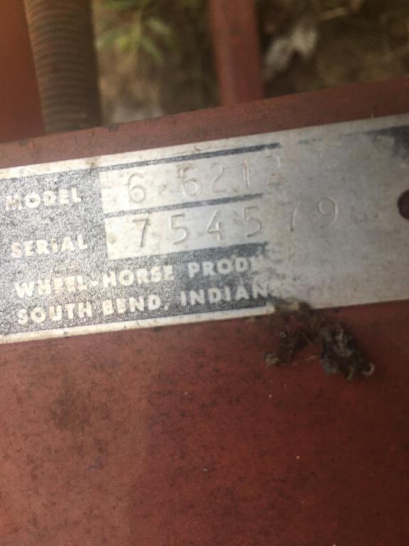

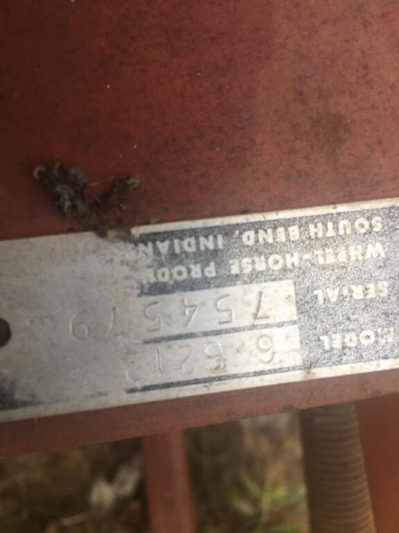

I can take a harder look but the tag on it is so worn I can’t make out anything it has to tell me
WHX??
:WRS:
Have you got a piece that looks like this? They often get left behind or lost.
https://wheelhorsepartsandmore.com/product/snow-blower-lift-flag-101461-with-spring-4629-and-eye-bolt/
Any idea on the year of the tractor that might help narrow things down.

If your tractor has a front attach-a-matic,  the belt,the flag, a cable for the chute rotator, and a chain if it is missing should be all you need.

Appears the blower is a bit older than the tractor. Blower is a 1974.

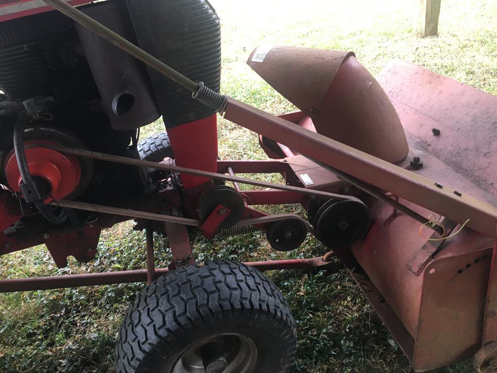

Update again for hose that may come across this in hopes it helps, it is a #40 chain, 51 link count which includes master link with a 69 inch belt and attached is a photo of belt installed. One more question tho, is it normal when you go to raise the snow thrower that I not lock in the up position? Or is that the purpose of spring assisted lift flag assembly?
rjg854
It should lock in the up position.
Ed Kennell
                                                             :text-yeahthat:
     Block the blower up to try to determine what is preventing the lift lock from engaging.      If the blower is lifting too high, you may have to shorten the push rod by removing a washer.

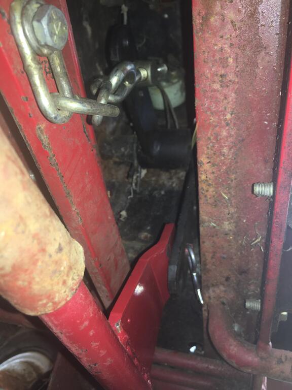

It locks with everything else just not the blower I’ll mess with it tomorrow and post my findings, actually want snow now just to try it out
Ed Kennell
Is the flag in the correct hole in the lever?
87buickt
Only fits in 1 of the 2 holes
Jeff-C175
If the blower is being lifted too high it's possible that you won't be able to pull the handle back far enough for the rod to pop into the lock slot before the lift rod hits the axle or the blower hits the hood hinge.

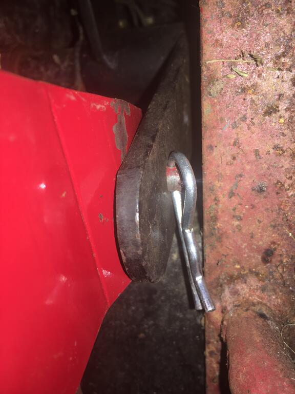

87buickt
I know it’s hard to see in the images but lift flag goes in the upper hole as well by when I do that it just tries to pull it out of the rod it gets slid into, and when in the lower hole I can’t raise it enough to lock it, of course I can’t see what it’s hitting either working as a one man team at the moment
