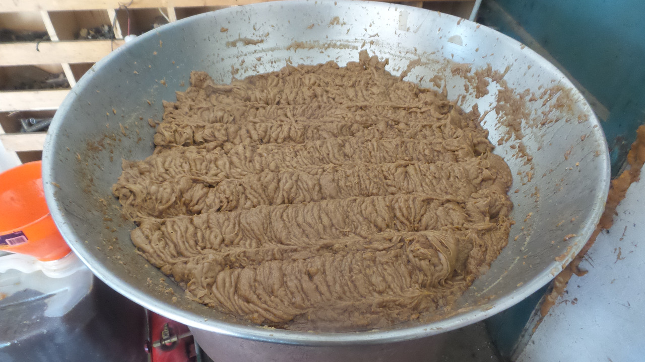

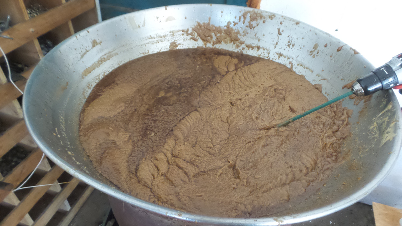

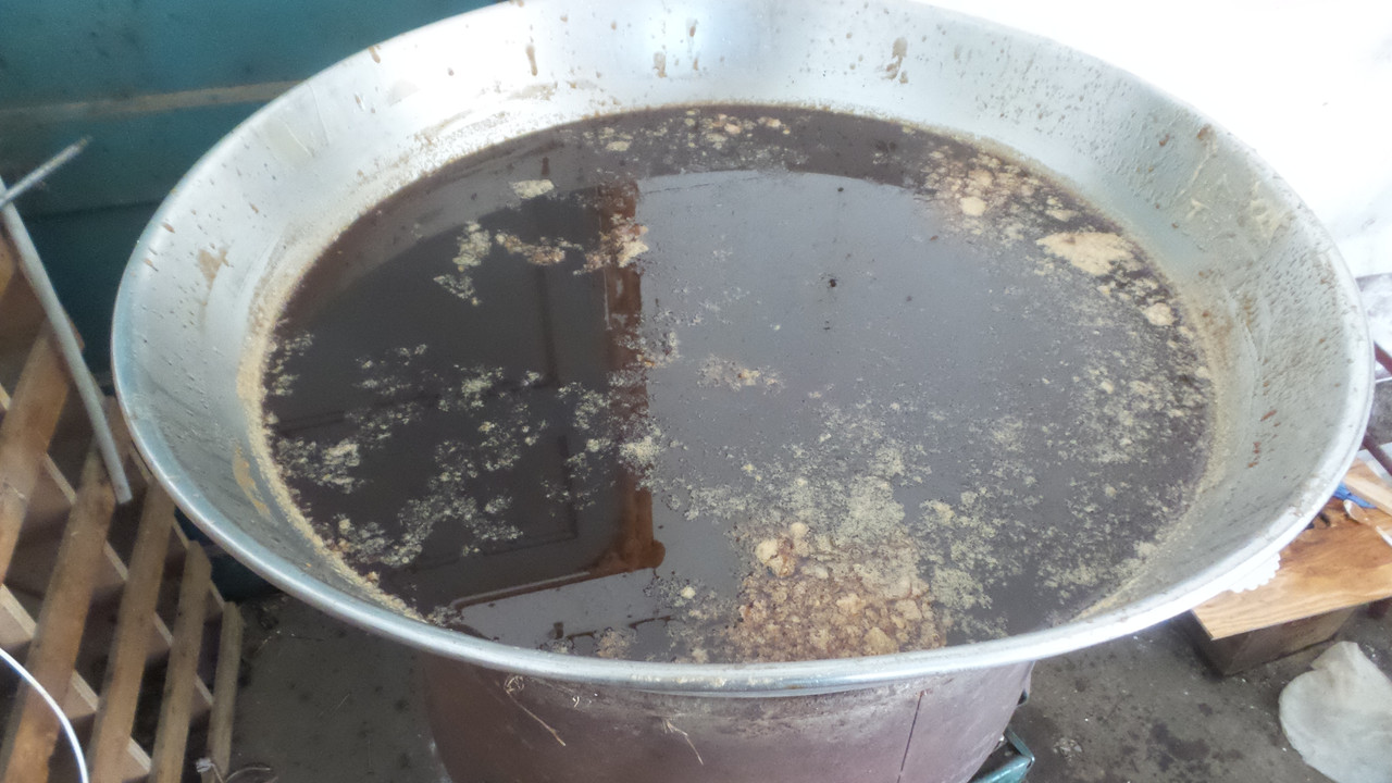

bc.gold 3,406 #1 Posted September 26, 2021 (edited) This is waste restaurant fryer oil being made into soap using the hot process which allows me to separate the glycerine from the actual soap. Apparently the more valuable glycerine maybe further refined by heating then passing it through a centrifuge. Once the glycerine is removed the soap takes on a much better color, the glycerine can be made into soap but has many other uses as well. The most difficult part of this project was finding a metal drum, the large stainless bowel was brought back from my B.C. trip, the old Coleman camp stove was a landfill score which is running on automotive gasoline - unleaded ethanol blend. This batch of soap is being made with sodium hydroxide aka lye, which make a harder bar, next batch I'll try potassium hydroxide recovered from wood ash for a softer bar or perhaps a liquid soap. Wood ash is covered with water, distilled water works best, let it soak overnight then evaporate the filtrate down, when an egg will float you know your concentration is right to proceed to your next step - make soap. Soap can be made using the cold or hot process, cold soap takes longer to cure two to three weeks while soap from the hot process is ready to use within a couple of days of curing..For my soap molds I'm cutting the plastic oil containers lengthwise giving me two halves. Edited September 26, 2021 by bc.gold 5 Share this post Link to post Share on other sites

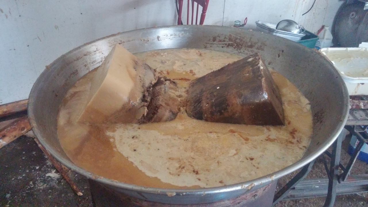

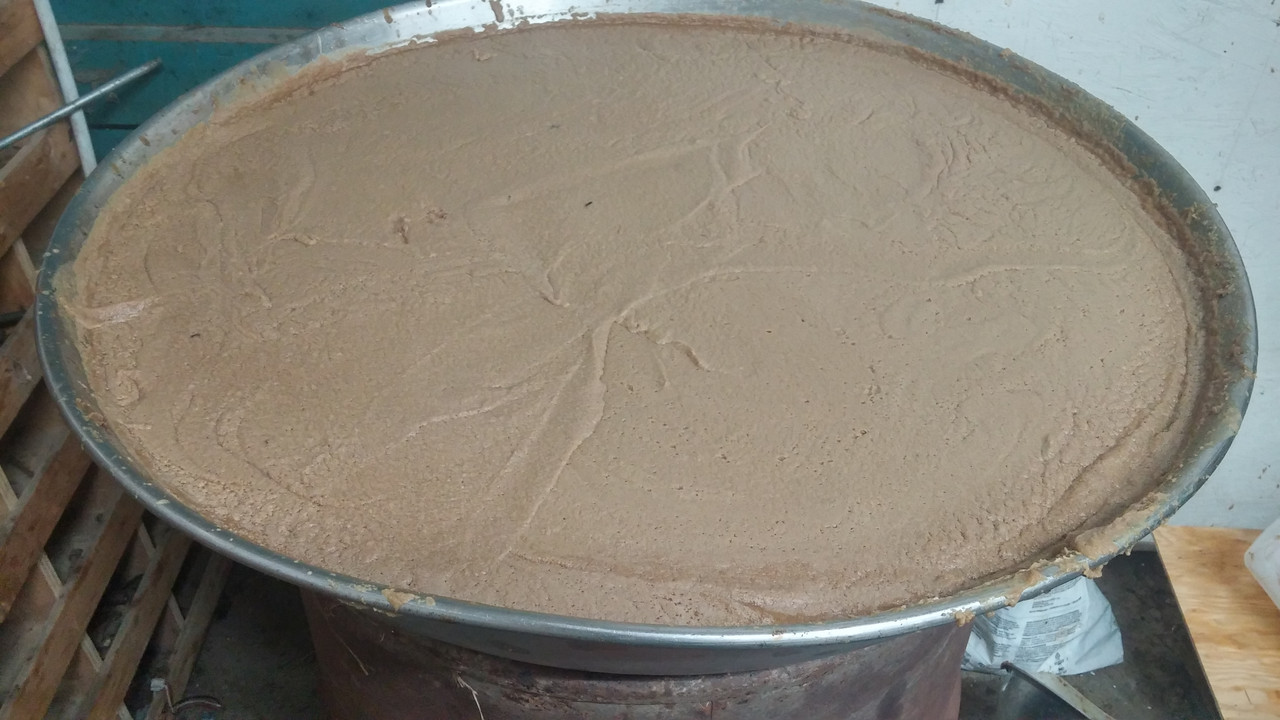

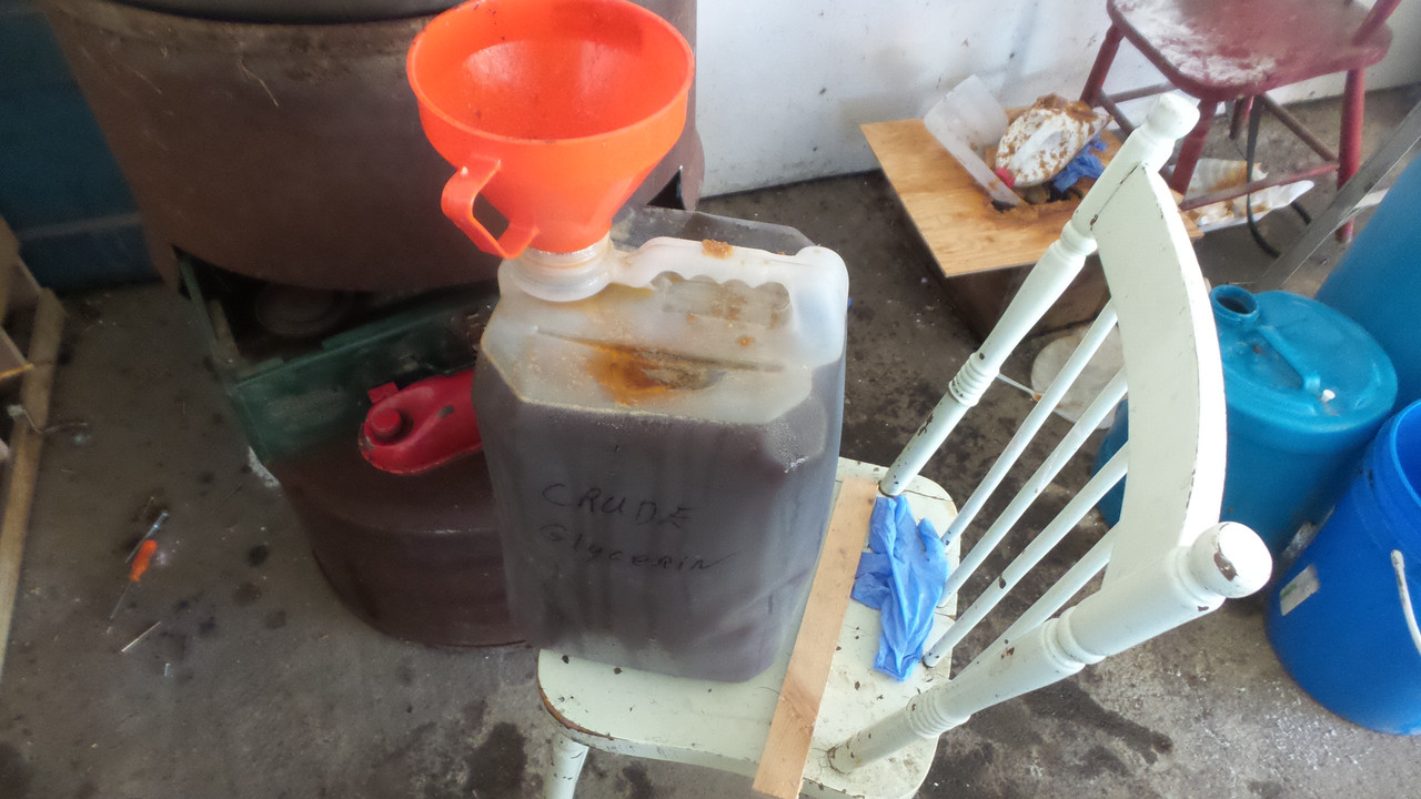

bc.gold 3,406 #2 Posted September 26, 2021 (edited) After cooling overnight then this morning I skimmed off the junk then decanted most of the glycerine what was left was milled into the soap which at this point looks like cheese curds after cold milling it now looks like Butterscotch pudding. The pudding was transferred into molds to cure. The crude glycerine to clarify gets heated then passed through a centrifuge producing 3,000g's of mechanically produced gravity, as the centrifuge project unfolds I'll post into this thread. Edited September 26, 2021 by bc.gold 4 Share this post Link to post Share on other sites

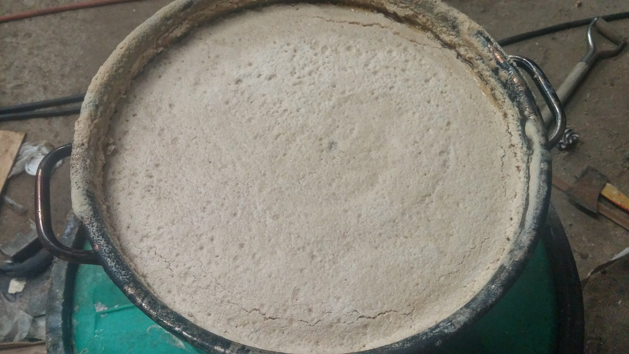

bc.gold 3,406 #3 Posted September 27, 2021 There's a process called salting, the purpose is to remove rancidity, glycerine along with excess lye. This is the same batch of soap from above after salting, I used pickling salt with about five gallons of water, the color has improved. Share this post Link to post Share on other sites

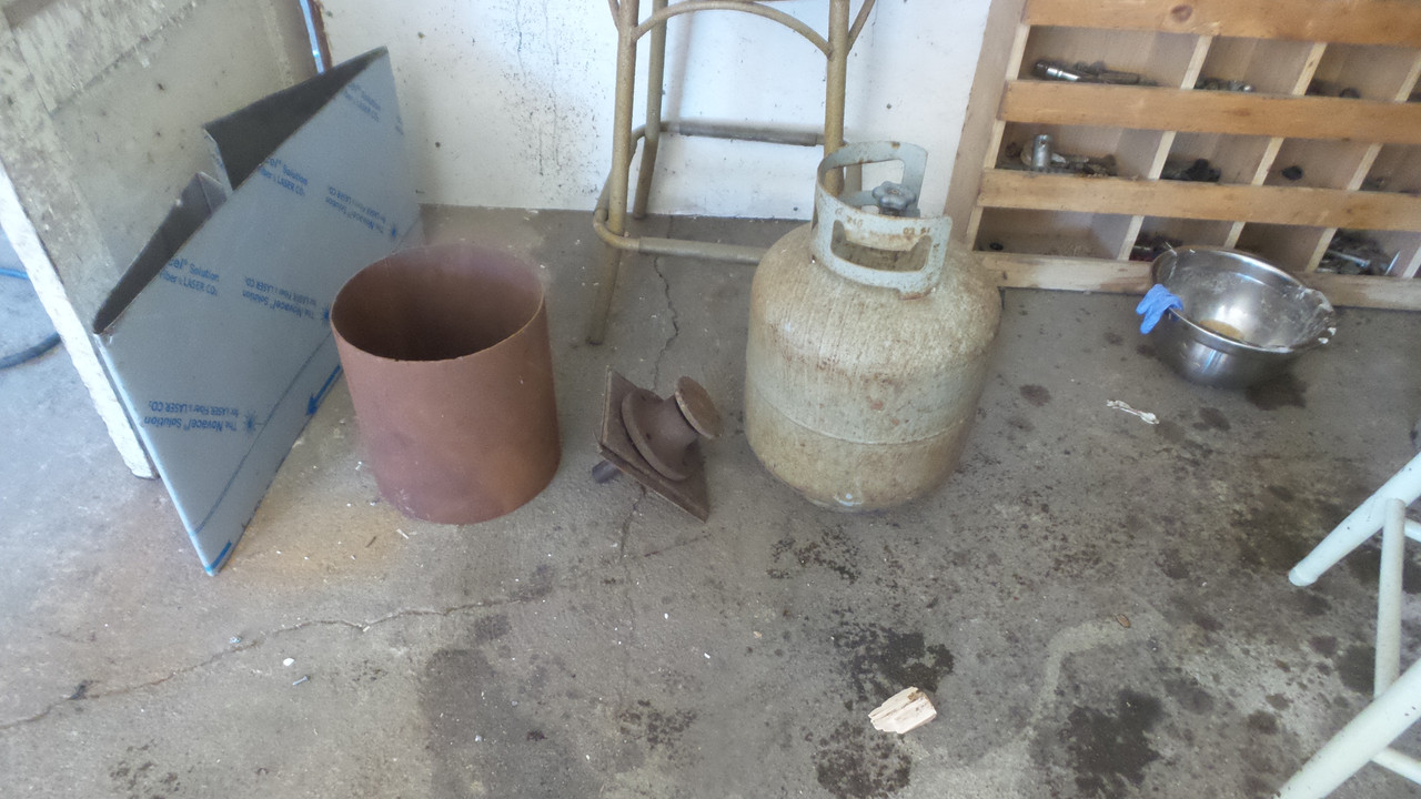

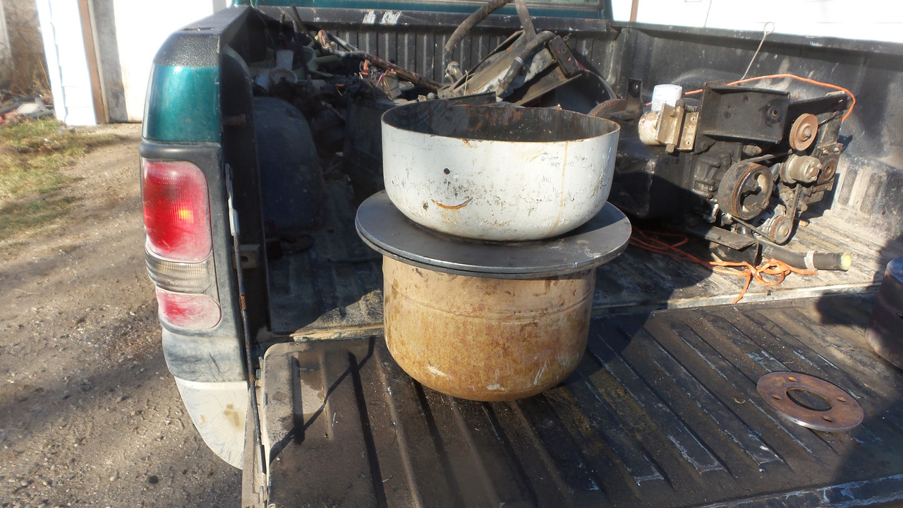

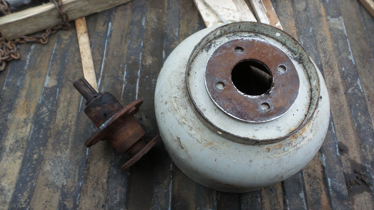

bc.gold 3,406 #4 Posted September 27, 2021 Some bits n pieces I've been saving for a centrifuge build, the pipe is abrasion resistant ( A R ) from a grain augur, the spindle from a large mower deck, the propane tank becomes the outer shell. Just need to have some rings laser cut then the welding begins. 1 Share this post Link to post Share on other sites

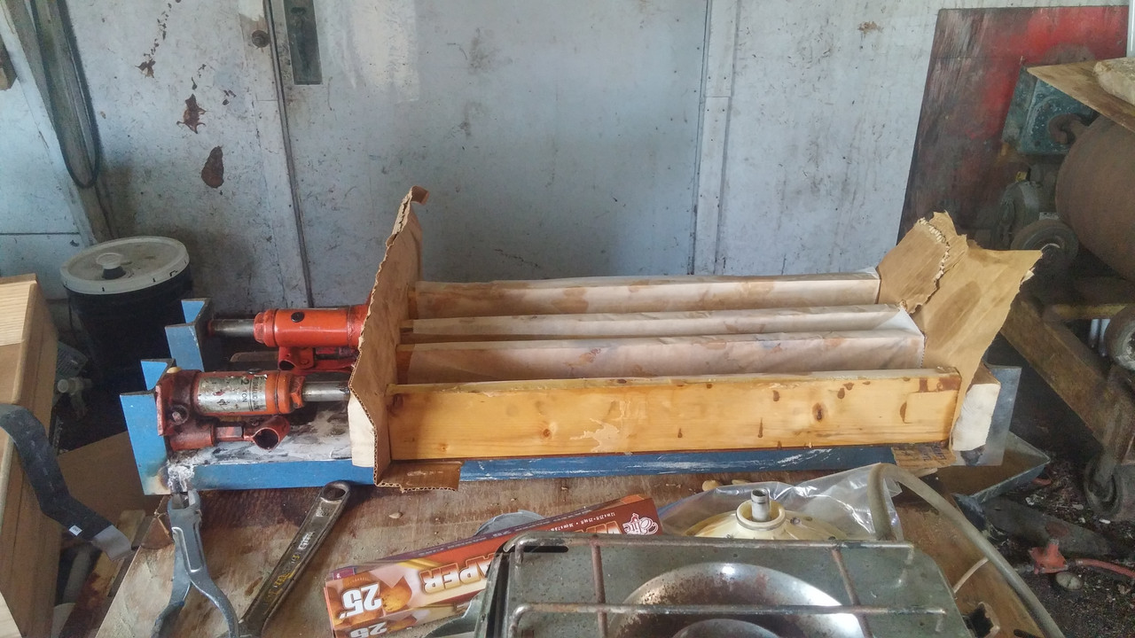

bc.gold 3,406 #7 Posted September 27, 2021 (edited) Soap mold lined with wax paper, use a bar of soap to smear the top edges then the folded over paper stays put. Edited September 27, 2021 by bc.gold Share this post Link to post Share on other sites

bc.gold 3,406 #16 Posted October 29, 2021 (edited) On 9/26/2021 at 9:45 PM, bc.gold said: Some bits n pieces I've been saving for a centrifuge build, the pipe is abrasion resistant ( A R ) from a grain augur, the spindle from a large mower deck, the propane tank becomes the outer shell. Just need to have some rings laser cut then the welding begins. Tank has been cut in half with a round hole in the bottom to accept the spindle, visited the machine shop today giving instructions for plasma cuts which should be ready towards the later part of the upcoming week. On the way home stopped in at the seed cleaning plant, I now have four five gallon pails of wheat to turn into ethanol used to make glycerine soap. Edited October 29, 2021 by bc.gold Share this post Link to post Share on other sites

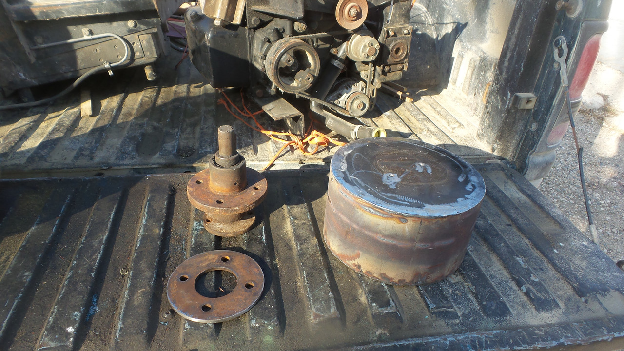

bc.gold 3,406 #17 Posted October 30, 2021 Did a bit more work on the centrifuge parts this afternoon. 3 Share this post Link to post Share on other sites

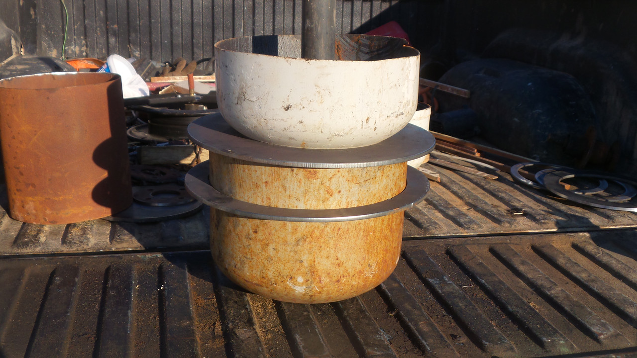

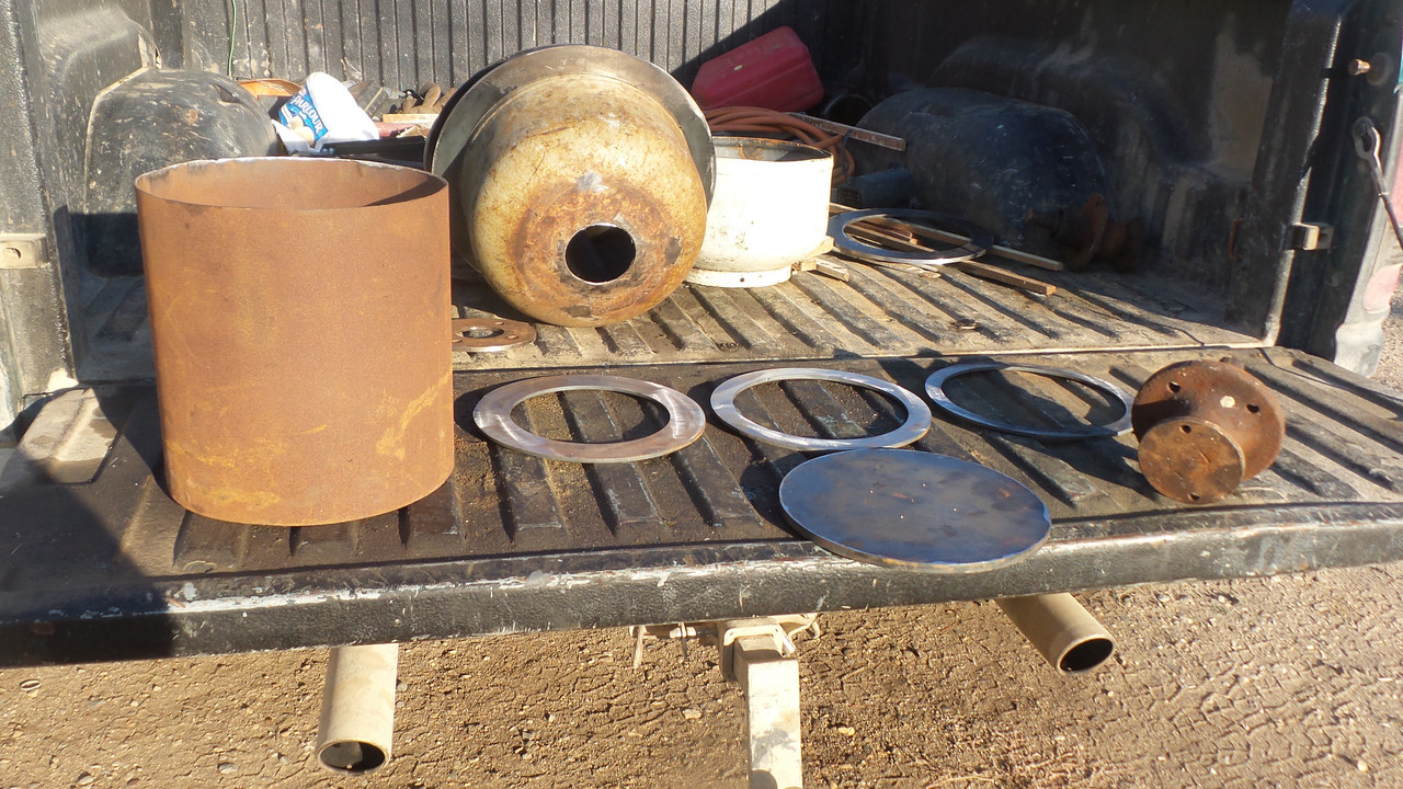

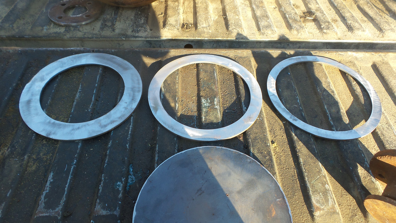

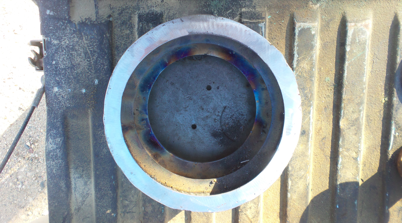

bc.gold 3,406 #18 Posted November 3, 2021 (edited) Parts were a day early. In the fist image a pair of large rings, the one with the same OD of the tank gets welded at the top, other ring gets welded to an inverted tank top which becomes a funnel. Center pipe shown in funnel is cut to reach within 1.5" from the bottom of the centrifuge bowel. Of the smaller rings the widest is welded 1.5" above the base plate which becomes the bottom of the bowel the next two rings are welded in at the same distance. Still have to notch the bottom rings on their OD, when placed for welding those notches will be 180 degrees apart, purpose of the slots these will make cleaning easier. When used to recover precious metals. Edited November 4, 2021 by bc.gold Share this post Link to post Share on other sites
