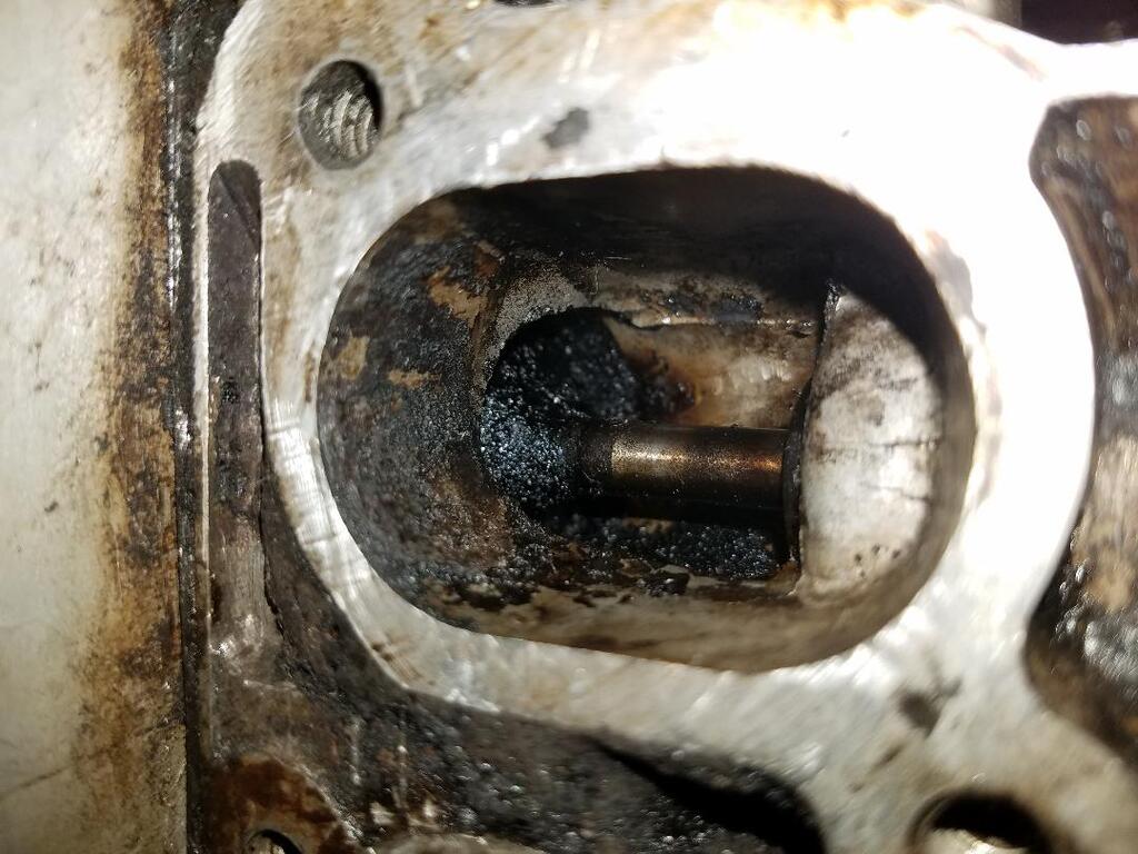

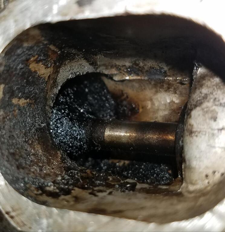

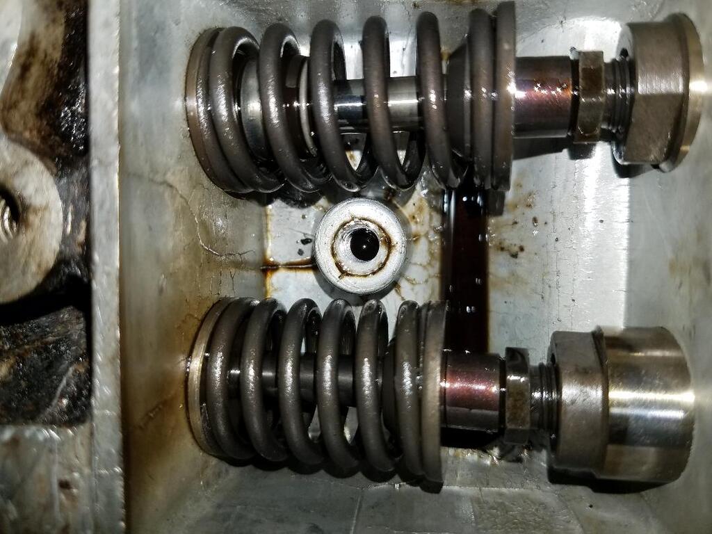

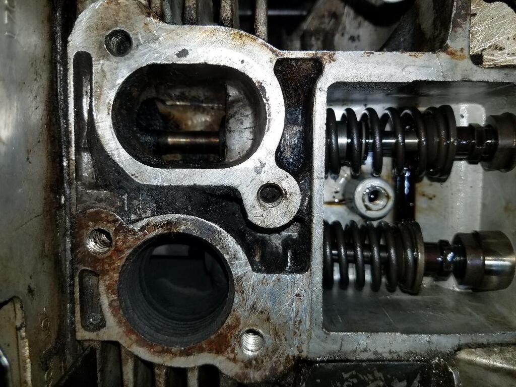

Brockport Bill 2,432 #1 Posted September 25, 2021 I am replacing carb, cleaning breather etc on 520 HC Onan P220G -- So....... I removed the exhaust, the old carb and manifold as well as valve box cover and breather --- see from the photos attached that looking into the valves, there is carbon build up under them. Is there such as thing, or a benefit, to cleaning the carbon off the underneath of valves without removing all the tin, the head, and the valves entirely? Can they, or should they, be cleaned in the position they are in? Thanks - this is new adventure for me!!! Any insights or tips are appreciated? 1 1 Share this post Link to post Share on other sites
WHX?? 57,466 #2 Posted September 25, 2021 Any idea of how many hours on it? I would suggest that as long as you got it this far pop the heads as there well may be some carbon build up in the combustion chamber as well. Then you can easily pull the valves and clean them up. Bonus check the valve seats and maybe lap them if required. 1 Share this post Link to post Share on other sites
Brockport Bill 2,432 #3 Posted September 25, 2021 627 hrs -- i am new owner -- it appeared it was used hard - and not well cared for --- I am aware that extra effort of removing head etc is optimum and would be big benefit --- that would be a huge adventure for me -- and beyond anything i have done previously - sorta hesitant !!!! Share this post Link to post Share on other sites
peter lena 9,951 #4 Posted September 25, 2021 @Brockport Bill dare i say it , do you use any fuel treatment in your fuel ? I add ounces of STA-BIL to ALL MY FUELS , ever heard of seafoam gas treatment ? my valves are clean and clear . before you tear it down , run a couple of tanks of treated fuel thru your engine , see what kind of a change that makes. pete 1 Share this post Link to post Share on other sites
lynnmor 8,914 #5 Posted September 25, 2021 Since that carbon is on the back of the intake valves it would be a good idea to replace the intake valve seals. That carbon will do little harm, and if you run the engine fast like recommended, the carbon may not increase. Since you don't want to do a complete job, just do a valve adjustment and hope for the best. You should have checked the compression first thing to get an idea of basic health the engine. 1 Share this post Link to post Share on other sites

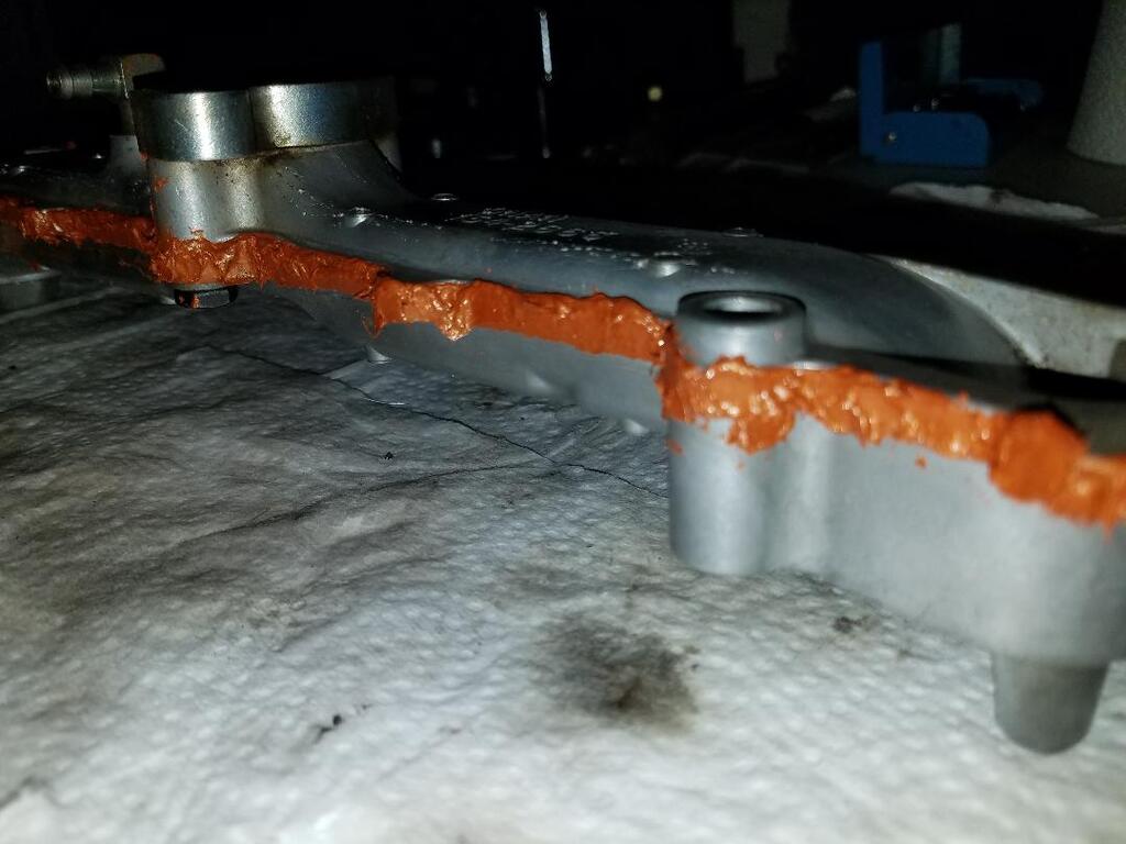

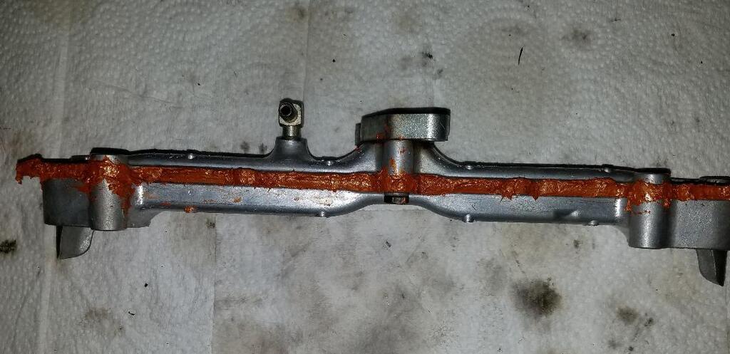

Brockport Bill 2,432 #11 Posted September 25, 2021 27 minutes ago, lynnmor said: Look for cuts on the edges where the heat shields touch the manifold. here are some photos of what i had already done to manifold in case it had any air leaks - please don't laugh at my art work - i did not care about the apperance -- actually, i saw this solution on You tube from guy who says he works on Onans alot - I read the pdf you provided but did not want to go to that extent and did not want to risk damaging the manifold and the potential risk of worse problem and $$$ ...........I did find one cut previously on the seam connecting top and bottom half of manifold and hope the sealant worked for that issue -- thanks for mentioning that. I used Permatex copper RTV silicone as the You Tube guy suggested. First i used razor to remove any old gasket that was protruding the seam... and cleaned the seam.... then i worked in the sealant with some light finger pressure. I left excess believing appearance does not matter? Any thoughts if this will be of value??????????? Feel free to giggle. Share this post Link to post Share on other sites
lynnmor 8,914 #12 Posted September 25, 2021 I would call your orange blossom special better than nothing, it is not a great fix. You should have tested for leaks first, the orange goo can now temporarily hide a fault. When you think about it, only a tiny amount serves a purpose and the remainder is Halloween decorations. 1 Share this post Link to post Share on other sites

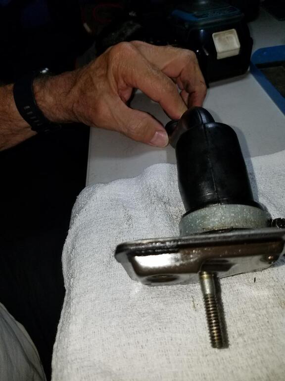

Brockport Bill 2,432 #23 Posted September 28, 2021 thanks - I was concerned the original "rubber like" seal between the manifold seams would be subject to gasoline damage if using gas for the liquid test? Just out of curiosity, why wouldn't water work for the leak test? I would have planned to blow out any remaining water moisture with my leaf blower or compressed air to be sure it was dried. To Don - yes, Lynnmor is correct -- there is a hose that goes from the manifold to the dash vacuum guage that has to be sealed to do the leak test. Share this post Link to post Share on other sites
Brockport Bill 2,432 #24 Posted September 28, 2021 that hose fitting is in the photo in my original message at beginning of the thread Share this post Link to post Share on other sites
Brockport Bill 2,432 #25 Posted September 28, 2021 heres photo of the vacuum hose fitting Share this post Link to post Share on other sites
